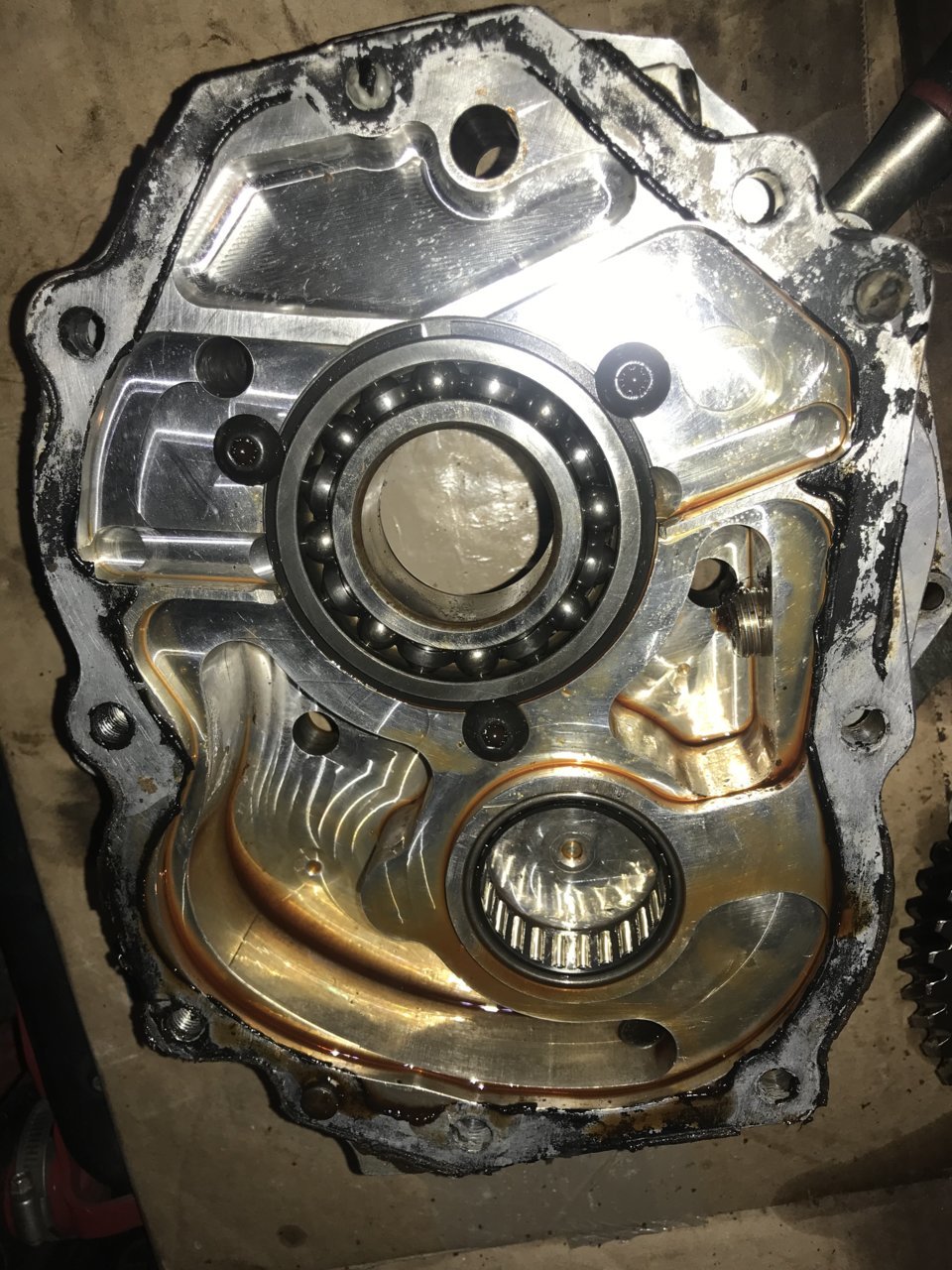

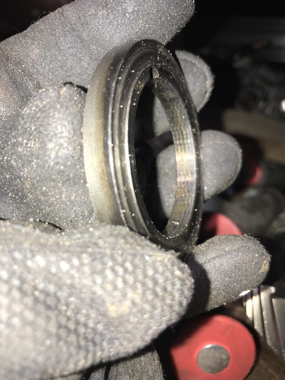

    105
    West Texas

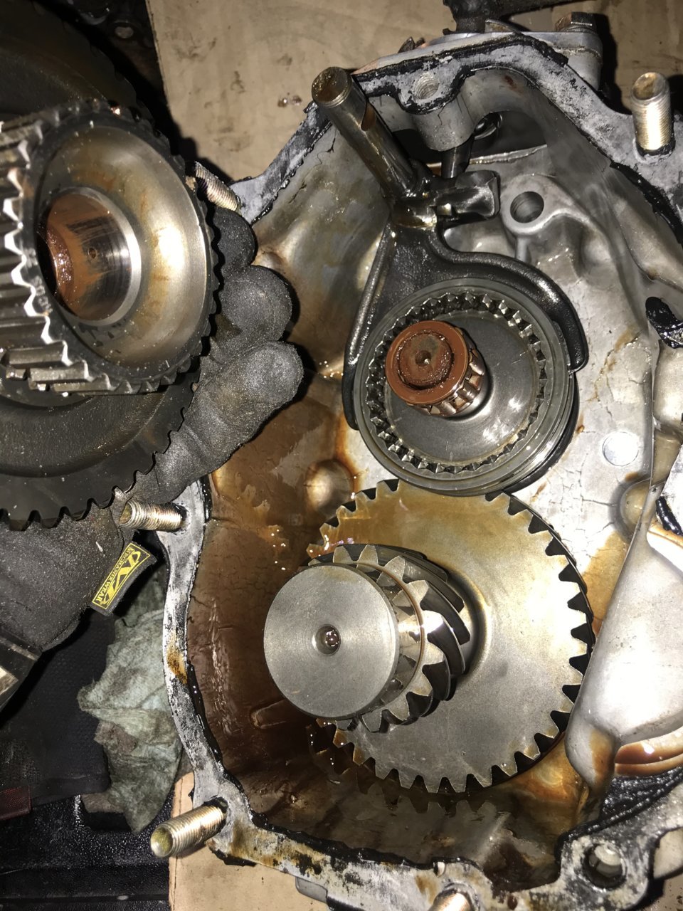

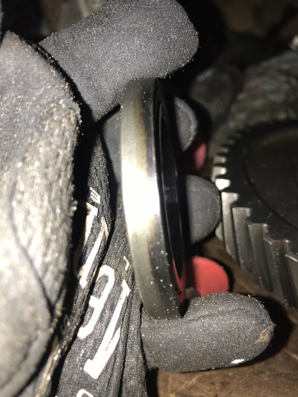

    I did rebuild the crawler box yesterday, bearings and needle bearings looked fine oil was a bit dirty, magnet had a little metal shavings from what used to be splines I presume. Only thing I did find was a “spacer ring” slightly burnt on one side which was a bitch to get off. Goes between the rear bearing and the large gear, over the rear coupler. Its locked to the coupler from spinning by a small ball. Could this be the culprit?

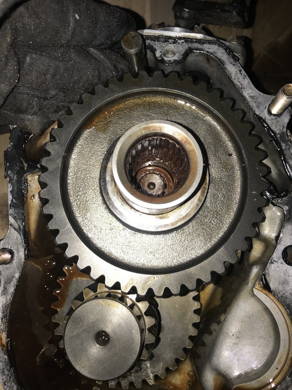

    2006 Tacoma TRD OR 4x4
    parts and stuff

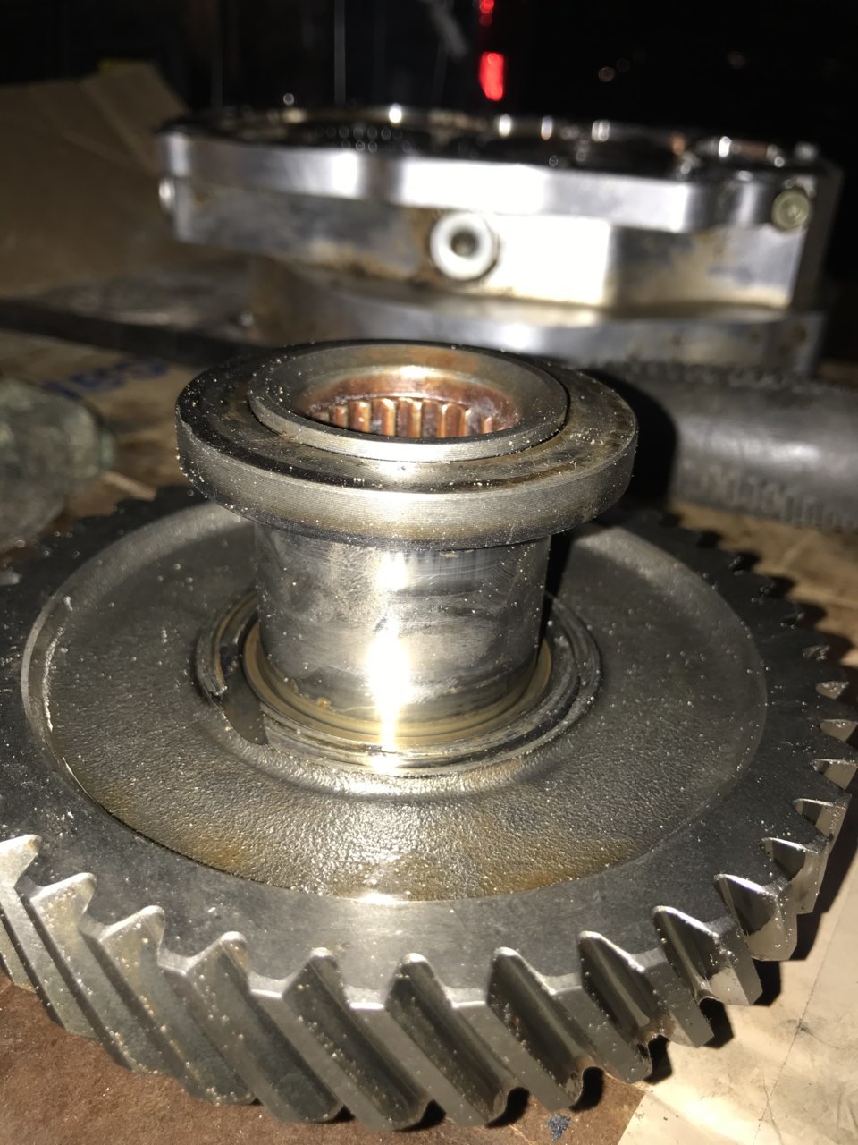

    Those spines look kinda shitty? how much oil do you put in the crawl box?

    105
    West Texas
    Which Spines? The coupler’s?
    I use half a bottle of Lucas Oil Stabilizer (recommended by RST), then fill it up with mobil 1 gear oil 75w-90 till the fill hole starts overflowing.
    parts and stuff

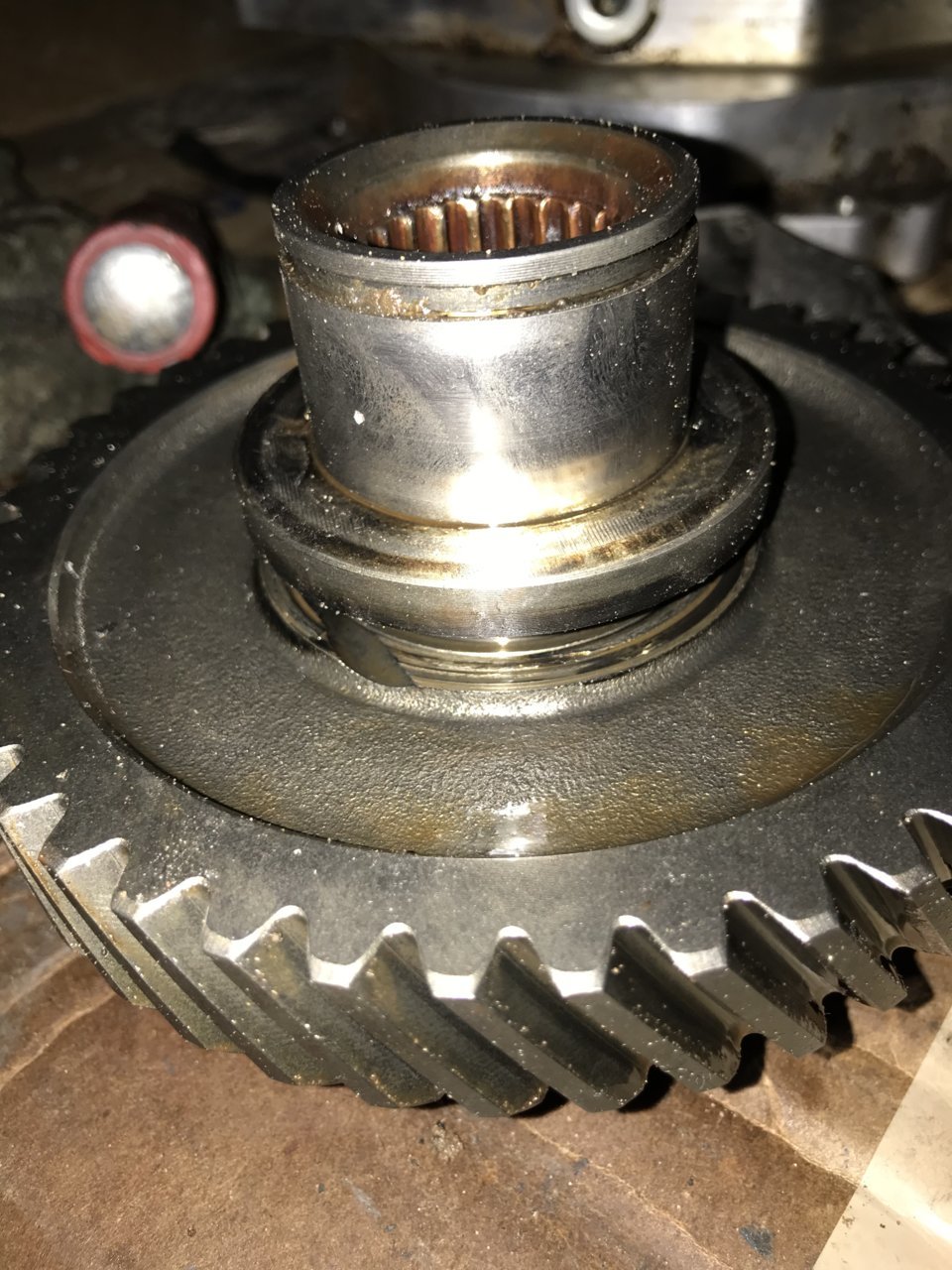

    yeah the female coupler in the pic i quoted.
    you might need some more oil. any time i filled up to fill line and went and drove it was low on oil. the oil moves into the cavity of the adapters between the crawl box and tcase.
    think i put around 1.5 qts if not almost 2 when i fill mine

    105
    West Texas
    Thats a good point, when I was looking at the crawler box the fill plug sits level with the bottom hole that communicates with that cavity you mentioned, maybe im not letting enough oil through that hole before I stop filling up.
    Bad side is I need 6 months to verify that theory lol.

    12,358
    Bishop CA
    So much for this being easy. If your rebuilding the crawlbox do you already have the new coupler?
  19. Nov 17, 2019 at 9:30 AM
    #79
    excorcist
    excorcist Well-Known Member
    Aug 25, 2016
    #195492
    2,517
    Reno, NV
    '06 dcsb, '86 pickup, '89 runner
    This definitely doesnt look right to me.... Is there a replacement for that part in the rebuild kit? If not I would forward that picture to Marlin and see if that is what its supposed to look like. To me it looks like that was grinded away when in use.

    105
    West Texas
    yes I have the coupler, bought an extra last time in case this happened. But being that ring I found burnt I might wait for a replacement.
    Already did, well the 2nd time this happened. Marlin is aware they just said to replace it. But didn’t say what caused the wear, could this be the reason I keep thrashing out couplers.
