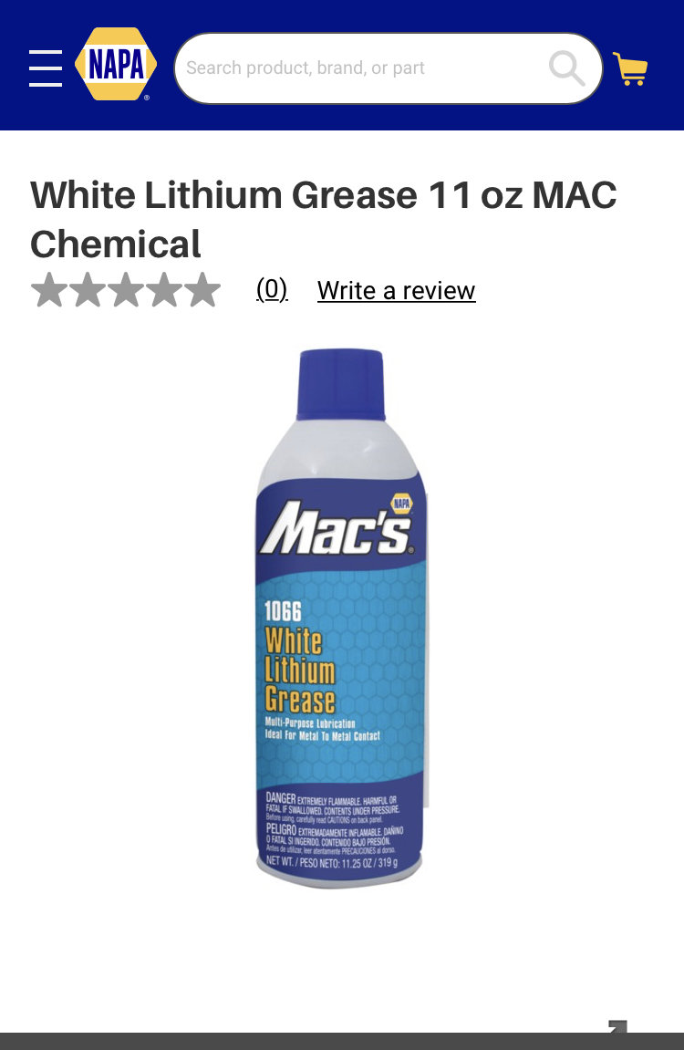

    Thoughts on Mac Chemical White lithium grease? How important or how much difference will there be with Teflon added?

    Use high temperature disc brake grease on all the pivot points and it will take care of the old barn door creaking noise.
