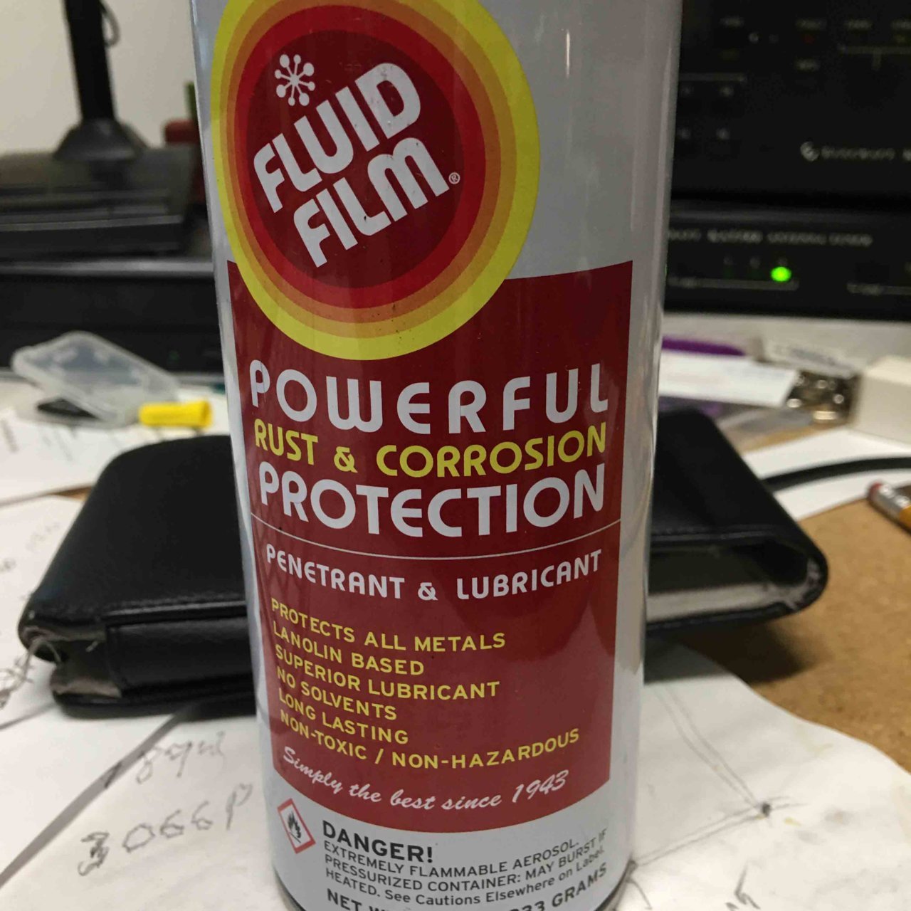

    I use Fluid Film (rust & corrosion) penetrant $ Lub. Off road 50% of the time and only need to spray around once a year. The ride was acutely better after I used it, and that say a lot on an old HJ

    I've never had squeaky leaf springs. But every fall I lift the frame to sag the springs and coat them with this.

    You can left the cab (jake from the bumper first tim) a little and just spay it penetrates by it self really easy
    After the first time just spray it on every year. Spray both sides of the spring no need to raise after the first time
    I'm it water this time of year (stream crossing 12/18") with no sings of lose
    I spray it on places where my undercoat peals off and have had no rust appear in the last 4 years
