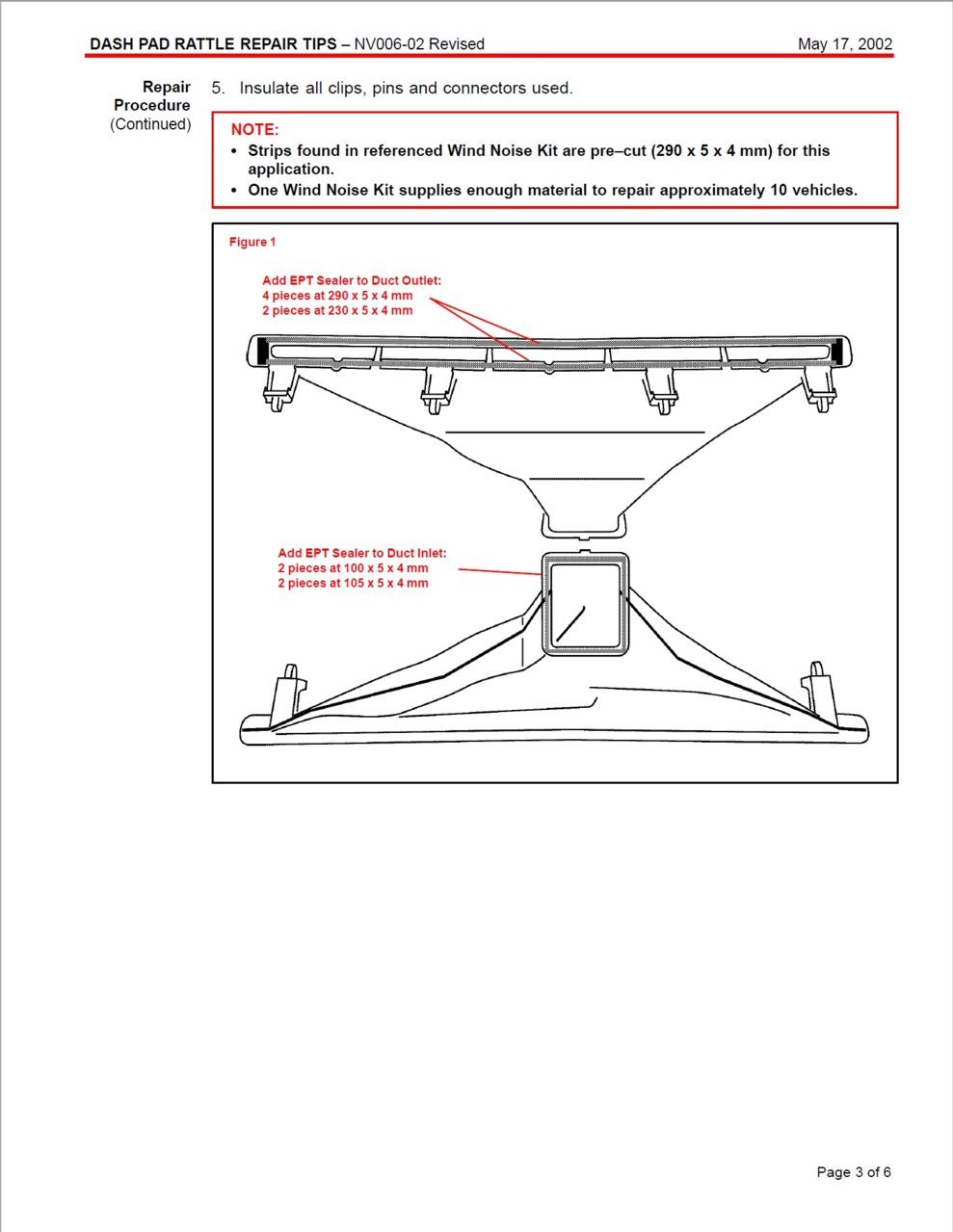

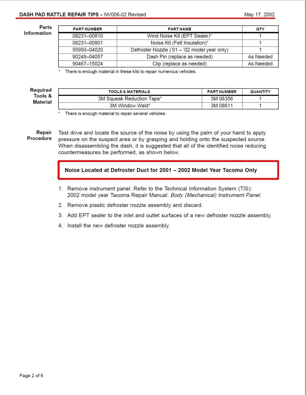

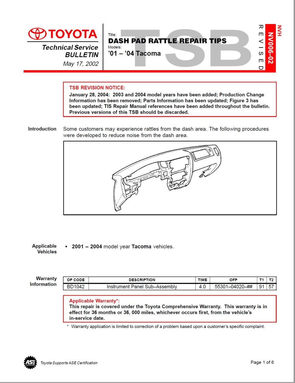

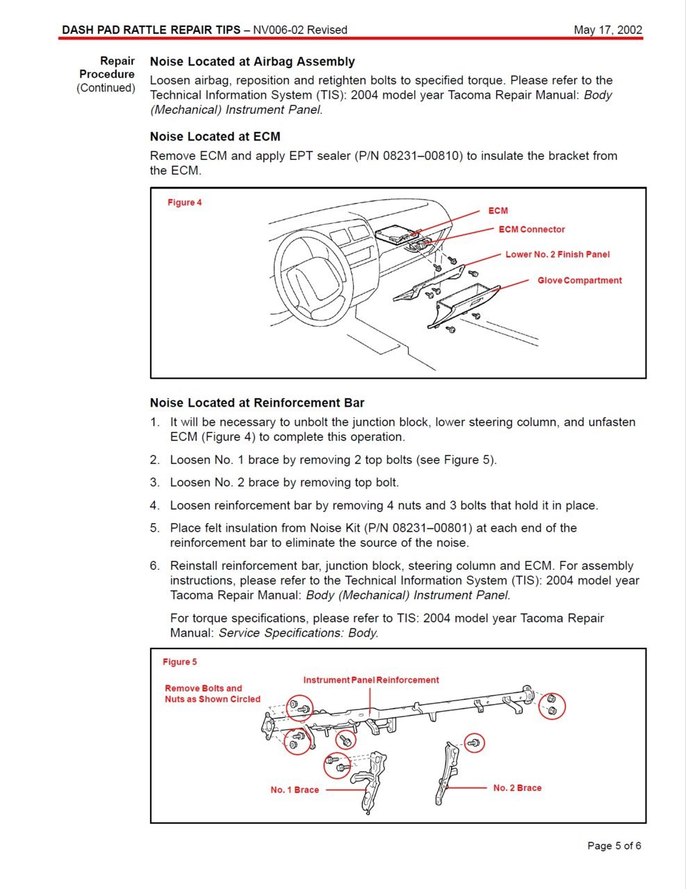

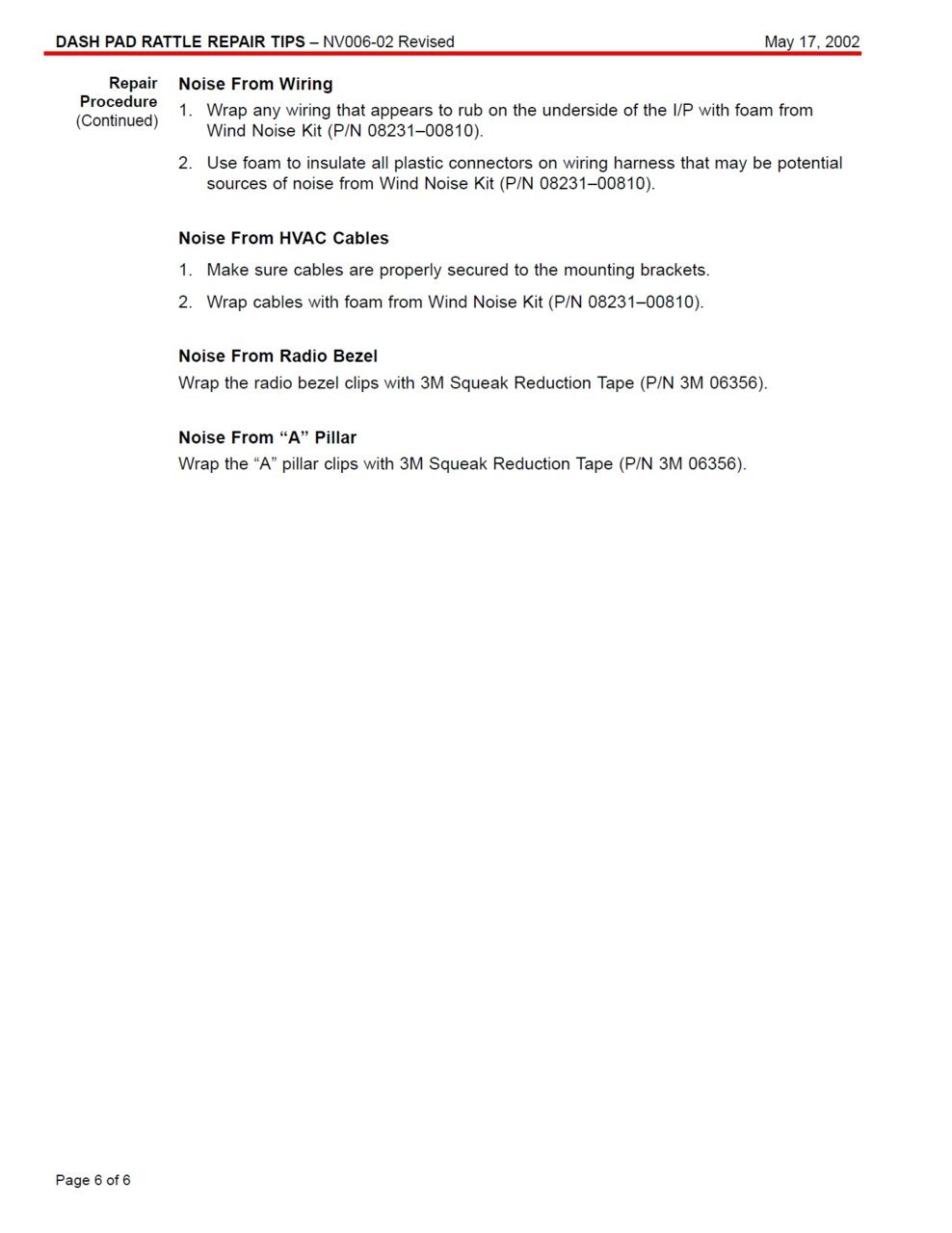

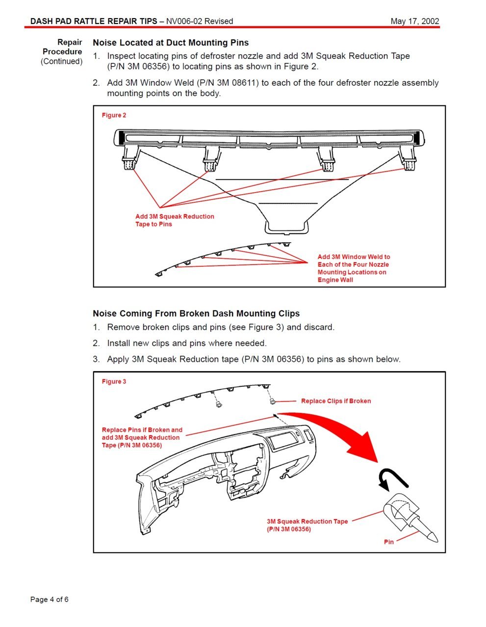

    Looks like the file name on the TSB is 0104-NV00602r-DashRattle.pdf. I used duckduckgo and found this:
    https://vdocuments.site/0104-nv00602r-dashrattle.html
    Here are the pages as images:
