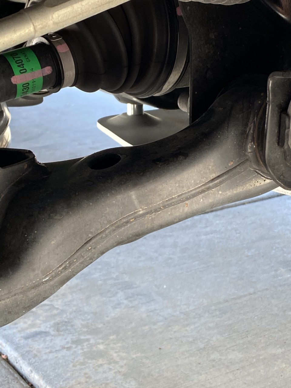

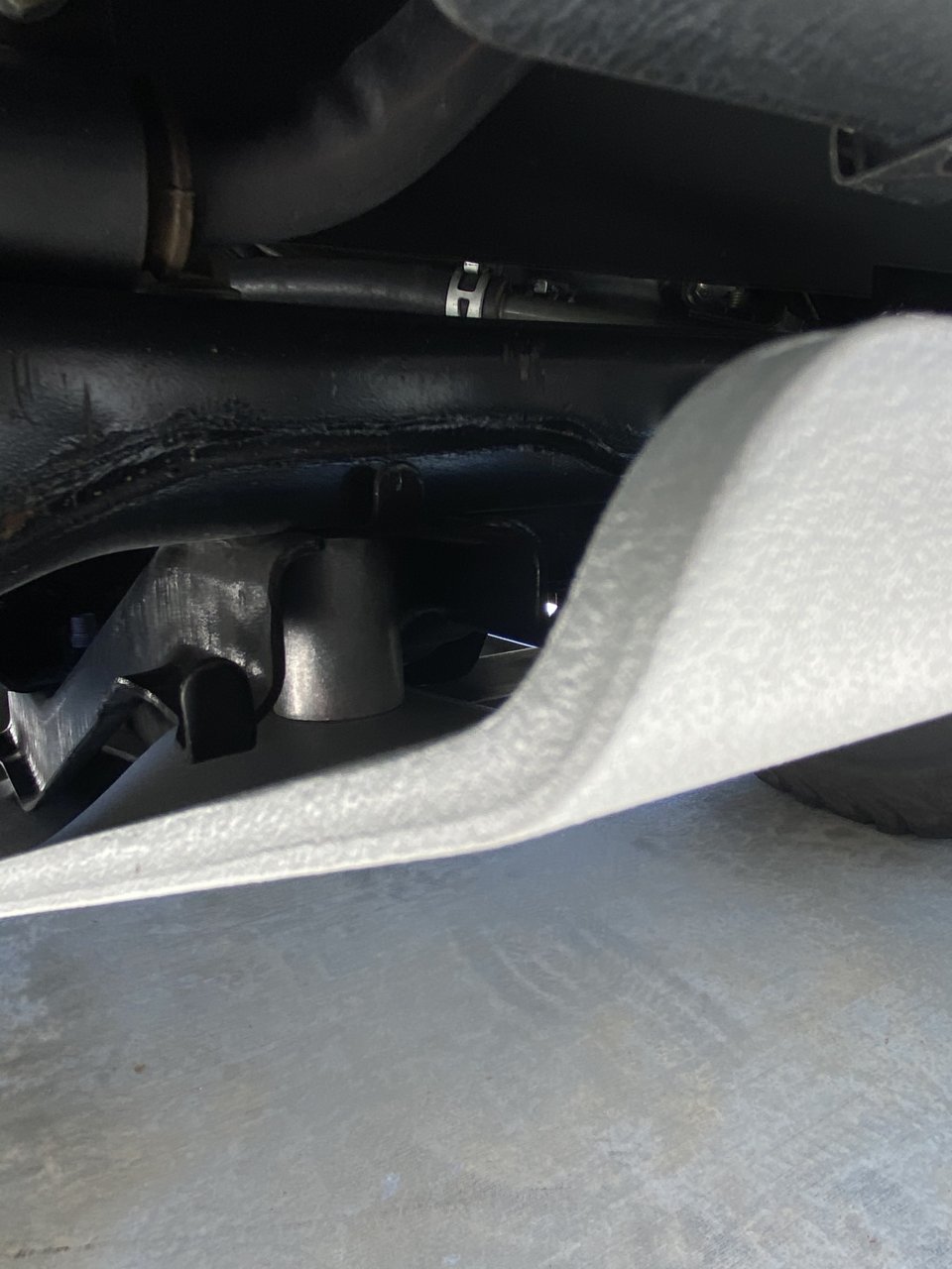

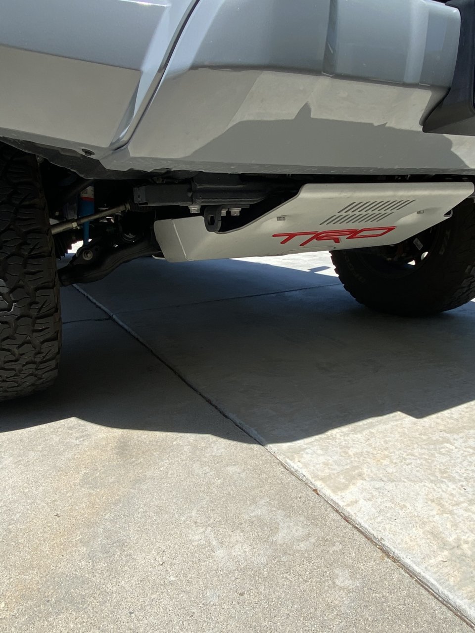

    Apparently they said that my TRD skid plate along with my leveling kit was causing noise . So they added spacers on my skid plate. Kinda weird since this is an OEM part. Yet- I did drive my truck around block and no longer hear noise . So must be fixed .

    Can you post an image of these spacers? The factory TRD skid is not normally the cause of any sounds as it doesn't contact any moving parts.

    I have heard of the skid plate interface with a level installed. Slight bend or cut takes care of it. Or, apparently, spacers.

    Yeah man it’s weird bro. I would have never guessed ! This is a factory part . And everything lines up. Below are pics , it doesn’t look as bad and still pretty tucked up. I find it hard to believe this was result of noise but it was! I don’t hear anything now. And now that I think about it, never heard this before I had skid plate . Guess problem solved , and a heads up to anyone who buys TRD skid plate and has leveling kit.

    I find hard to believe , see pics bro. Apparently, this corrected my noise .

    I wana say 1 inch . I’m gonna get under truck later today or see what paperwork says from 4 wheel parts . Crazy I thought I was only one experiencing this! Tech told me skid plate was rubbing in front dif when suspension was compressed .... ? . Toyota needs to look into this .... haha
