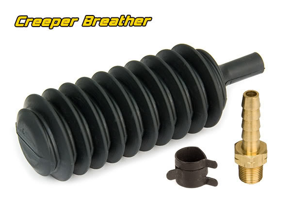

    I relocated mine up by the fuel door for less than $10, so $19 for that......

    That looks like it may be a good answer for the transfer case and transmission. Might try to get that little boot deal.

    If you do the fuel line, remember to include a good length of service loop so that the suspension can travel without the line being taught.
    Like maybe 10 inch coil or slack.
    I'd add the clear in-line fuel filter, just to see if any dirt/dust gets trapped. They're like $2 and to me, seem to truly allow it to breath freely.

    For anyone interested here is an AWESOME link off the link that silverback sent me: It describes the fuel line diff breather mod in detail.

    Ok I just went and bought the creeper breather I'll upload pics when I install later today
