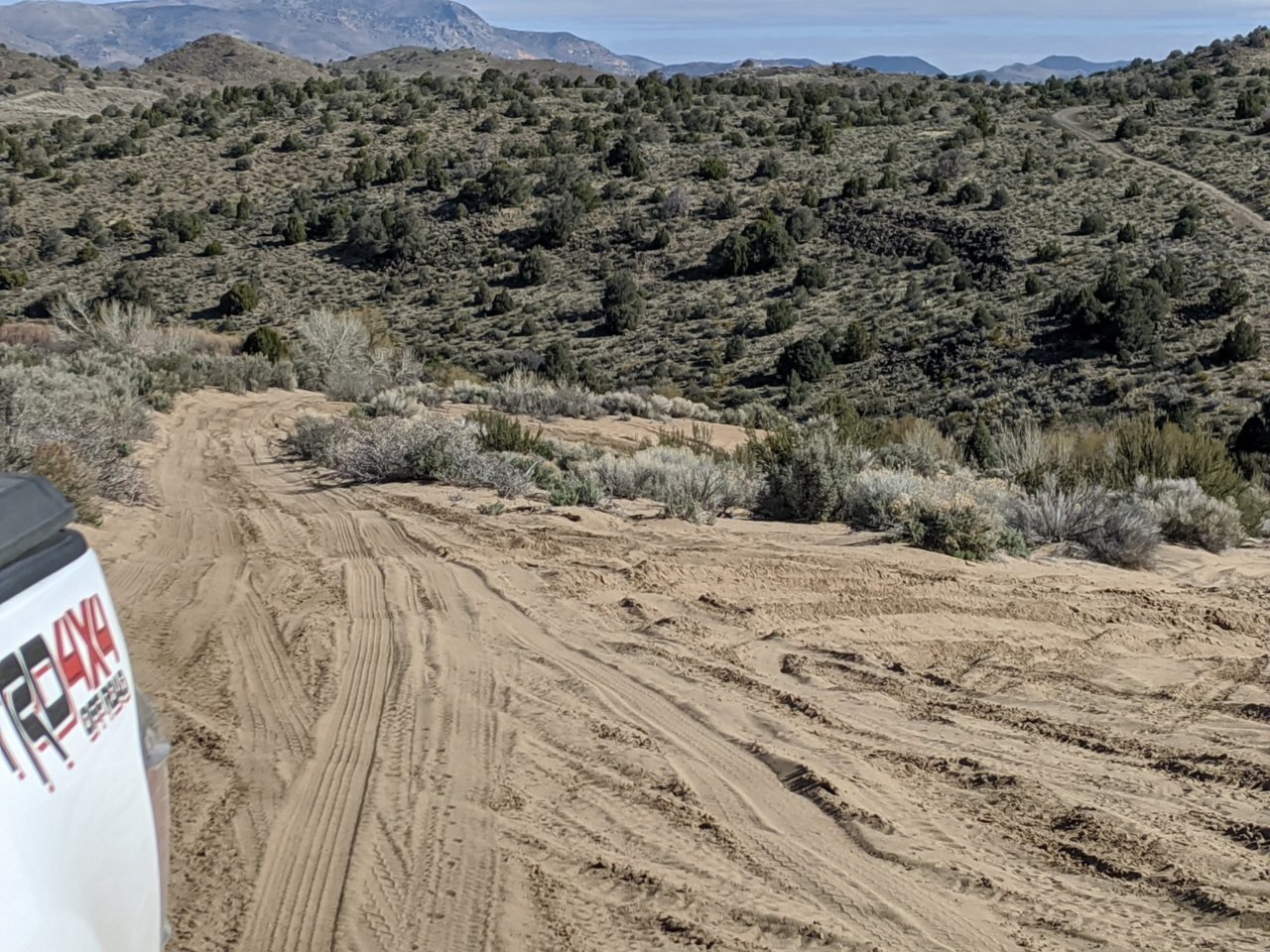

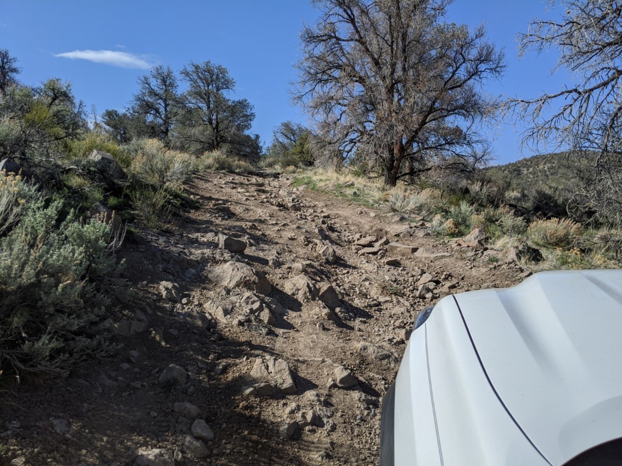

    To put things in perspective (and at the risk to get told to go trade in for a Subaru :eek:) I am attaching a few photos of some terrain that I am usually goofing off in. Nothing slider-worthy here; that's another area.
    First 2 are the kind of trail that I'd want to have stiffer suspension for. The bumps on the sandy part are a bit deeper and more abundant than the picture shows. You get the idea.
    The rocky section - well, the truck just feels more wobbly going over it than I think it should. Maybe I am wrong.

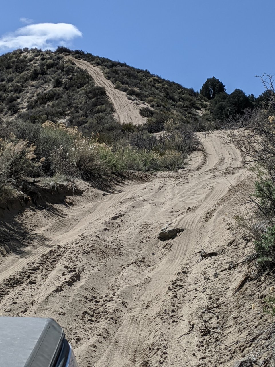

    This descent is the kind of thing that makes me feel that the stock tires are ok for now. That section into the dip is rather steep (by my standards) and I didn't slip or slide.
    So with this added - any changes for the shock recommendation?

    This actually makes me think even more that you should start with tires. The stockers may have gotten you through fine but better rubber will be the best bang for your buck upgrade you can make. The stockers may have provided the traction so far but they are lack the strength and durability of many other options. Also some of what you are chocking up as soft suspension could also be the compliant sidewalls from your tires. A load C or higher will firm up your ride while you decide what you really need your suspension to do.
    I started with 265/75/16 before my lift and haven’t gone any taller even with about 2.25” lift. So think of the tires as a pre lift upgrade that won’t need changed later.

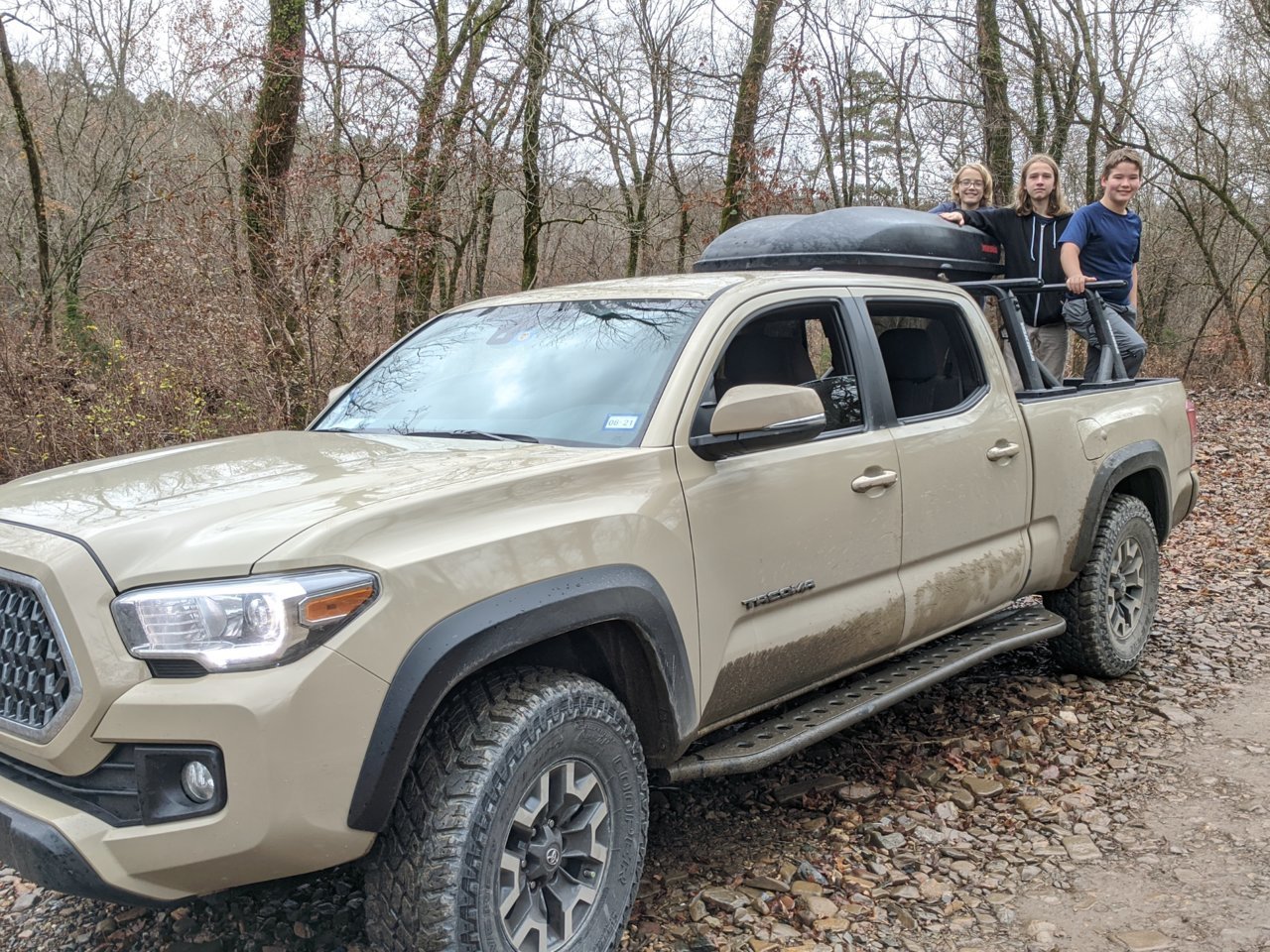

    IMG_20191126_110801.jpg Here is my take - first, do tires and sliders. Looking at your pictures, I would start with tires. Add sliders as insurance on your nice truck. My future plans involve a low profile bumper and winch so I will evaluate my suspension needs after that point.
    Here is what I did, for what it's worth:
    For tires: 255/85R16 Cooper Discoverer ST/Maxx. Gives a bit of a lift at nearly 33" and works without a lift on the stock tires. Here is a massive thread about 255\85R16 on a stock truck: https://www.tacomaworld.com/threads/put-255-85-16s-on-stock-or-wheels-and-suspension.491079/
    Once I had the caster pushed forward just a tad, I can't get them to rub lock to lock and flexed (note that I don't have mud-flaps). So far very happy with the performance. They are about the most aggressive "all-terrain" but are fairly quiet, smooth, and reportedly have great tread life. They also fit in the stock spare location - some move the hanger back but others report no issues without moving it.
    Possible downsides: They are an E-rated tire so they are heavy and stiff. The stiffness goes away by running the just under 35 lbs of pressure, the weight dropped my mileage by 1-2 miles per gallon.
    For sliders: I went with bolt on since it was a new truck and by daily driver. I got zero degree sliders with fill plates - works well as steps for my daily driver, nice for blocking crap thrown up on gravel forest roads, and strong enough to function as sliders (mine are Caliraised - local pickup and no shipping was a big deciding factor).

    I've done trails similar to that with stock tires and suspension and it was fine. Actually pretty impressed what a stock OR can do. Unless you're bombing through those bumpy spots and heating up your shocks, you should just focus on tires if you find yourself without enough grip on the hill climbs. Airing down helps immensely too.

    Dude with that terrain, in the desert Miles away from who knows what, coming up on summer.
    Do yourself a favor AND GET BETTER TIRES.
    Also a tire patch kit, some tire sealent if that doesn't work, valve cores ( literally picked up 4 for $1.29) and a way to pump your tires back up. Last thing you need is to be messing around in the wild alone and get a gash in your standard load tire, not able to patch it, then turn around and see another flat tire after messing around with your spare.

    Great looking truck, Osteology! I wish I could have had that color, but manual transmission won out.
