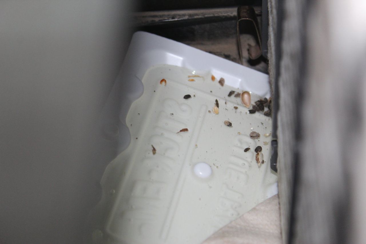

    it all started with this...

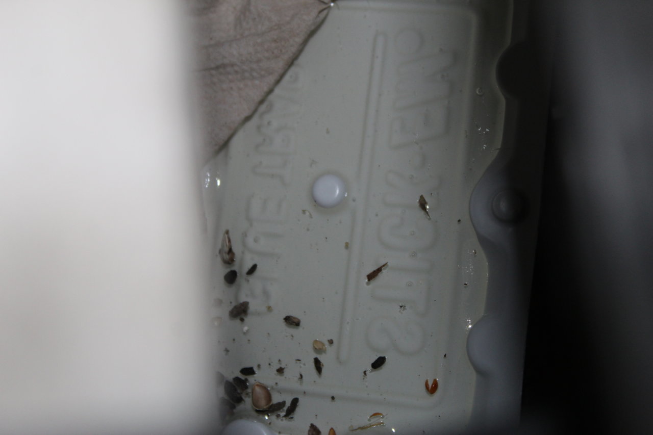

    while cleaning out the air cleaner box recently i noticed some seeds and shells and stuff
    so i form fitted this glue trap to see if i could catch whatever was making this mess
    I waited five days... it was so hot out

    I had that problem with both the airbox & the a/c fan wheel. Mice were doing the dirty deed of trying to move in & make a home. I put a wire mesh in the entrance to the air box & the fenderwell. The fresh air inlet is in the fenderwell. so you have to open it up & seal that intake hole with the same wire mesh to stop the mice.
    They ate my air filter first & the then built a nest in the center of the fan. The mesh stopped the problems.
