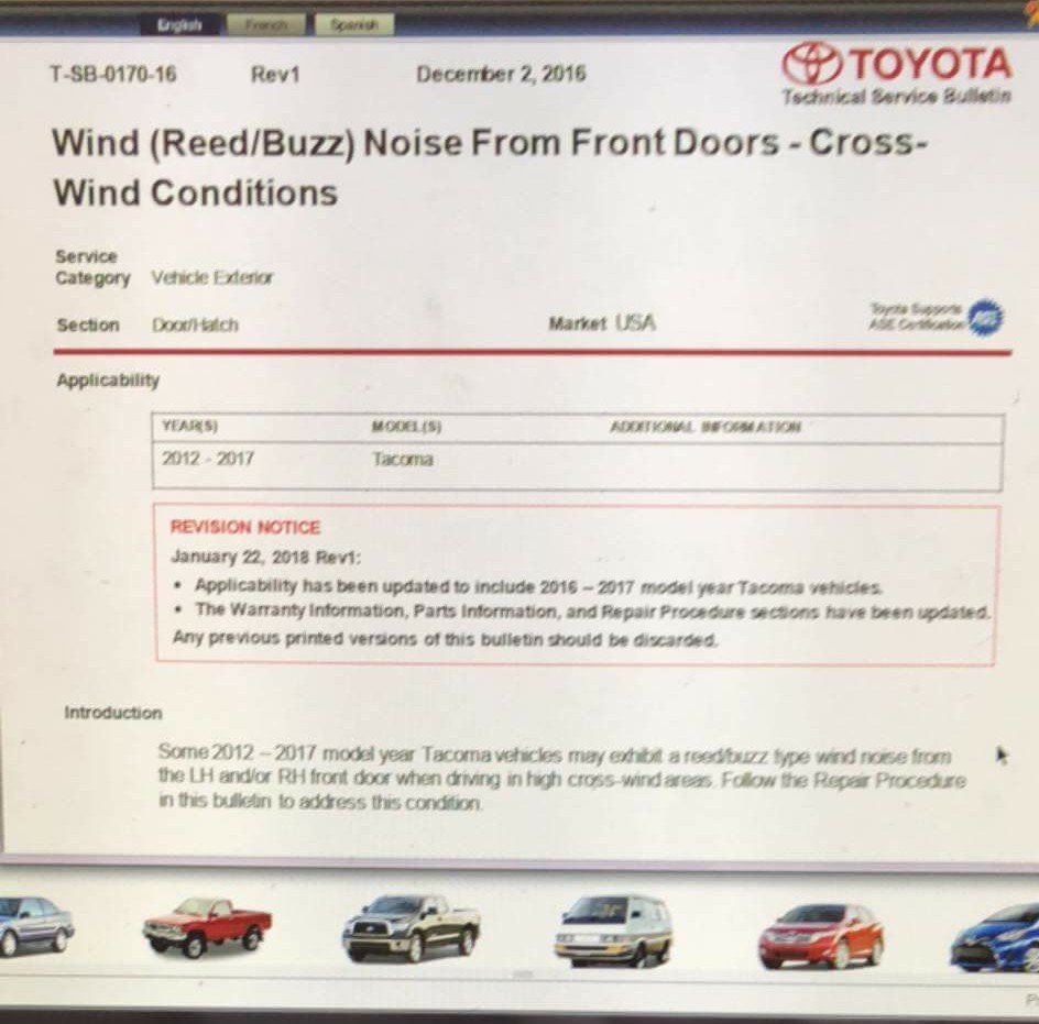

    The old TSB for the second gen has now been updated to include 2016 and 2017 Tacomas.
    Does anyone have any more info?
    I searched and didn't find this on here, yet

    I have 39000 and this TSB was updated today... Will they cover it?

    That's what they did to my truck under warranty. they replaced all the weather strips seals around the drivers door. I am not sure if they replaced it in the passenger door.

    I didnt have to replicate it for them - I just printed out the TSB and showed it to them.
    They took ordered the strips and took care of it

    I have service coming up soon. Going to ask them about this as well. It will be interesting to see what they think when they see my silicone bead along the weather strip I did to fix this myself...

    They put new weather stripping on mine still have vthe problem. I believe they also adjusted the door to make it close tighter. Still have the problem. Mine vibrates and and makes a rubbing sound every single damn bump I'm going to try and put some silicone on the strip to get rid of it.

    Replaced mine numerous times with no fix.
    I bought some AVS in channel visors that i feel will tighten things up enough to kill the noise. :fingerscrossed:

    I called my service manager while I was on the HWY and he's like HOLY is that the noise??
    New seal is on the way, of course that was the second seal out of 4

    Had this issue on my 2nd gen, well documented over there. Came up with a dripper line fix and havnt had the issue since.
    FYI toyota copied my fix and integrated it into their new door seals.
    Spend tons of time at the dealer or spend 5 min and 2 bucks on some 1/4in dripper pipe and call it good.
