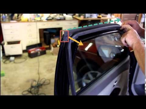

    TacoMan408
    TacoMan408 Well-Known Member
    Jan 30, 2016
    #176551
    344
    CA
    2016 TRD Sport Manual
    OVTune (04B13+1.05 87 FOB), Morimoto XB Headlights, Toyota LED Fog Lights, Toyota TRD Lift Struts, Wheelers Progressive AAL, TRD Pro Tail Lights, 17" TRD Pro SEMA wheels, BFG 285/70R17, TRD Skid Plate, Bakflip MX4, OEM Audio +, Anytime Front Camera, G-Tek Fab Door Sill Protectors, WeatherTech Floormats Suntek Carbon 35% Tint
    I will take a pic when I get a chance. Here is a generic pic to help explain what I did.
    At the top corner of the door seal (red box), pull the weather stripping away slightly, toward the inside of the cab (yellow arrow) so there is a small gap to run the drip-line (irrigation tube, etc.). In the gap between the weather stripping and the door, simply run the drip-tubing until the end meets the A-pillar (green arrow). Cut off the excess and repeat one more time to get 2 drip-lines between the weather stripping and the door. Push the top top corner of the door seal back. I didn't need to use any new adhesive at all.
    Drip line is just small irrigation tubbing. There are no additional holes in the tube. This is exactly what I bought:
    https://www.amazon.com/dp/B0091D31IA?ie=UTF8&psc=1&sa-no-redirect=1
  7. May 9, 2018 at 4:15 PM
    #107
    over60
    over60 Over70 & still a "Grumpy Old Guy"
    Oct 20, 2010
    #44995
    4,791
    John
    Muskoka, Ontario
    2016 Inferno (Punkin) TRD 4X4 Sport DCLB w/upgrade & tech pkg..!!
    Toyota running boards/Solid Fold 2.0/custom stickers/Anti-Dark LED light under hood/Derped grill/Scoop, etc.
    Ok, I get it now.... DUH..!
    Thanx for the info...!! I'm gonna try that.

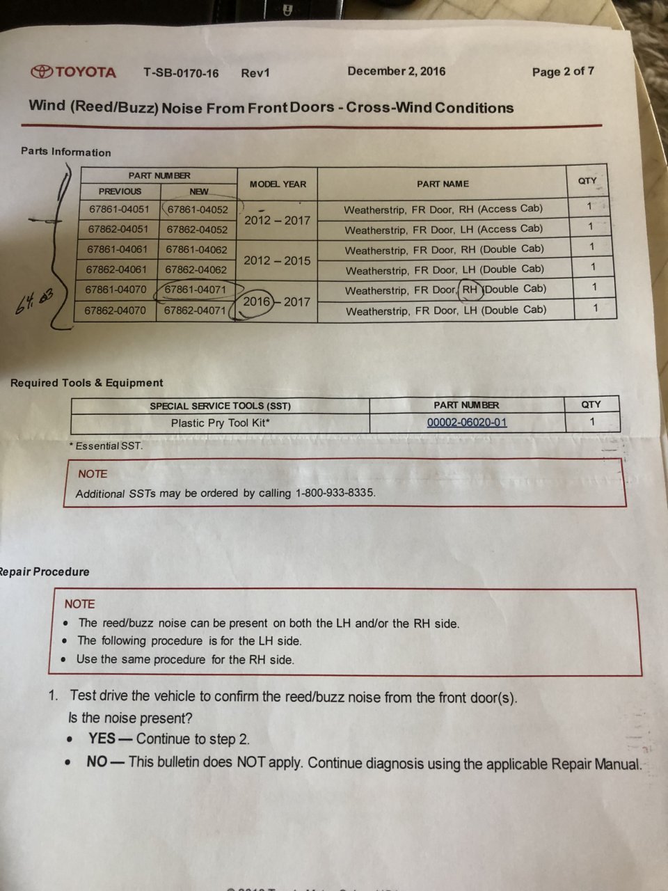

    Hellapeno
    Hellapeno Well-Known Member
    Nov 2, 2015
    #168414
    734
    Austin
    2016 TRDOR
    Choice Goodies
    Sup gents (and gentle ladies). Just got back from dealer and was told that my extended warranty didn’t cover replacement of this door seal even after acknowledging that this TSB would apply. I am outside of the window of the basic warranty. Might have to shell out 65 bucks to replace it, but I’ve put in a call to Toyota Corporate to see if they can help. Sucks that they won’t replace it, as it’s happened since I bought the truck brand new. To me, if there’s a new part number for the door seal, then they’ve made a part change, which means the original is susceptible to this defect, which implies a faulty design from day 1. Boom. I’m posting a video of this noise for all to see and hear, and I will keep everyone posted with what Toyota comes back with. My advice is to get this done regardless before your basic warranty expires.
    Prairie Hawk likes this.
  9. May 16, 2018 at 3:00 PM
    #109
    Hellapeno
    Nov 2, 2015
    #168414
    734
    Austin
    2016 TRDOR
    Choice Goodies
    Here is the TSB they pulled up for me, with part numbers for aplicable model years. Come on Toyota, make it right.

    I purchased the updated TSB door seals (67861-04071 and 67862-04071) from ToyotaPartsDeal.com for $107.10 and it solved my buzzing problem. The updated door seals have the "drip line mod" sort of built into the door seals and were very easy to install. The clips in the door seals are already in the new seals so no worry with the old clips, simply pull out with pliers and don't worry about breaking them. Will need to clean up some factory installed adhesive at top of door and the new door seals have adhesive tabs to pull after getting all clips in. You have to remove the door restraint bolt (10mm) to get the new door seal around it.
