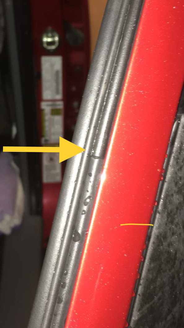

  3. Dec 18, 2017 at 3:10 PM
    #23
    Streak09
    Streak09 Well-Known Member
    Sep 20, 2017
    #230567
    82
    Dayton O! H! I! O!
    2015 TRD Sport DCLB Barcelona Red
    Old seals
    New seals
    Will wait for a windy day to confirm its fixed!
    TAC1 and I married my tacoma like this.

  5. Dec 18, 2017 at 4:04 PM
    #25
    NMTrailRider
    NMTrailRider [OP] Well-Known Member
    Sep 28, 2009
    #23469
    5,292
    New Mexico
    I inserted an arrow in your pic to highlight the bead that was added to the updated seals. As far as I can tell, the addition of the bead about halfway down the front and a third of the way back on the top is the only difference between Old and New seals.
    TAC1 and TRDSport10 like this.

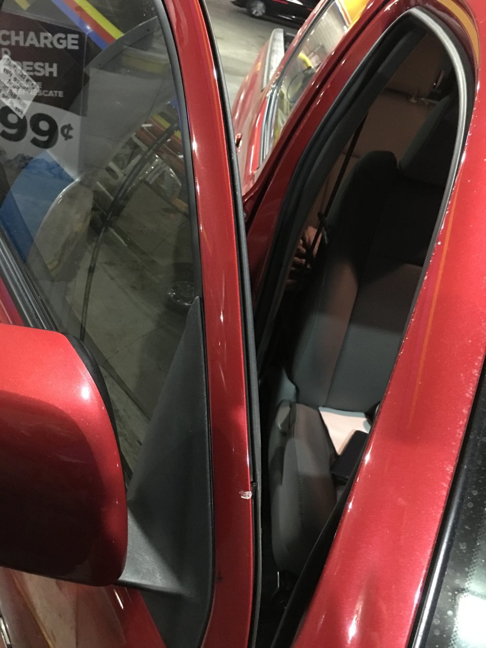

    Do you have a picture?
  18. Dec 20, 2017 at 6:02 PM
    #38
    GDOLBOI
    GDOLBOI Under Qualified And Overpaid
    Sep 12, 2015
    #164085
    811
    Concord Ca
    2020 DBL cab LB Trd Offroad 4x4
    King, BAMF, SCS,
    Did you add a piece under the factory piece? It’s hard to tell.
  19. Dec 20, 2017 at 6:05 PM
    #39
    kgarrett11
    kgarrett11 Master Yoda
    Jun 10, 2015
    #157122
    3,594
    Garrett
    CA desert
    2015 DCLB
    On the bottom? no. The top piece is just wedged inbetween the 2
