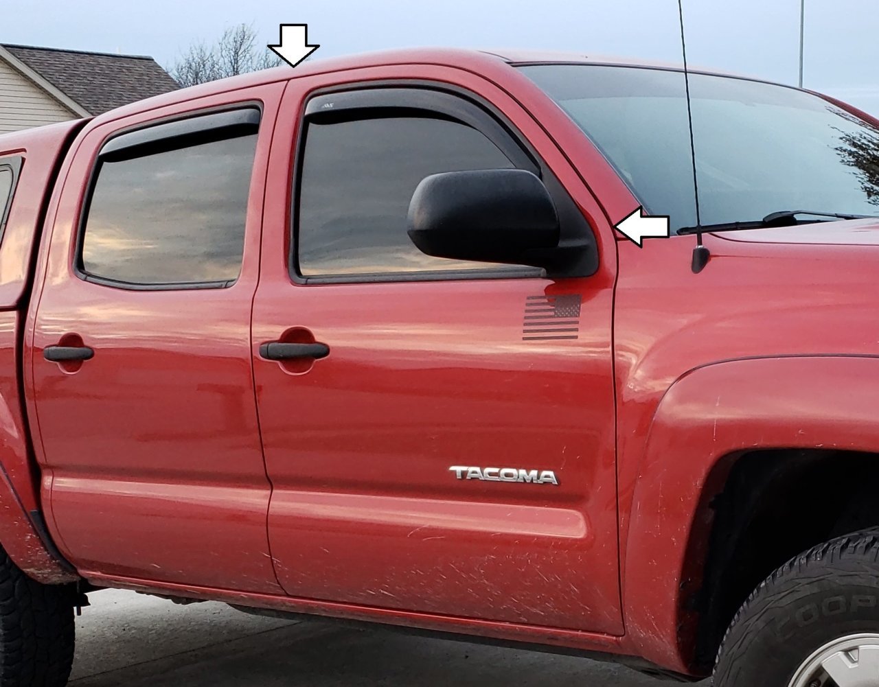

    For everyone asking about how i fixed it and what looks like toyota used as a basis for the TSB seals
    NOTE: the lil line between the a pillar and quarter panel is not needed, nor is the middle of the 3 1/4in line on the door seal.

    So only the one left most seal is needed of the 3 in your quoted photo?
    This is awesome. First solution I’ve seen that shows the noise is actually coming from about where the side view mirror is.
    What size “stuff” should be put in there? Just curious of dims. I’m sure some of the weather stripping linked above would do the trick?

    The right most is the easiest one and is typically where people are putting the larger weatherstripping.
    EDIT - I simply used 1/4in dripper pipe to fill all the voids so i for sure didnt have to listen to that horrible noise.

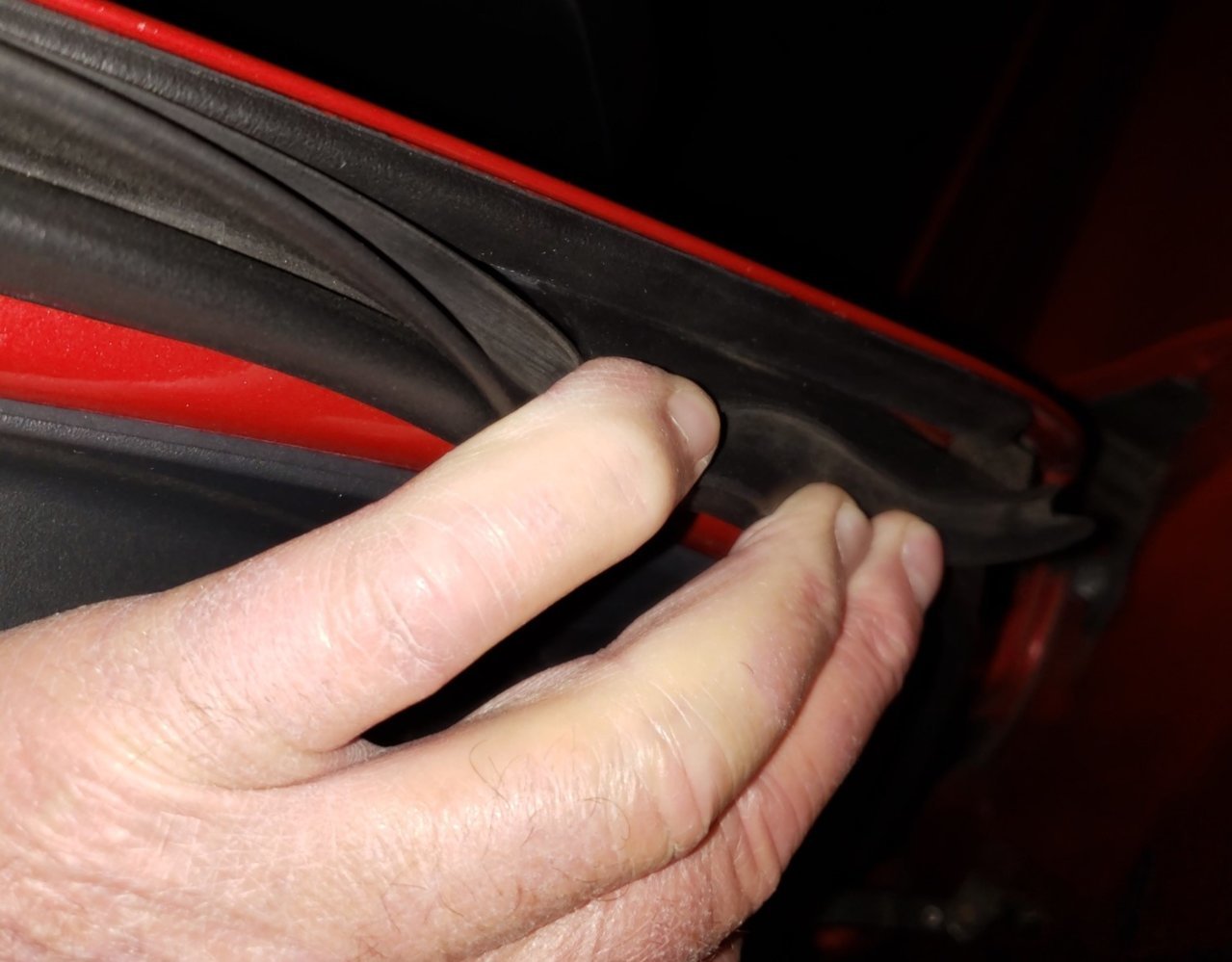

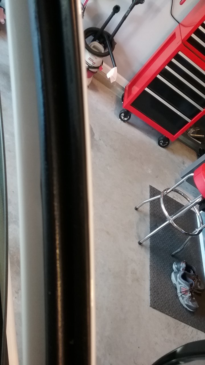

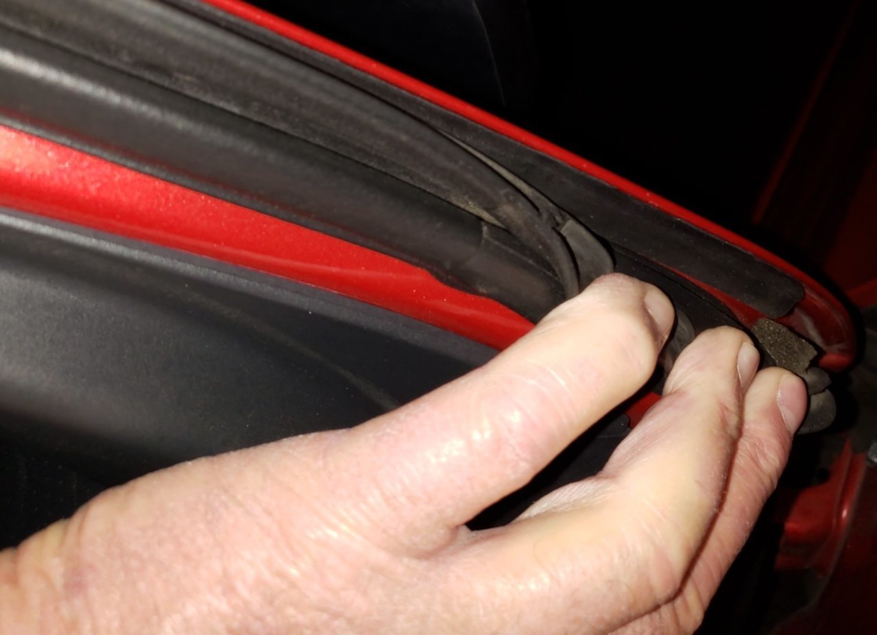

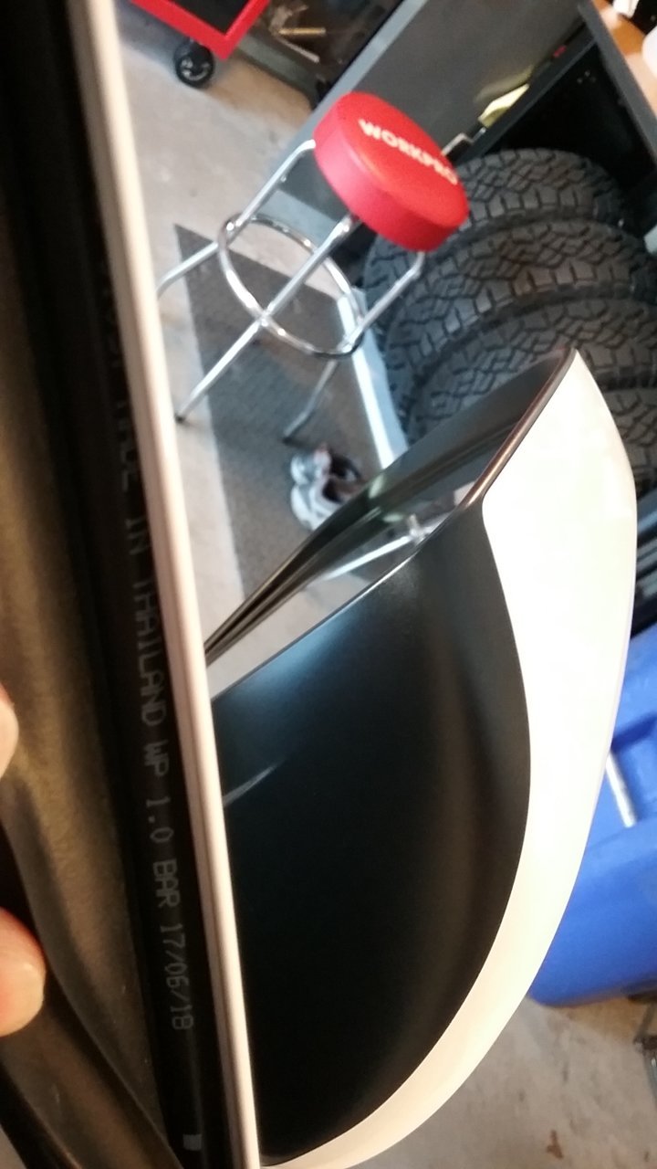

    I ran my 5/32 line from a couple of inches from the side mirror up to a couple of inches from the top corner.
    Can't even tell it's there when not pulling the seal back.
    Hopefully this solves it. My trial run with a shorter piece showed great promise last week.

    Update:
    Yesterday we had some big winds...45-50 mph. The kind of gusts that pull on the steering wheel at highway speeds.
    A couple of times I heard a bit of faint kazoo from the driver's side. Nothing from the passenger side. I'm not discouraged....because it had gotten to the point where any crosswind would cause the noise quite loudly.
    Both sides have been kazoo free for a week and half to that point. So for now, I'm happy. It's not often that we get those kinds of winds. So it was an exceptional day. I could try going up a size in the vacuum line. But I don't want to displace the seal anymore than I have to.
    At some point I may look into the revised seals. But for now a 95+% fix is good enough for me...especially given how bad it had gotten.
