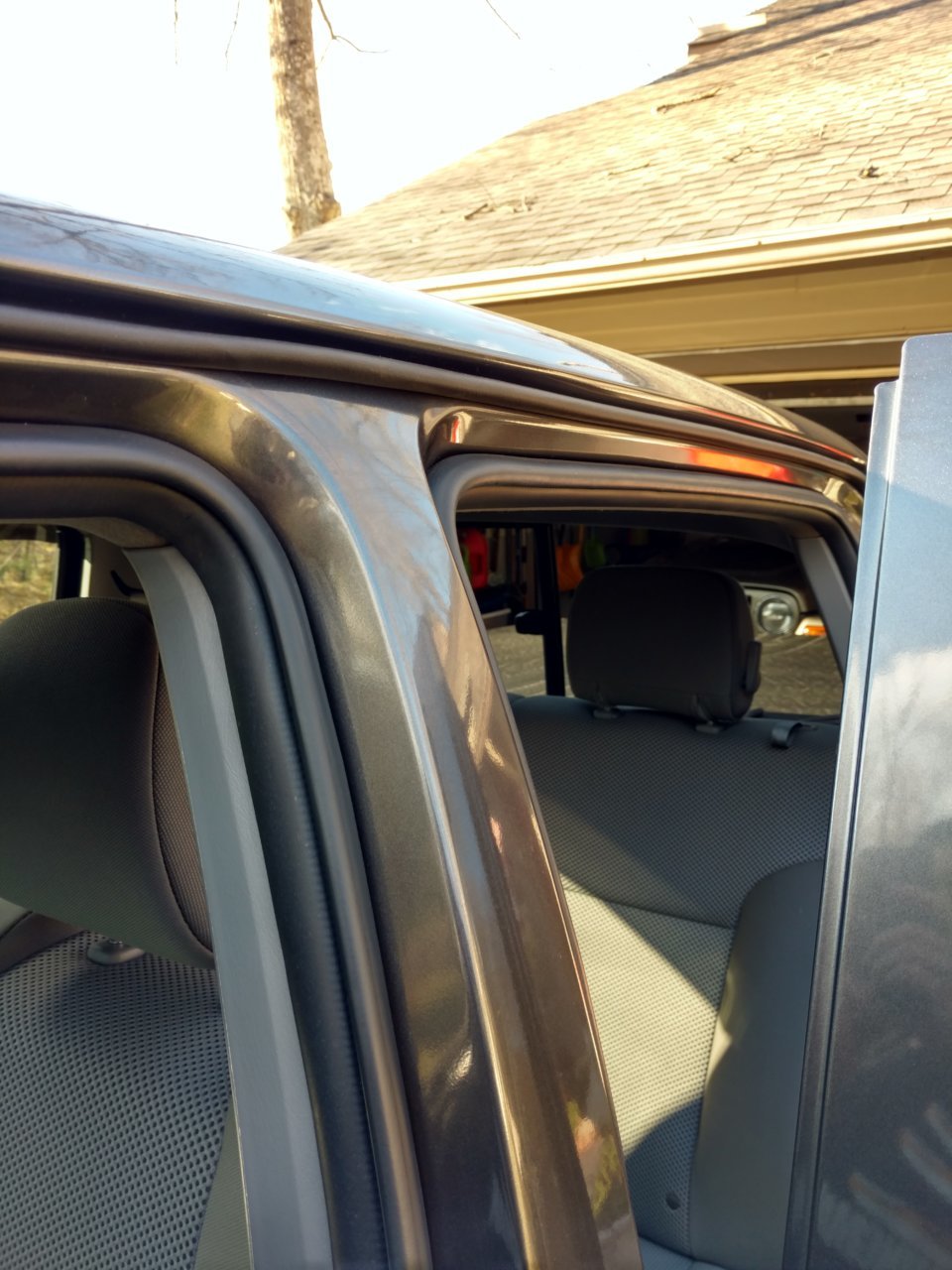

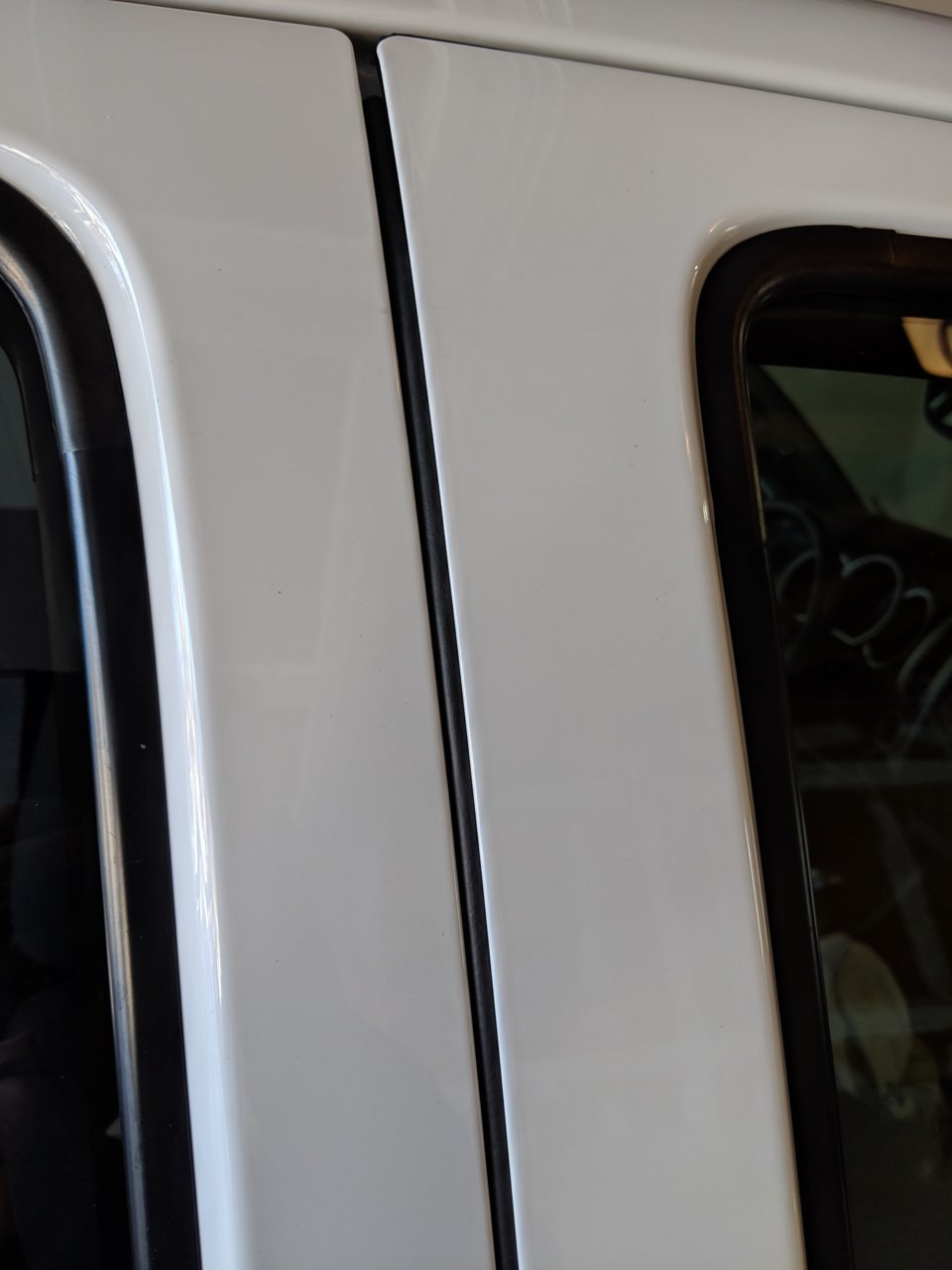

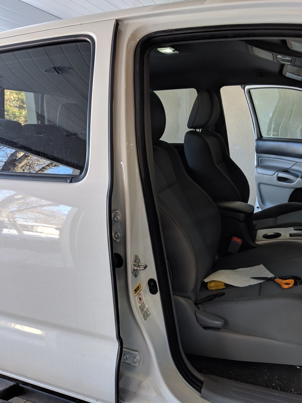

    Got mine installed about a week ago. I ran mine like the others did, from the mirror along the top edge of the door to the upper corner, under the existing weather stripping. BUT, I used the left overs and ran some along the vertical seem between the front and rear doors, then again for the rear door. This has made a huge difference in wind noise! The truck also sounds, idk, more solid when you shut the door.
    A tip, if you plan on running some on the vertical seem: warm up the adhesive on the weather stripping before applying for a better seal. Especially if it is cold outside when you do it. Also clean the metal before applying.

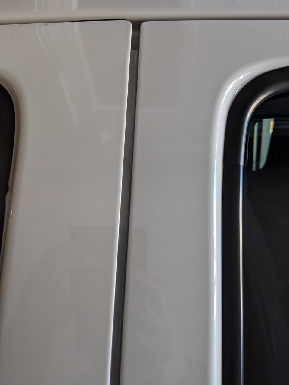

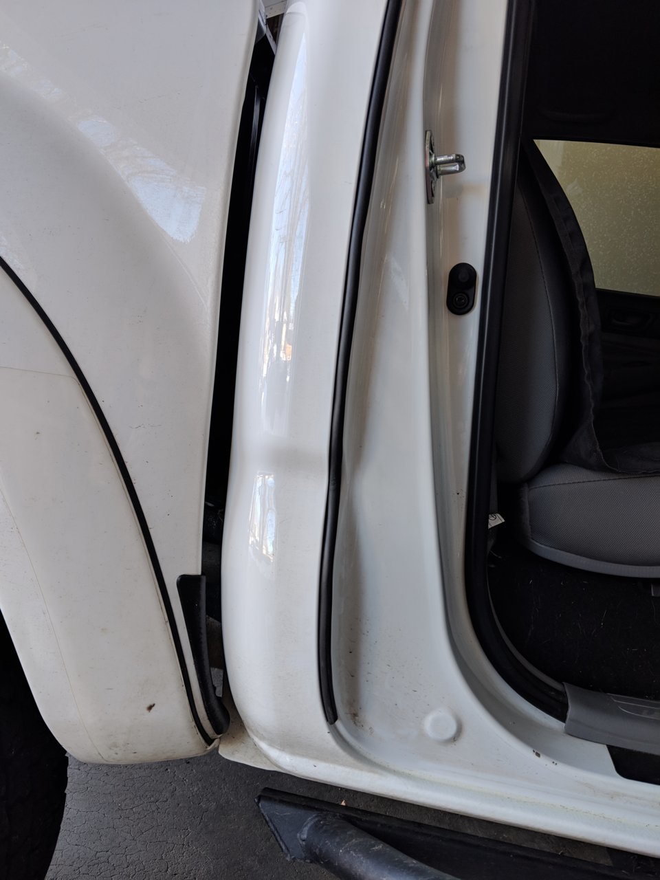

    More photos with the door shut
