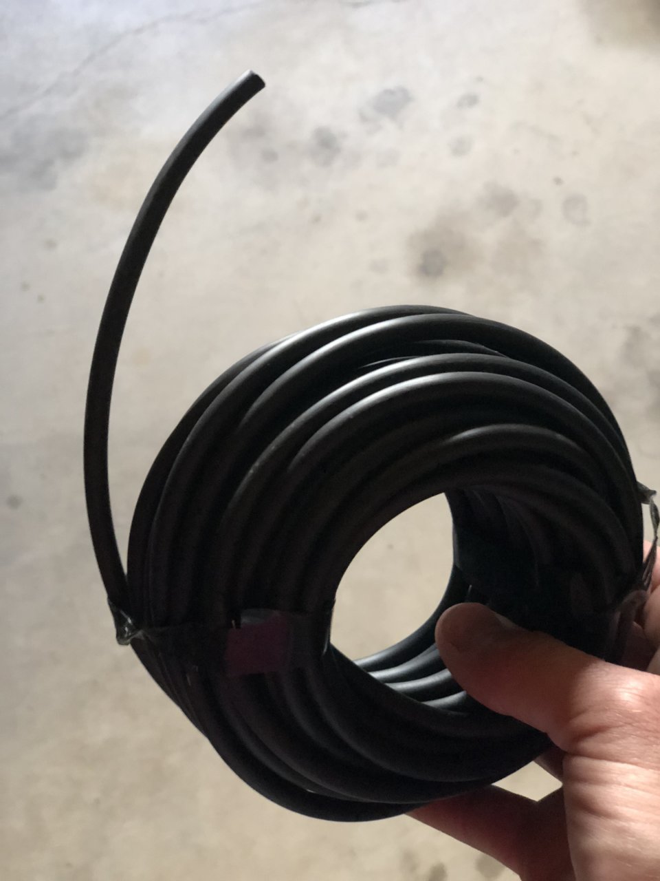

    Easier fix for the kazoo noise is to put your own 1/4 flexible tubing behind the weather stripping...

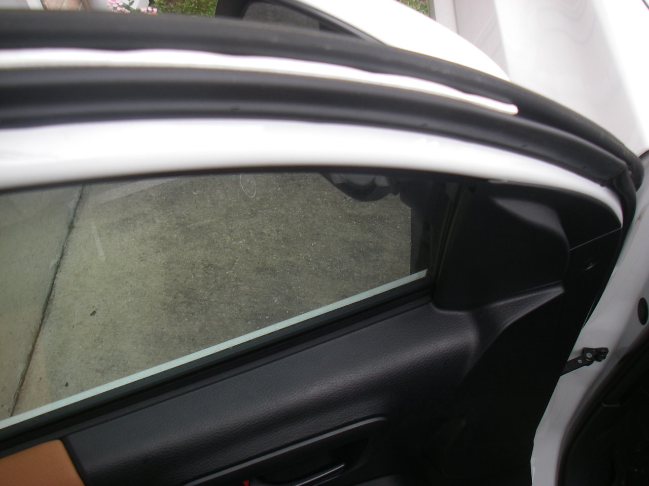

    2 weeks driving in high cross winds and I couldn’t take this anymore. Either the climate is changing in my operating environment, or the door weather stripping has had it.
    My guess is a bit of both, but I blame TOYOTA more for the cheap rubber materials they have used. In all my years of vehicle ownership, I have not had to replace any rubber or weather stripping after only five years. Shame on you TOYOTA, you need to do better.
    But thanks to the great Tacoma TW support, I was aware this might be an issue and there maybe an easy cheap fix, and there is. And I found it here.
    I applied it as OP #1 and no more Kazoo!

    So you added tubing (not Frost King) BEHIND the existing? I should try this. I don't think this is how I did it previously. Thanks.

    Yeah tubing behind the existing weather stripping. Behind and sort of on top.
    I will add though, that my weather stripping has been problematic since I bough the truck, even replaced it all once. Didn’t help.
    Besides the kazoo noise in a hard cross wind, mine also makes a clicking sound. I have an access cab. Because the front doors close onto the access doors, the whole system feels slightly loose, maybe the doors are off by a fraction of an inch, I don’t know. So the weather stripping mounted on the cab, sort of sticks and I sticks to itself and the metal door sticks and I sticks to it making an annoying clicking sound on rough roads.
    I have added tubing in that as well, basically making all the weather stripping around the window and top of the cab puffier so the door seals tightly and doesn’t allow the kazoo noise, and the rubber on metal or rubber on rubber can’t click together.

    Do you by chance have a part or item number for this tubing? Just your basic black rubberized 1/4" tubing? I remember some years ago doing this with an old Subaru with the frames windows. There was a road noise that I traced to right by the mirror and I ended up using one of those long erasers inside the weatherstripping and it was quiet again. Amazing how a simple fix is all it takes sometimes!

    Just generic 1/4” tubing, like for drip irrigation is what I used. I also had clear ploy tubing laying around from a relatives oxygen machine and it was too soft. Didn’t help

    What would I do without this forum?! I have a 2015 DCSB SR5 that has had the kazoo noise on the passenger side since I got it in December 2016 (bought it from a dealership with 17k miles following a 1 year lease from the previous owner). Sometimes I could "fix" the issue by slightly cracking the passenger side window. It might prevent it a little but it was always there. The other "fix" was just playing music loud. Anywho, I purchased this stuff on Amazon (link below)
    and lined the passenger door behind the existing seal as pictures have shown, I also lined the frame like another other guy did. Driving it 4 days on freeways and no kazoo noise! Easiest $8 fix ever! I still can't believe I waited as long as I did and didn't check this forum sooner haha oh well. Love my truck again!
    https://www.amazon.com/dp/B000HE7YQM?ref=ppx_yo2ov_dt_b_product_details&th=1
