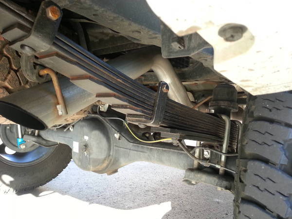

    Not 100% what you're looking for but I cut mine and dumped right above the axle...no fumes for me

    That's where most dump it, including myself. No issues with fumes in the cab.

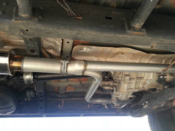

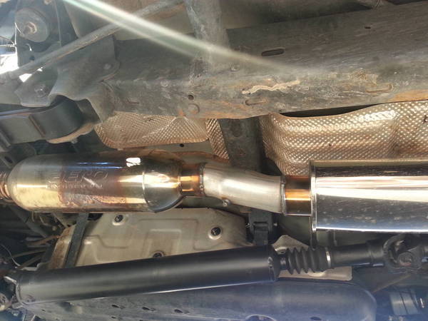

    had a local shop do mine. crossed it over behind the T-case. 2.25" into 3" after the Y collector. then dumped down past the axle. dont mind the soot.. only one set of cats thanks to the URD headers. previously had no cats.. but added them into the after on another visit..
