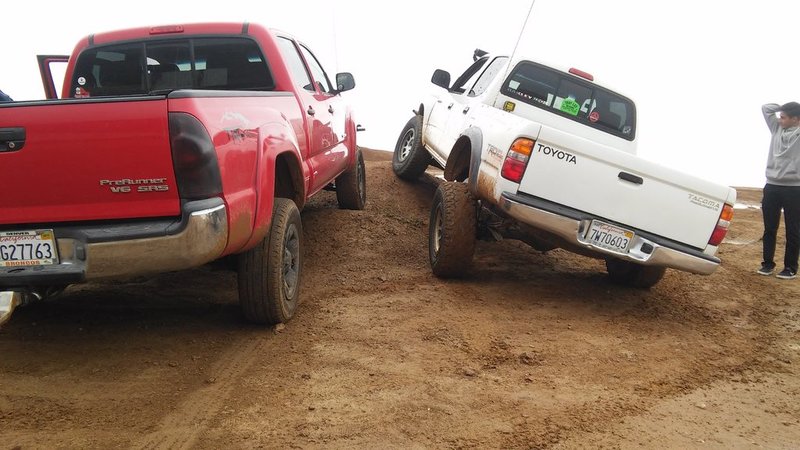

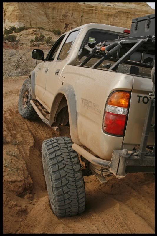

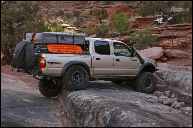

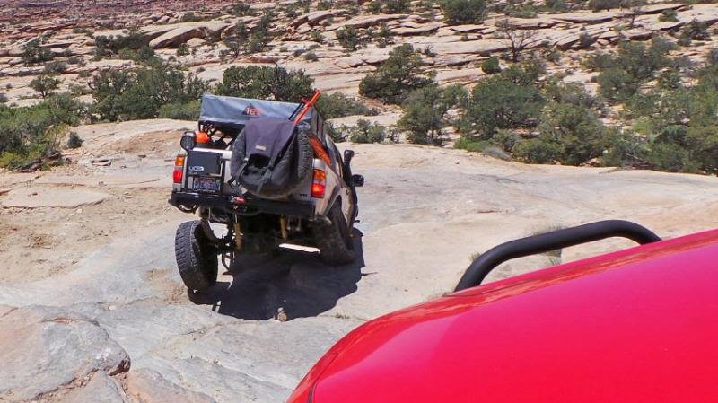

    I can see the handling benefits of having the shocks outside the frame, but as for travel, I hate to rain on your parade but it doesn't look like you are getting much more than most other "normal" setups. Maybe it will improve some when you get new leafs unless you're already hitting the max extension of the shocks?
    It might be worth revisiting the shock mounts. I'm only running 9.75" travel shocks, but I relocated the mounts and I think I'm getting several more inches of travel than you are even with shorter shocks. It all comes down to the mounting locations to maximize the travel of the shocks. Then getting leafs that flex without binding.
