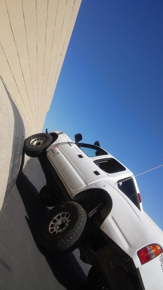

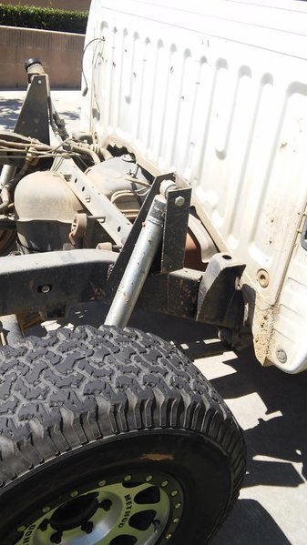

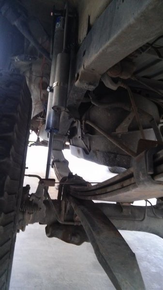

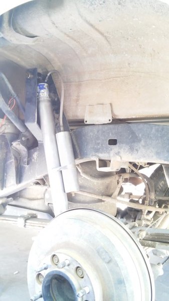

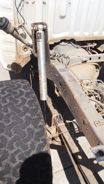

    So.... I was doing a droop test... Brake line is limiting it so this is the full droop right now. Shock has 4" of shaft left in the body0816151820.jpg 0816151828.jpg 0816151828e.jpg
  11. Aug 17, 2015 at 9:18 PM
    #91
    Anthony250
    Anthony250 Ex Fabricator
    Sep 29, 2010
    #44016
    3,775
    Anthony
    Rialto CA
    99 Tacoma LT Prerunner
    LSK Race Kit, King Shocks, Methods, Glassworks, Baja Designs, Built by myself.
    Nice! Did somewhat of a similar setup on my truck in the past. Downside, stock leafs suck ass the overload leaf is going to make it ride terrible, deaver J59s are good temporarily, downside on them is they only can pull 10-11" of travel and in that its bad going into negative arch. Stock leafs is worse. If your going to really push the truck you must fully build the rear end, with spring under leafs. As for running air bumps, its pretty nice benefit, downside theres not alot of room. You would have to get a bump and make it a 1-2" stroke, and place it up agianst the frame. Yeah Id get a extended brake line, and as for shackles dont get any lift shackles, it only makes the negative arch even worse which shortens the leafs life, Ive personally cycled the leafs with and without shackles and have pics of my old setup if you wanna see.

    Needs leafs. Looks like same amount of travel (of ALOT better quality) then i got out of my 10" stroke shocks and 2.5" leaf pack.

    And basically these are 10 inch stroke right now... The droop right now only uses about 10 inches of the shock because of leafs and brake line

    broke college student here too, working 3 jobs. I cut brake line mount off and lowered it a couple inches and now it doesnt go tight when that tire is drooping. cheap bastard mod.

    That's what I was thinking about doing... I might just do an extension then be good. But I need deavers so bad

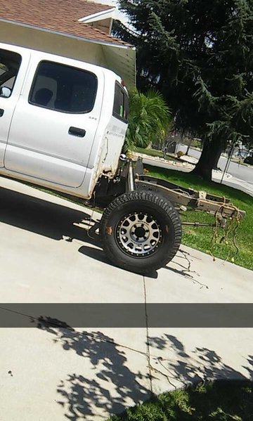

    0729151055.jpg 1438194437718.jpg 0729151055a.jpg Forgot to post these... Without the bed on before I put the bedsides on
