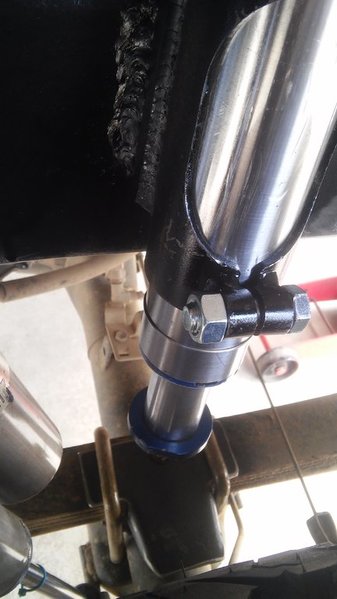

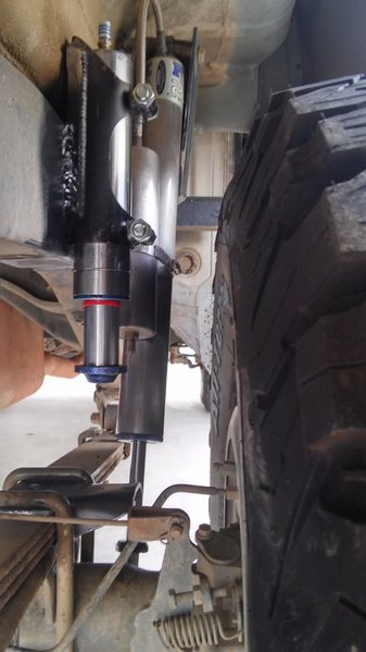

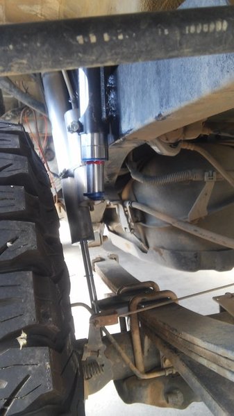

    Can't wait for new leafs Tbh.. But at least got these and I think I need to shorten them only about 2 or 3 inches of travel before contacting the bumps. Sooo shortening them Rn!1003151122.jpg 1003151122a.jpg

    Yeah, I would definitely think you would want to shorten them given they are almost 30% of your travel as is. Going to do 63" leafs?

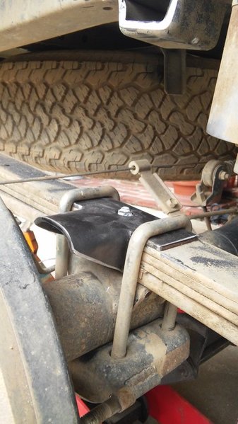

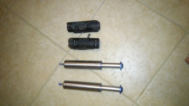

    I wanna get em Idk bout my wallet lol and I shortened them now 2.5"s1003151913.jpg

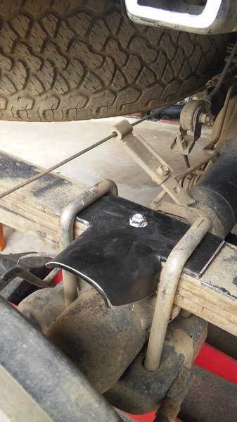

    Made my strike pads

    Dang! Those shock shafts are close to your leafs! Get the cans mounted up yet?

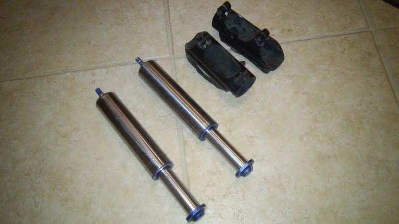

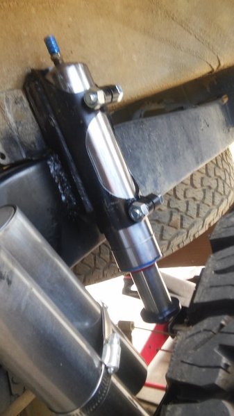

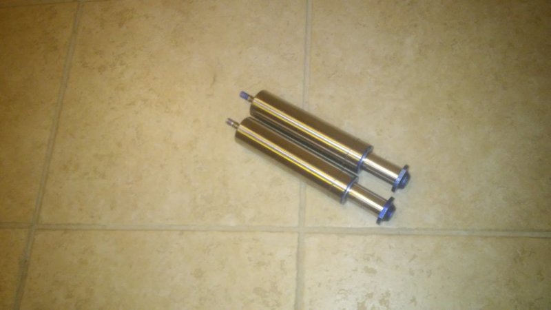

    1005151128.jpg 1005151129.jpg 1005151129a.jpg 1005151129b.jpg so guys look what I have

    you should get some pictures that show us the "tire to shock/bump clearance" at full stuff
    seems like you get a little bit of rub, what size spacers do you have?

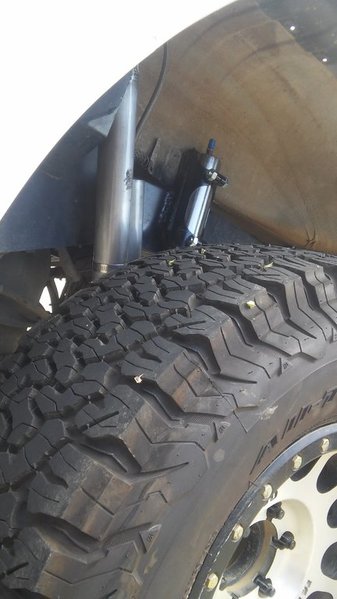

    It rubs a little now since I have 33.1250s now. But only 1.5 inch spacer so now I need to get some 2inch ones but at full articulation.

    1005151255.jpg tire shock clearance about 3 inches
