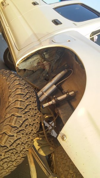

    Anthony I wish I could go sua and I plan on doing j59s with my 14 inch shock with stock length but beefed up shackles thanks for the info willbeck much appreciated and more flex pics with the 33s 1015151734.jpg 1015151733e.jpg 1015151735c.jpg

    What do you mean by fully extended? The axle is on stands.

    At full bump looks like the shackle would hit the frame

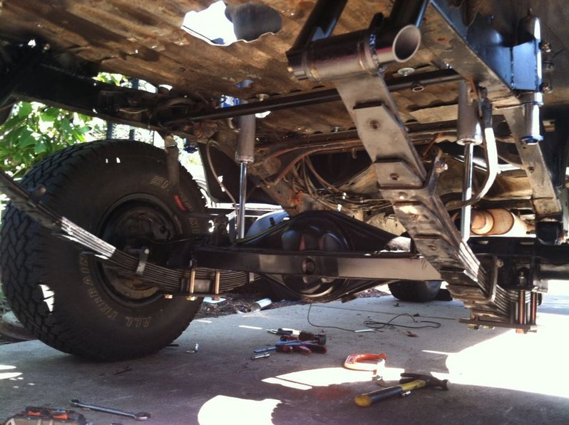

    Got my mid travel kit done. Solo Motorsports rear shock hoop mounted outside frame rails. Bilstein 7100 reservior shocks 12" stroke. Hoop painted gunmetal grey. Deaver J59 pre-runner progressive leaf springs. 1.25" wheel spacers. My first real welding project.

    Welds look a little suspect, but trust, I'm no one to talk.......looks good man. How does it ride over stock?

    Ya, like I said, first real welding project. I got good penetration on the welds so we'll see. Ride dreamy now. Had Rancho 9000's with the deavers and always was harsh. Now pillowy feel. Went with lighter 175/60 valving on the Bilstiens as per recommendation from them. Feel a lot more confidence in turns, less body roll as shocks are slightly angled out.

    I'm not looking forward to welding up my cam tabs or buckets either. May look like popcorn. Popcorn's the way it's supposed to look right?
