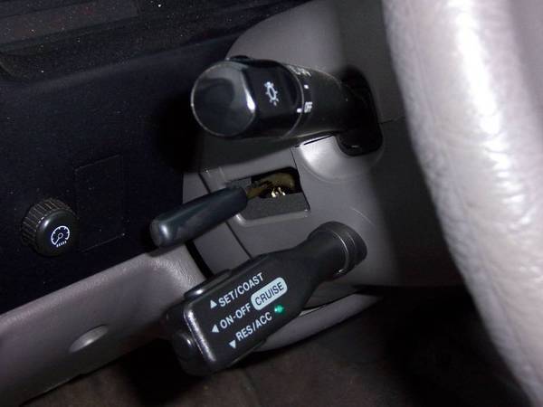

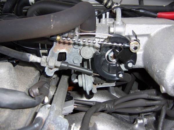

    I am in the process of installing the Rostra Global Cruise into my 03 2.4L tacoma. I have it mounted, wired and the light comes on.
    But it still doesnt work, they are closed today due to the Holiday, I will call them tomorrow.
    The VSS and the Tach wire are the culprit, I think. The directions are a little vague. I found the correct color wires in the right area but the signal is not getting to the computer.
    I will post the info when it works, K.L.

    I have been troubleshooting a problem with the tech rep all week and I found it last night. I was looking at the wires on the ECM and what looked to be the green/orange wire was actually red. Next to that wire is a green/yellow looking wire that was the one I was looking for, although they called it green/orange. The cruise worked on the way home today, it captured and held like a champ, I accellerated and coasted but that was as much as I could do, traffic was brutal on a friday evening here in Massachusetts.
    Alright, this afternoon when the rain is gone I will reassemble everything that I have had apart, I will also shoot a few pictures of the really simple installation of this thing. Simple, but I blew it on the VSS wire!

    I found an even more interesting thing to do with the cruise today.
    When I installed the kit, one of the wires in the harness was for an external light to show when the cruise control was activated. I noticed that the legend was there in the left side of the dash, but it did not test when starting. I looked up the wiring diagram on Auto Zones website and I figured the cruise wiring would be similar in the 1996 diagrams that they had.
    I went to the RH kick panel where I figured the black/yellow wire would be. It was there in the connector that the cruise computer would be if I had factory cruise. I also went looking for the Black/orange wire which is the power feed to the dash lights, it was connected to a relay in the fwd fuse box. I grounded the wire in the kick panel and the green cruise light illuminated. I then ran a wire between that wire and the light output for the cruise computer and took it for a ride.
    So now I turn on the sruise and the LED on the control comes on, Then when I set the cruise i get the green light in the dash.
    WOOHOO! Stupid things like that amuse me!:)

    Its working great, I took it to Maine last weekend and my foot was really happy. The Rostra kit came from M&R electronics, I got it off of E-bay for $219 with the correct throttle bracket and the control unit shown in the picture. It is a clean install and the tech support at both places were really helpful. (M&R/Rostra)
