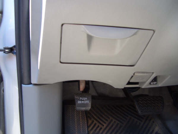

    where is the fuse box on the cab located. is it on the driverside kickpanel or somewhere else?:confused:

    Left of the steering wheel right behind this:
    Pull this cubby out, and the fuses should be behind it.
