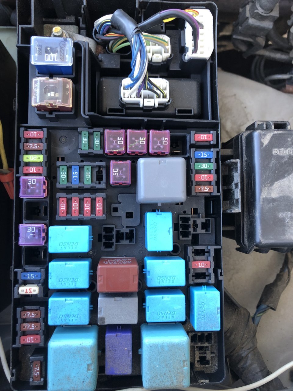

    4D46EADE-F6E0-41F1-B41F-0FFACEA3CA1F.jpg Ok - thanks -
    Which fuse is for CC under the hood?
  2. Jan 6, 2019 at 12:33 PM
    #22
    Clearwater Bill
    Clearwater Bill Never answer an anonymous letter
    Oct 11, 2014
    #140097
    24,458
    Billy
    Largo Florida
    '13 5 lug AC w/convenience package
    A few OE parts from fancy trucks
    No labeling inside the cover you took off?
    I don't have the same year, so can't guarantee the fuse layout to be the same.

    What he said. There should a diagram on the inside of the cover.
