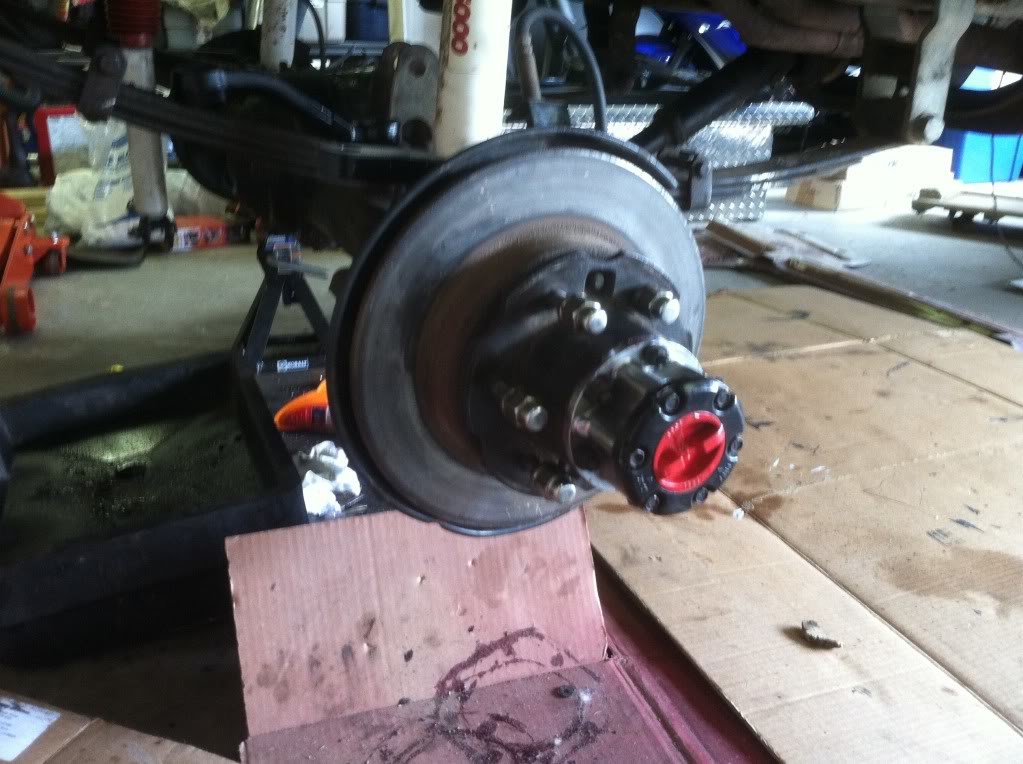

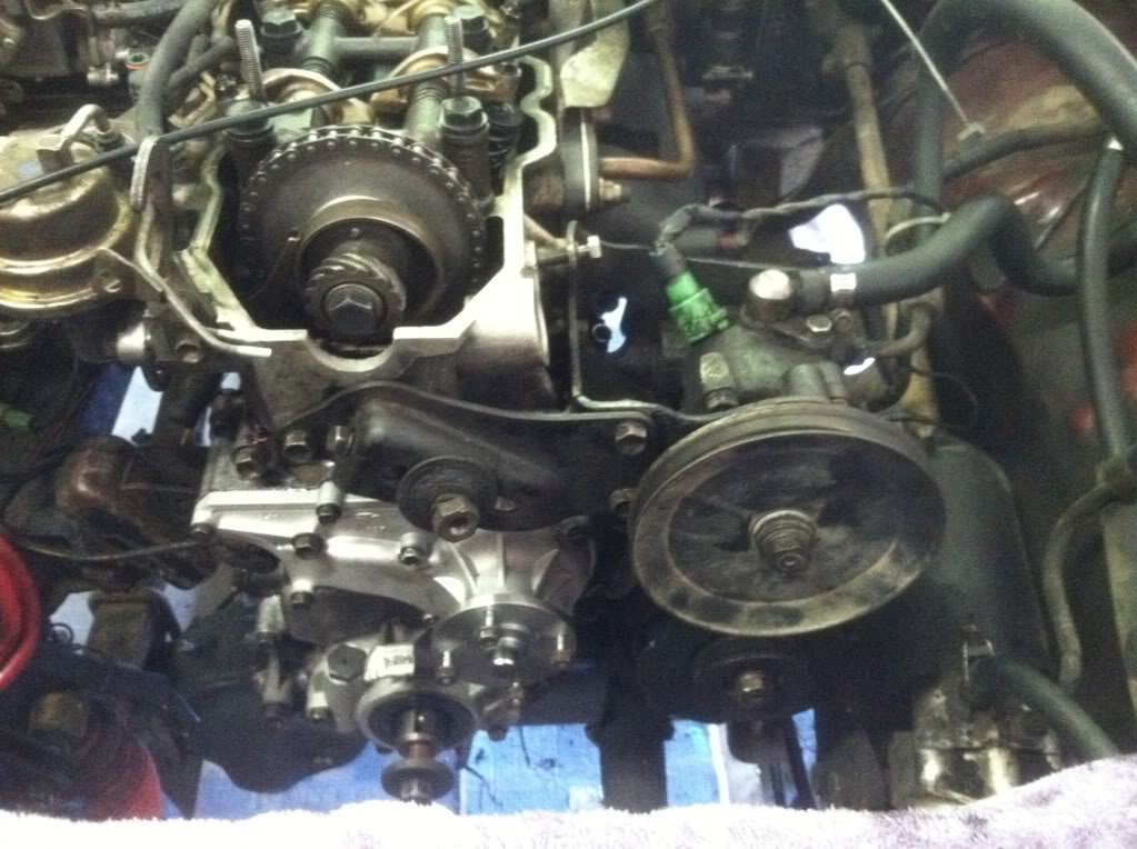

    Hub Completed, except for one stupid bolt that decided to break. Not sure how I am going to get it out. I have had bad luck with using the reverse thread bolt extractors.
    Also got the power steering pump installed.
    Side project in the works as well. Need to figure out where and how im going to mount. Thinking two in the 07 and one in the 84 for now.

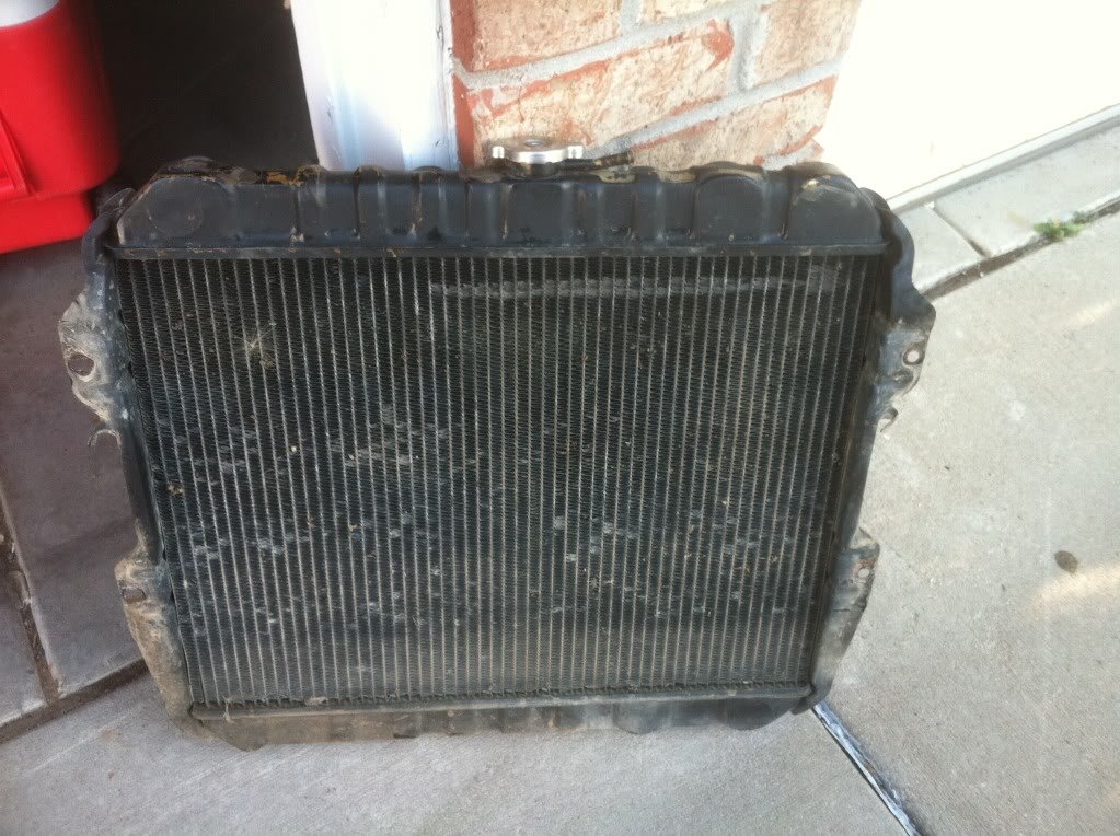

    I took my radiator in to get cleaned up.
    Started like this:
    And ended up nice and clean and freshly painted:

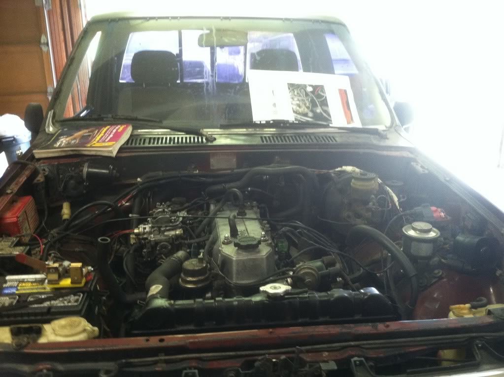

    Well getting ready to add the fluids. I bought enough for two full fill ups on the diff gear oil, engine oil and coolant. My plan is to run it for about a week (test run, couple trips to work, etc) and put some seafoam cleaner in the fuel and oil for the last couple days. I will then change out all the fluids again and check for any problems. I will change out the tranny and rear axle gear oil as time permits. The brakes will get new fluid as well since I had to disconnect and drain the lines.
    Is there anything else that I should do?
    Getting close:

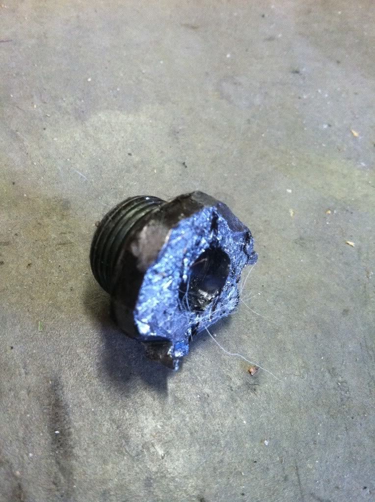

    Had to drill out the diff drain plug and beat it off (kinda left that for last). But cleaned and flushed and filled her up.

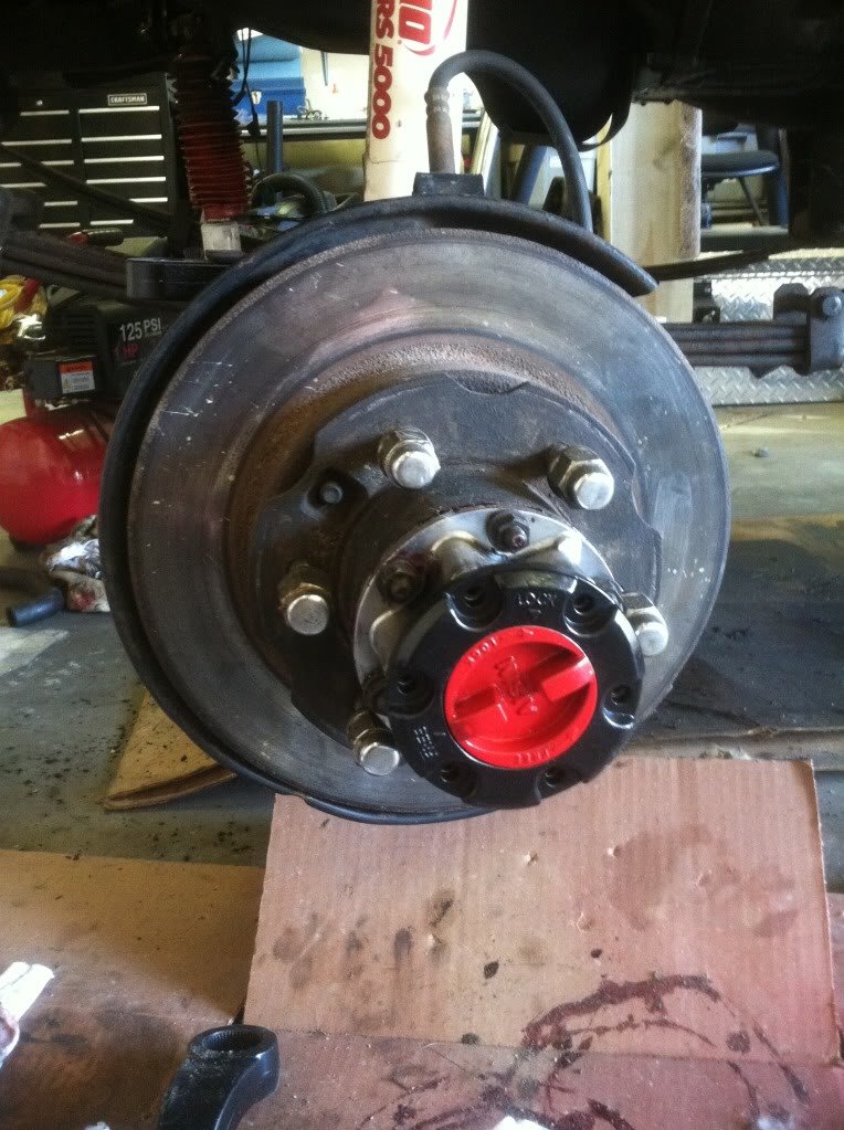

    Used a bolt removal tool to get the broken bolt out of the hub. What was weird about the whole thing is I used a spare matching bolt and the second one broke. I was only trying to get to the recomended torque of only 9ft-lbs. I decided not to torque the 3rd bolt to that torque again. The only thing that I can think of is that there is a burr that is slicing the screw, or ironically two bolts that were week in the same spot.

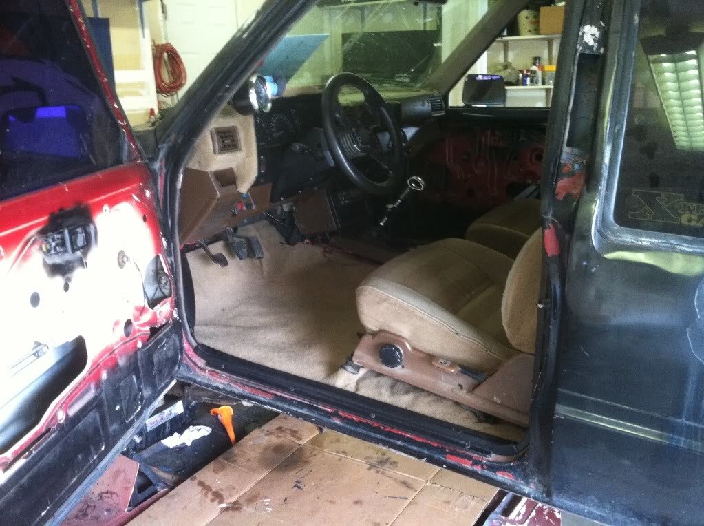

    Finally this weekend I cleaned out the interior to get it ready. I painted a couple of the plastic trim pieces black (still have a few to go). I need to paint the rocker and the door. Still debating on the material for the door panel but that's another discussion.

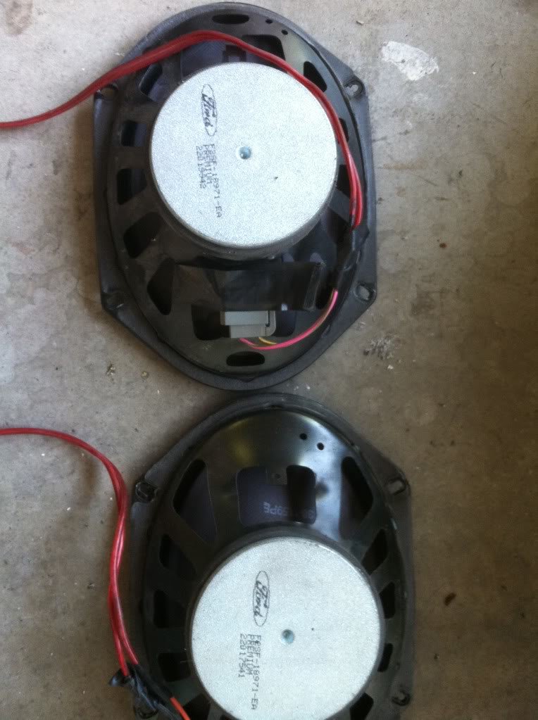

    Found some stupid ford speakers in the back. Decided that those had to go.

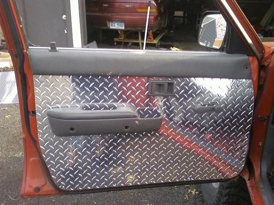

    So I am getting ready to start looking for material for the interior door panels. So which should I build? Wanting cheap and easy and stylish.
    - Black Plastic
    - Aluminum sheet metal
    - Aluminum diamond plate
    - Leather with Wood or cardboard backing for support
    - Fabric with Wood or cardboard backing for support
    - Replica OEM or used OEM
    82265d1276145629-looking-ideas-custom-do_4d389d30954325e876be74c9dac568205bfee6d7.jpg
    I'm really thinking the aluminum sheet metal looks the best but not sure about the flimsiness of it.

    I have looked at those aluminum ones for my 90'. might be loud as hell though, turn the door into a big ass snare drum. I dont think it would be flimsy, through a few rivets in as needed.
    I still have my OEM panels so I may try to re-purp those.
    If you go diamond plate or sheet metal I want to hear how they turn out.

    Really wanted to get JUNKTRK started up this weekend. I put the oil and coolant in. Ended up with a coolant leak because I missed a hose connection. Wasted most the day Sunday fixing the E-brake and installing new drum brake pads.

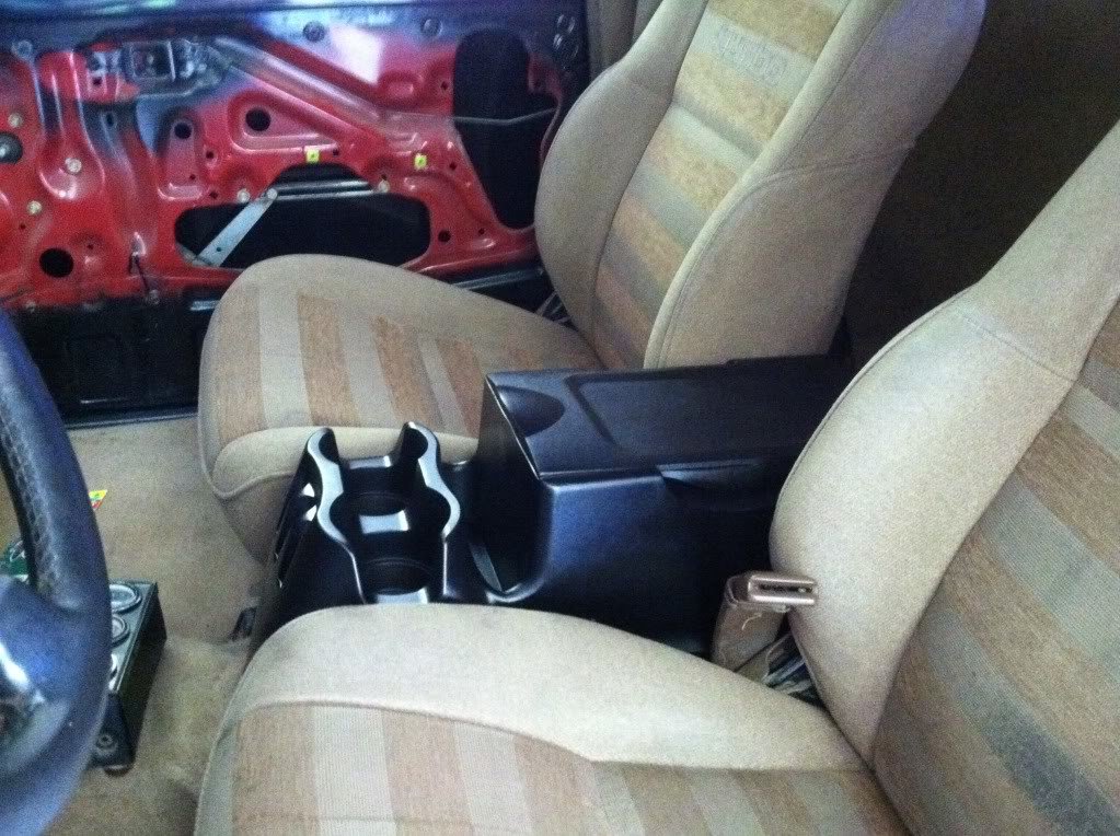

    Painted the center console

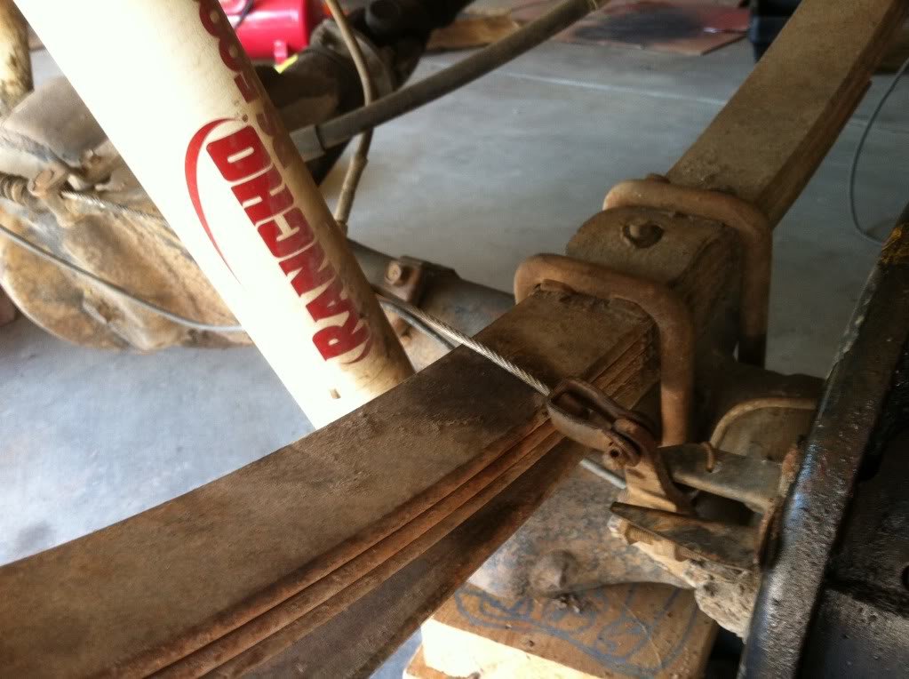

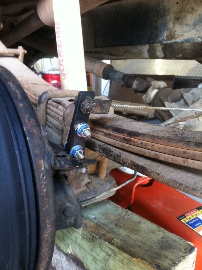

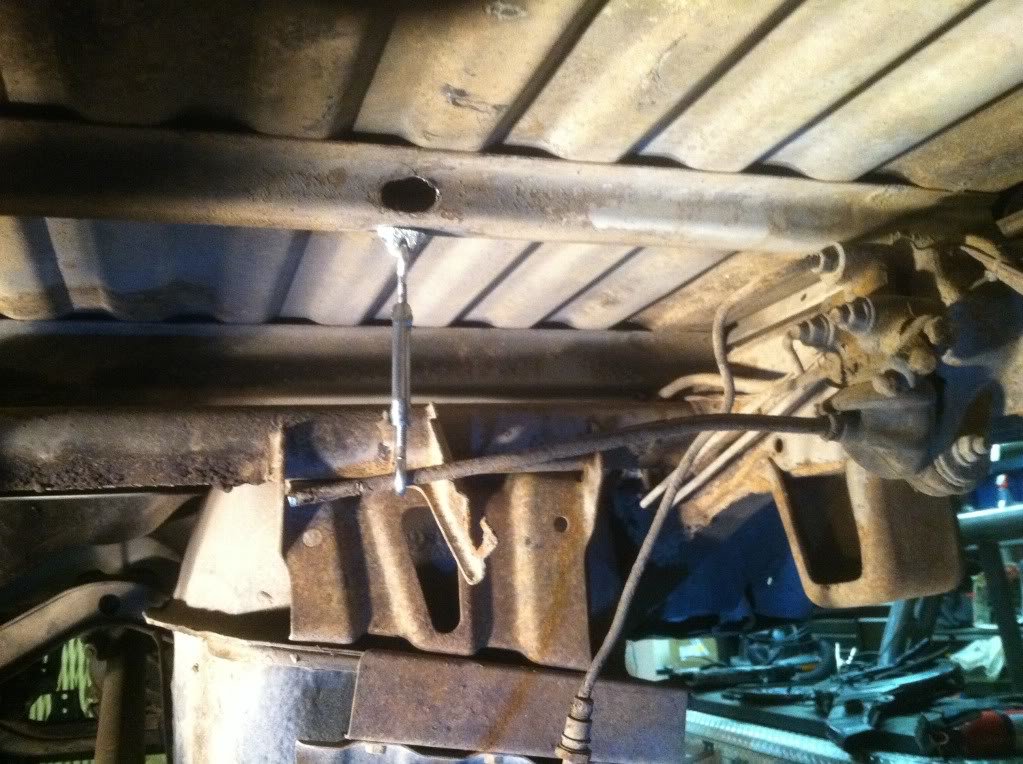

    Cut the arm to the rear brake load sensing purportioning valve and added adjustment to it from the top. This way I can actually have rear brakes. :)

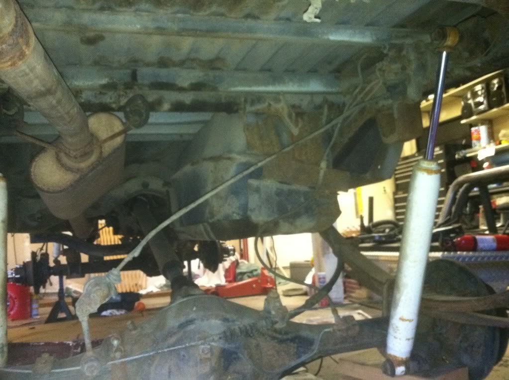

    Added brackets to the e-brake cable connections to avoid the leaf springs and the shock. Now I can park on slopes.
    [ATTACH=full]1935503[/ATTACH]
    Finished the rear drum brakes so i decided to put the tires back on. Wow, forgot how big this thing is.

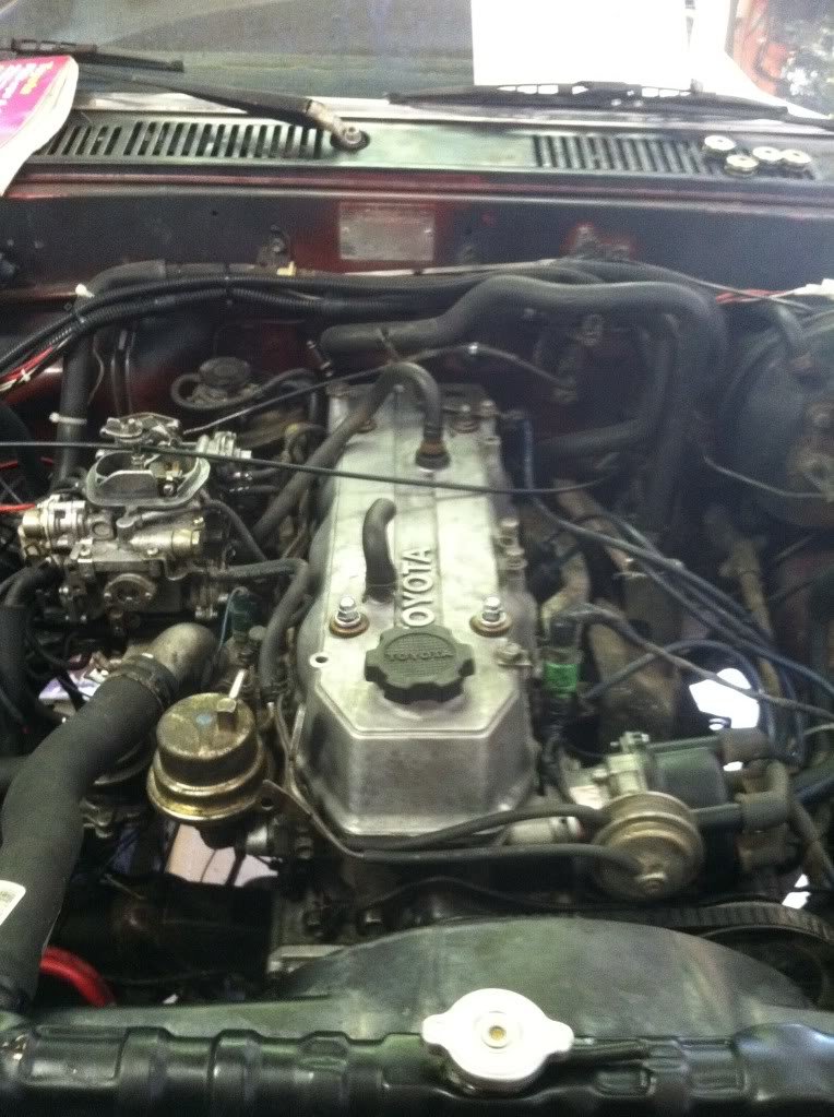

    GOT IT RUNNING TONIGHT!!!!!!!!!!!!!!!!!!!!!
    Started up rough, played with the distributor to get the timing right but the idle was really rough any lower than 1100-1200 RPM. Suspecting it has to do with the carb so my awesome friend is taking my spare carb home to rebuild it tomorrow (purchased the kit a while back).
    Took it for a quick little test drive since it was late. Rides high and bumpy with the knobby tires but AWESOME. Can't wait to get to the mountains.
