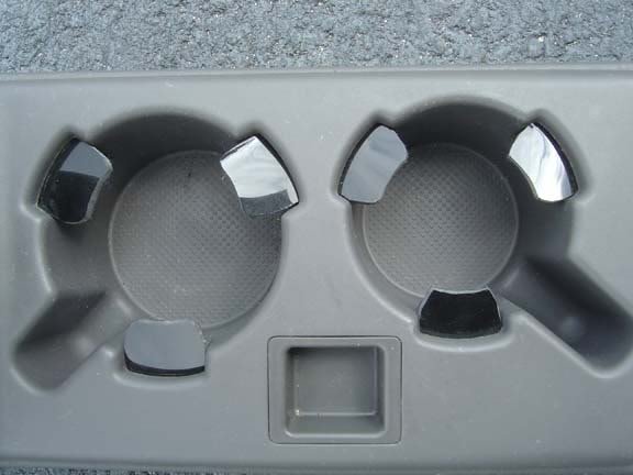

    I'm finally getting around to posting a pic of when I did the mod. Worked out Great! :D

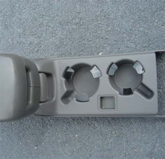

    Did mine today, just thought i would share a couple pics... I used a thicker rubber mouse pad for mine it came out pretty nice! As an added bonus i found all them lost peanuts between my seat and the console..lol
