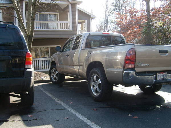

    This is my 5 lugger, Hankook Dynapro ATM 265/65/18's. I bought these rims when I was running the lowered look, they looked good with low profile tires. Now I have a 3" lift, thinking I need to paint them black now. Any thoughts?

    This is Johns Taco, I just posted pics of my gold tacoma. I have the fat bobs garage lift, it's good for now but I want a more professional set-up for up front.

    Those 18's look pretty good with it lifted John. Personally, I would DEFINITELY go black but that's just me.. I have the exact same lift coming early next week and I like the look of what you have going. Do you have any rubbing issues with those tires? And do you possibly know the backspacing of the rims? And thank you for the calc comie.

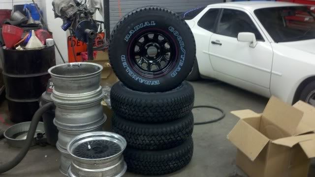

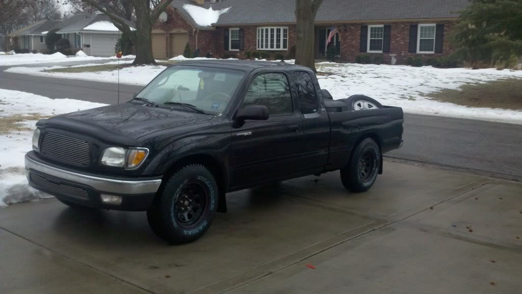

    Ok you can add me to the list...
    Wheels: Cragar D-Windows 15X7, 5X4.5 bolt pattern, 4" backspace, 0 offset, 26 lbs, unsure of center bore (1st gens are lug centric, don't know about 2nd gens). Cragar wheels WILL NOT fit 2nd gens, they hit the calipers. Ask Tio ;)
    Tires: Goodyear Wrangler Radials 235/75/R15
    Mods: None required to run setup, but I do have a 3" Fabtech front spindle and 2" Beefed rear shackles.

    Pics
    This is pre-lift

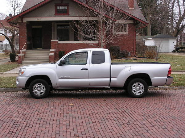

    Here's my 5 lugger with stock wheels and tires:
    And here it is with stock wheels and 230/75 R15 Wild Country Sport HT tires:
    The original tires had 51,000 miles on them and reminded me of mini van tires. These new ones lift it about an inch and they fill out the wheel wells a little more. It looks more like a truck now.
