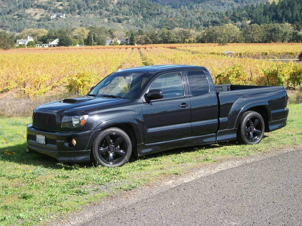

    Wheels
    Black powdercoated stockers 18x8
    Tires
    BFG KDW's G-force 255/45/18

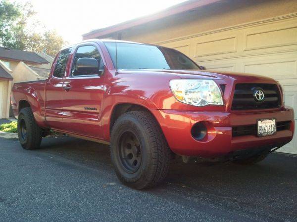

    Wheels
    ProComp 7069 - 15x8's
    Tires
    Yokohama Geolandars 30x9.5
    Mods to Fit
    Removed black box and 3mm spacer on front

    hey kdogg were the 3mm spacers necessary? your rim and tire sizes are pretty much what im looking to get when you first showed me your truck on a different thread except these [​IMG]
    98 Flt Blk 15x8, 5x4.5 Offset: -19mm Center: 3.18” BKSP: 3.75” will these specs fit in a reg cab?... same as access cab right?

    Yes the 3mm spacers had to go on otherwise the rim would not clear the caliper. im pretty sure a reg cabs specs are the same as the access cab
