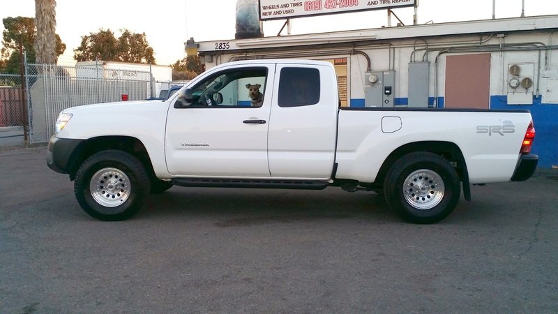

    Thanks for all the info and advice Ill think about running a spacer but I don't want to. I'd rather avoid turning full lock and wait to find more suitable rims. Im thinking 15" mustang wheels. They're 20mm offset and 7" wide plus i can find them cheap on Craigslist.
    Or I'll just spend the 500 for some proper alloys. I really want to avoid putting all that gear on my wheels to center and make them stick out further. But im sure I'll have to.

    Are you still running the stock lug nuts on those Accord wheels? I'm pretty sure that most Honda wheels use ball seat lug nuts and the Taco uses cone seat.
    You can probably get away without using the hub ring if you're careful tightening the lugs down... I got away with it using Odyssey rims on my 5-lugger. They were 16" with a 14mm cone seat style lug nut and I didn't have wobbles or issues with lug nuts working themselves loose.

    yes im still running the stock lugs and no issues. I take my truck to the dealer for service and they havent said anything about fitment.

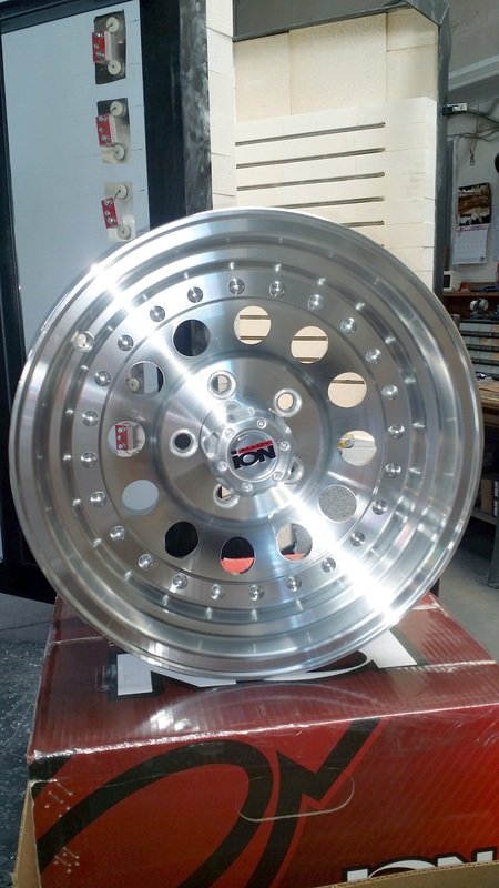

    But I just ordered some ION Alloy Style 71 rims so hopefully no more Accord rims:)
    I think i might need to get new lugs and for sure hub rings for the new wheels.
    Offset: -6mm
    Backspacing: 3.75"
    Bore: 83.06mm

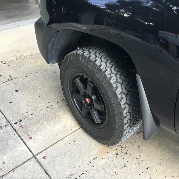

    Nice. What brand/color is the gray?

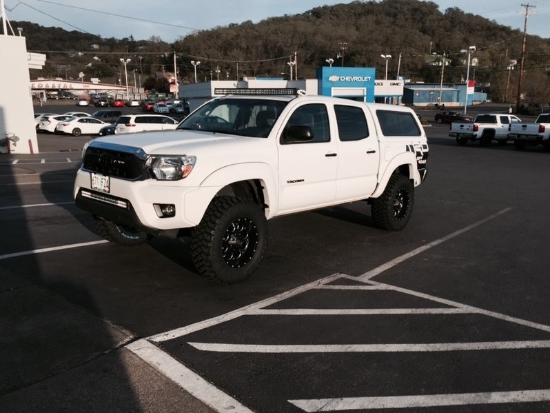

    Good luck finding hubcentric rings that are 60.1mm to 83.06mm. Haha. I looked everywhere for them since my aftermarket wheels have a bore width of 83.06, but couldn't find it. Instead, I had to order them from a website that makes custom rings which were kinda expensive :(

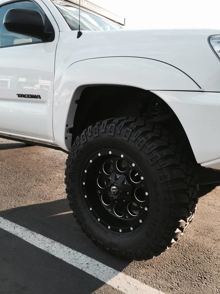

    13 TRD Off Road
    3" Rough Country Lift, 17" Fuel Revolver Wheels, Mickey Thompson Baja MTZ 285/70R17, Blacked out emblems, 30" Bumper Mounted LED Light Bar, Leer Canopy, LED Interior Lighting, TRD Grill Badge, OEM roof rails
    Fuel Revolver 17", Mickey Thompson Baja MTZ 258/70R17 (11.5 width, 33" overall diameter), Rough Country 3" Lift

  15. Dec 17, 2015 at 6:26 PM
    #175
    Rolis12
    Rolis12 Well-Known Member
    Feb 27, 2015
    #149720
    176
    Rolis12
    San Diego
    2015 5lug access auto
    Goodyear Wrangler TrailMark 31's. F.B's 2.75" spacer, TRD rear shocks, stub antenna, ripped out charcoal filter added AFE dry, Chrome grille, upgraded to SR5 sun visors, variable wipers, backup camera, HID DDM 35w 5000kv, ebay fogs w/yellow LEDs.
    Wheels installed and cleared the calipers!!!!!!:headbang:
    No more sway bar rubbing with my 31s!:bananadance:
    No hub rings or spacers! No vibrations... 85mph tested.:yes:
    Im a happy camper!:plane::woot:
    The Wheels:
    Ion Alloy 171 series.
    Offset: -6mm
    Backspacing: 3.75"
    Bore: 83.06mm
    [​IMG] 20151217_133803_zpsp2sxqgcc_399873d2e9bdae9f0792a6791f20646dfff12580.jpg

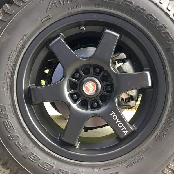

    B ill y
    B ill y Well-Known Member
    Jul 29, 2015
    #160546
    306
    Billy
    Sarasota County, Florida
    2018 4Runner Trd OR, 1997 FZJ80,1985 FJ60

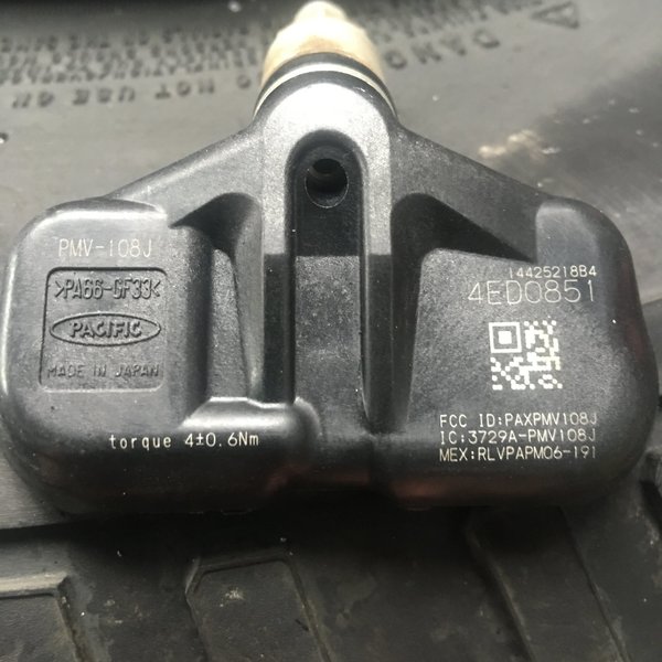

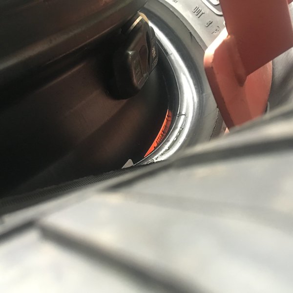

    There Focal X 16" with 235/70/16 . Might i add that I was able to use my stock steel rim tpsm sensors on aluminum rims. You can see sensor in one pic on the rim. the tire came pre installed from tirerack. with no aftermarket tpsm just a regular valve. I just broke the bead and swapped out the valves (No Adapter used) and no extra balance weight needed. And YES thoughts cool stickers i added. The center cap is a 3D sticker.
