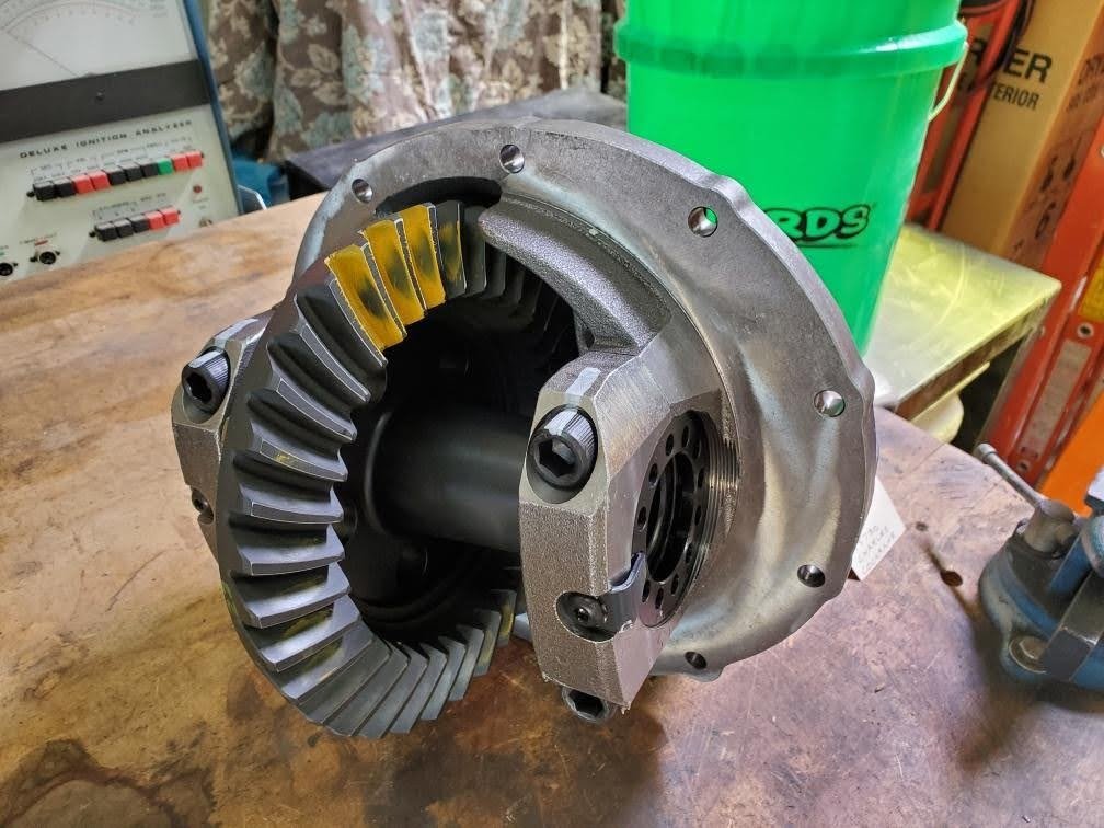

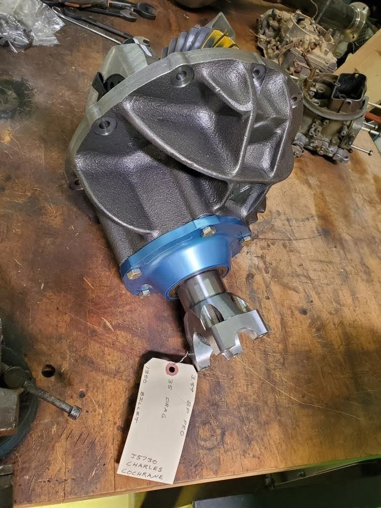

    This 9" center section from Quick Performance was $600 assembled and had high $$$$ parts . Billet aluminum center section housing , billet aluminum pinion support , billet 1350 series yoke and lightweight billet 40 spline full spool

  19. Sep 24, 2021 at 12:10 PM

  20. Sep 24, 2021 at 12:44 PM
    #20
    1999RegCab
    1999RegCab Well-Known Member
    Apr 4, 2014
    #127007
    1,522
    Cacti Land, AZ
    1999 Reg Cab, 2.7, 5 speed
    3-link SAS
    That’s a good price.
    wide is good!
    Those are good examples of the trend I’ve seen with those front steering 14bolt axles. Man, it’s insane. They can even do 4” tube with massive walls. As if a reg 14bolt wasn’t strong enough.
    Check Rhodes Diffs on Facebook. I believe he builds the same axles cheaper
