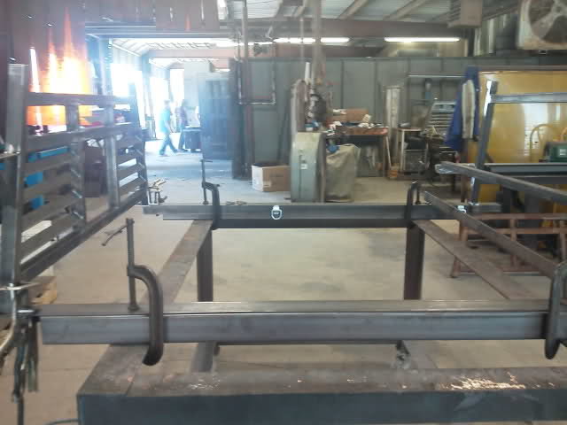

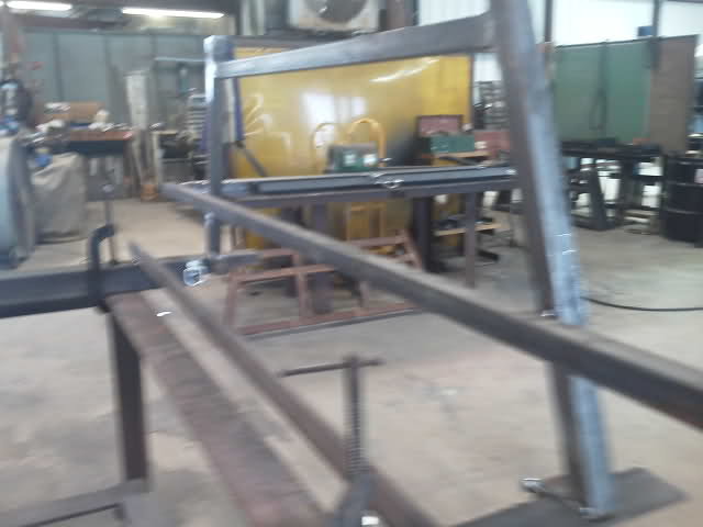

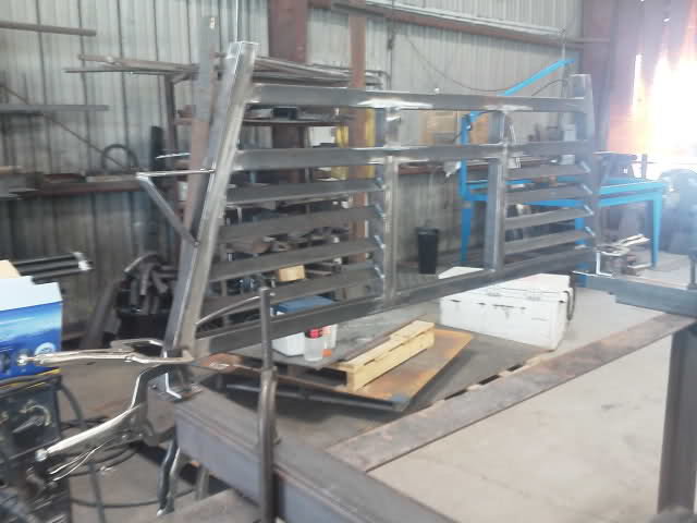

    So for a while now ive been wanting a Bed rack but nothing I have seen fits all of my wants.
    1. Full Headache Rack
    2. Back Bar
    3. D-rings Along the bed side, Headache Rack and Back Bar
    4. Light tabs on Side of rack
    The reasons why i need these is because Down here in South Texas, I do alot of fishing/camping Along the Padre island National Seashore. I had to have space for all of my Crap and My kayak took up alot of that.
    I recently got a front hitch made for the Front bumper to attach this bad boy
    Surf Mate Rod/Cooler Rack
    This is the only picture i have of it but it is mounted on the front now
    This rack put me into a dilemma because the width of it puts the sides right in front of my headlights and with a 120 quart cooler and 8 rods in the front. It knocks down my light output to about 25%. I pretty much cant see shit at night.
    SOO i needed lights but i cant put them on my bumper because thats where my rack is, also i cant put them on top because my kayak goes up there so i needed to put them somewhere.
    I decided to mount them on the Side of the Headache rack
    Let me know what you think
    I have a set of Hella 700ff Driving lights ready to be put on
    Only concern is how well the lights are going to work at the spot on the truck

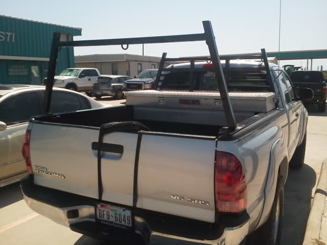

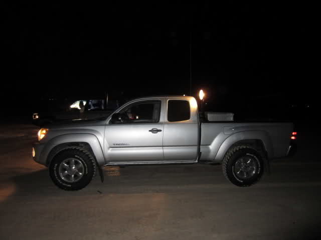

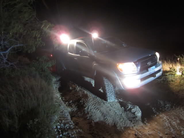

    Finally got this pics of her installed now
    Once I finished installing the lights i just had to take them out for a test run ;)

    Looks good! How do you like the lights mounted on the side like that?
