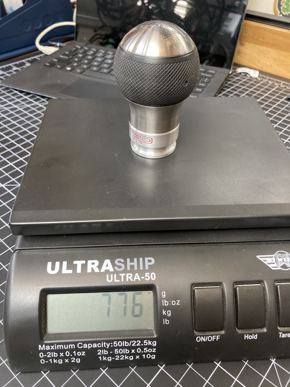

    So based on posted weights, I have stainless w brass core or something? Looks like solid stainless to me?

    No core in that one, solid stainless with the ring.
