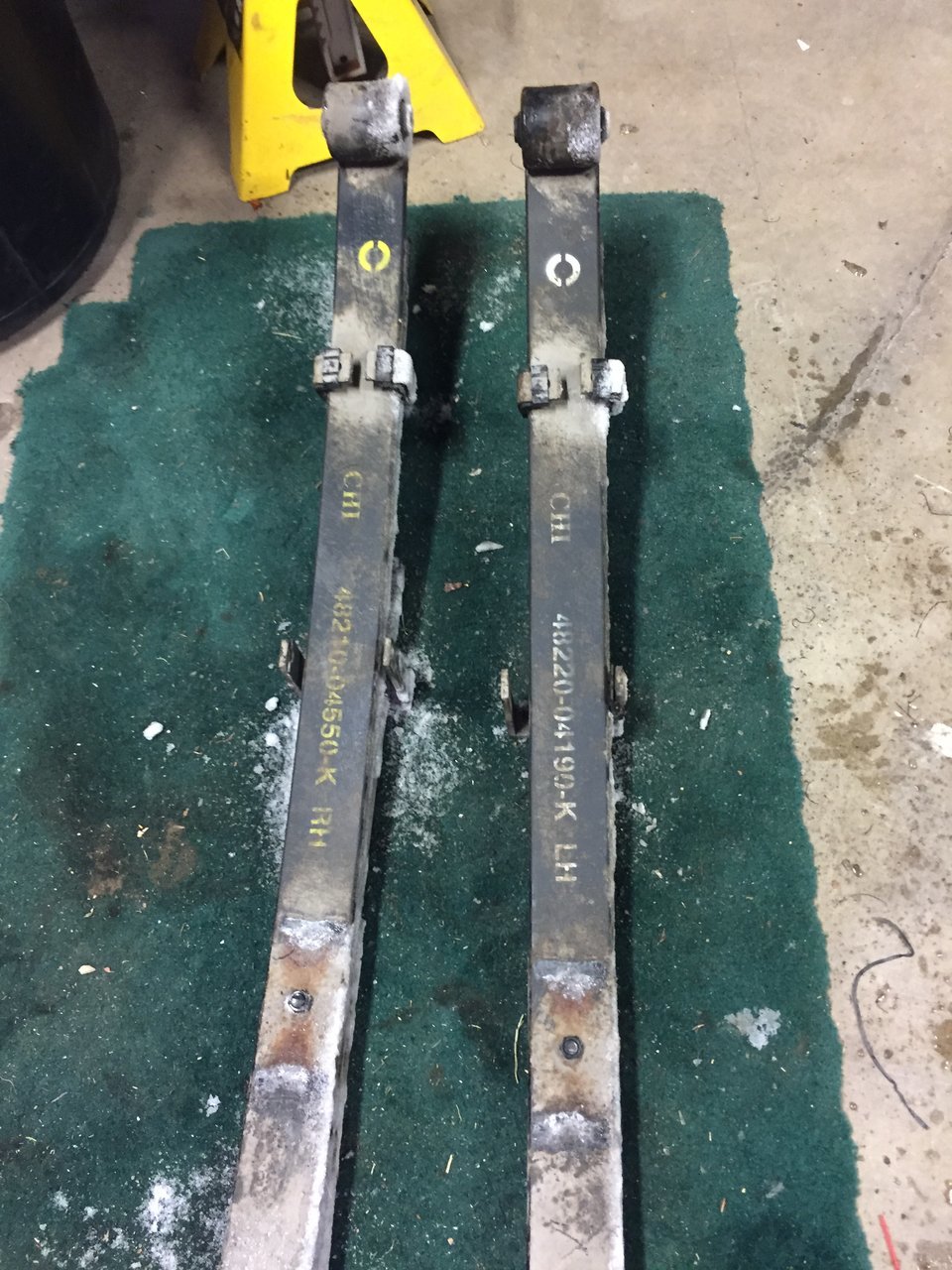

    So my leafs were replaced last week. Since I had a single leaf AAL on the old spring pack my dealership gave me the old spring packs so that I could remove the AAL later to reinstall
    Rather than just reusing the old AAL, which had pretty stiff ride. I decided to cut the old leaf packs up and use sections of it to stiffen up the new springs like a budget progressive AAL.
    I added one section of spring 29” long and was able to get roughly 1.25” of
    lift after a couple hours of setting. Ride felt soft and was not harsh like the Single AAL. Going to try and add another leaf to the pack to see if I can get a bit more lift and keep the ride quality.

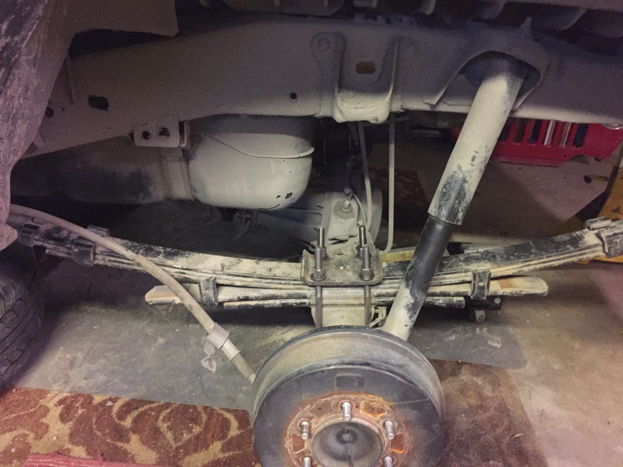

    I tried to drill the leafs for those same dormant isolators... but I blew through 3 bit for 1 hole and said fuck it its not wort the trouble for now.
    There are some adhesive plastic isolators on the new toyota overload spring if I could get my hands on 8 of them or something like it id be set.
    I ended up using both leafs off the old pack. The main leaf was cut to 35" (17.5 from center) the second leaf was cut to 29" (14.5 from canter).
    The longer leaf on top, then the shorter leaf. I left the overload depending on how much it settles I may remove it.

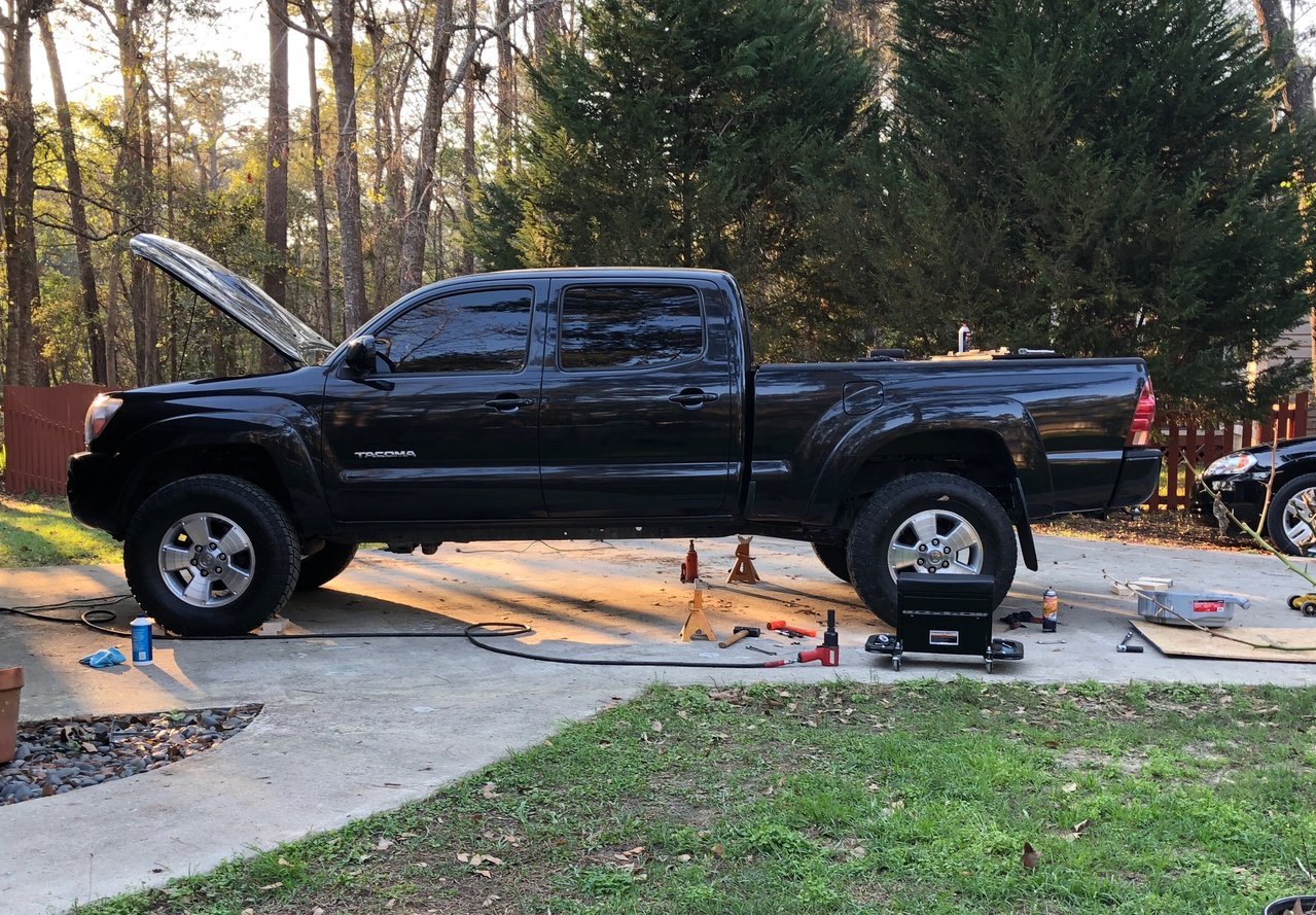

    Heres the truck about 30 seconds after installing the old leafs to the pack. It has settled 1/2" in a couple hours. 3" of lift up front wheels are 285/70/17.
