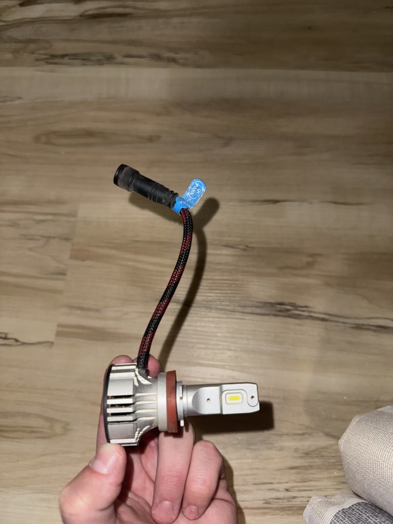

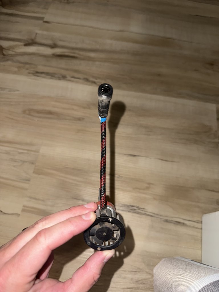

    I can’t seem to find a replacement for my 2022 TRD OR led halo headlights bulb. Has anyone ever seen a connector like this or can help me find a solution?

    Can't help you with the bulb, but those definitely are not OEM

    OEM housings? If so, unplug the adapter from the OEM wiring and install h9s. You’ll get warmer color temp but infinitely better performance

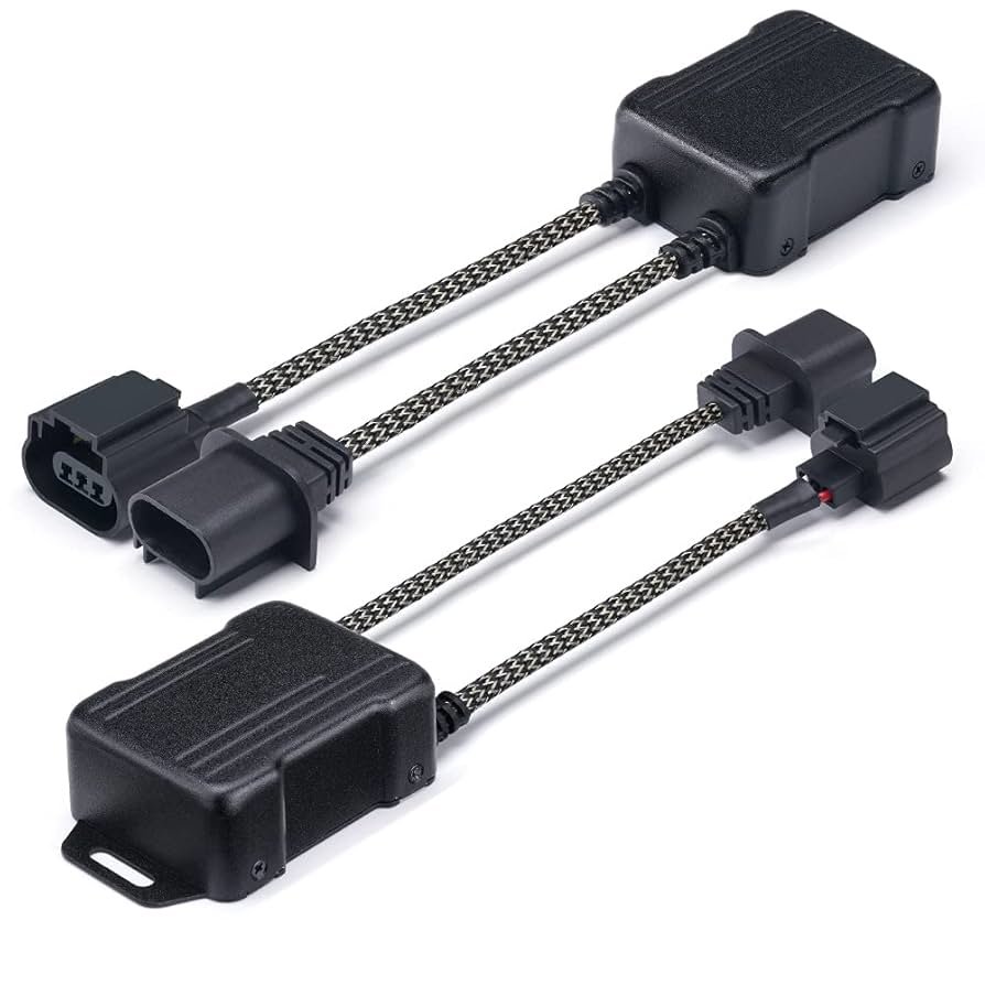

    That's not OEM, and there should be another box between the connector and that headlight. It'll look something like this. Keep going back, and eventually you'll get to an H11 connector.
