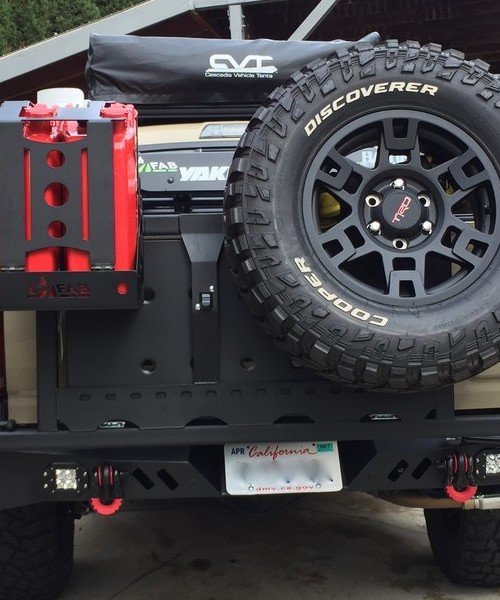

    I got mine from C4 Fabrication and I don't see any reason why it would hurt anything. It bolts up to the same holes the stock one did and has stronger struts. The only thing is, on the model I ordered, the hitch receiver is behind the license plate so it's a little inconvenient to work with but I don't tow very often so no worries. If anything, the aftermarket receiver is stronger and better made than the original.
