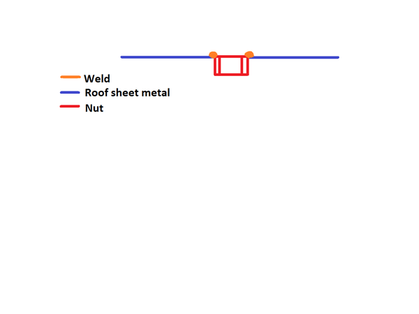

    New plan thanks to the help of colinb17, gonna drill holes and weld in some bolts flush with the sheetmetal in the recessed rain groove on the roof so it is both strong and easy to bolt and unbolt the rack. When the rubber rainguard is in place there is literally no way to tell.
    that will be the next step after the basket itself is complete

    Just posting up the picture I sent you in case someone stumbles upon this thread later on and is trying to visualize what you're talking about....
    Note: bead should go all of the way around the nut if feasable. only drawn as two tack welds for visualization purposes.

    It's going to be hard to drill the rain rail if i recall correctly that's where the main cab supports are like a roll bar almost.

    Build thread in sig... 4-link long travel
    I drilled it to run extra wires without problems. it may be more substantial directly above the a-c pillars, but i drilled nearby to the factory roof rack holes and want to say it was just double layerd sheet steel.

    just saying be careful especially if you have side curtain airbags.

    this is true. i don't have have any of those goodies, but i did tell Brad in a pm to pop down the headliner before any drilling because there is stuff tucked up in there.

    in my truck that's where the wires to the 3rd brake light run
