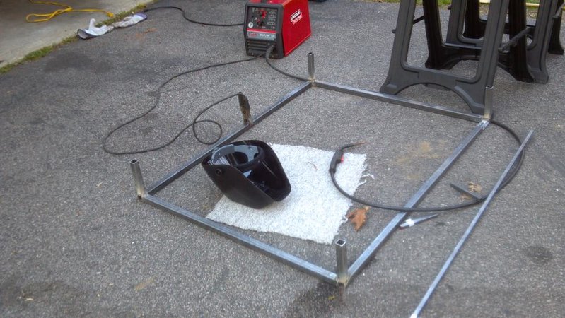

    pic #1 - welded on one 1" piece of tube to each of the corners

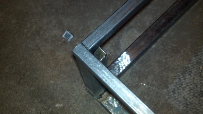

    pic #2 - shows very roughly how the basket will be reinforced with vertical pieces of tube

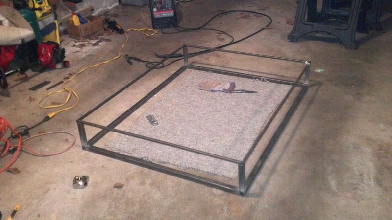

    pic #3 - What I have now. I am going to add two 6" vertical support pieces (Like in picture 2) of square piping, per each or the four sides, to connect and strengthen the top of the rack to the bottom of the rack (hopefully) that explination makes sense to you guys)

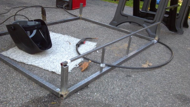

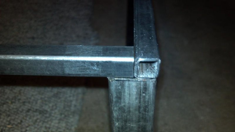

    pic #4&5 - shows how close/tight I got the pieces of pipe to fit together, dont want any gaps when I run the bead
