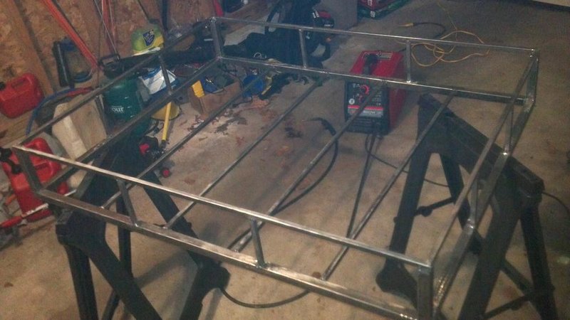

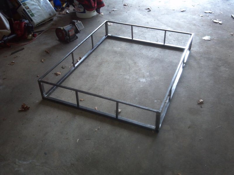

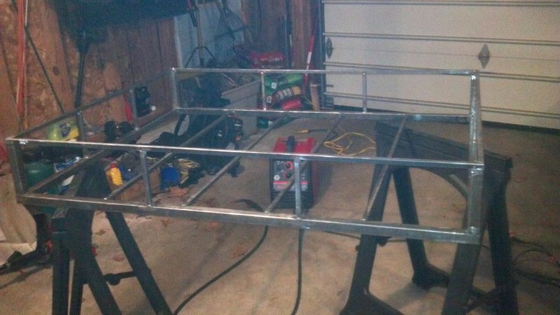

    ok so the basket is almost all done - progress in the past couple days
    - added two vertical supports per side (four sides :)) to secure the lower and upper part of the basket
    - decided on doing the 'base/floor' of the basket out of more 1/2inch square tubing, and did 4 of them evenly spaced (windshield to back of roof) direction if you know what I mean. got that all welded
    -last thing i need to do is get some stainless steel mesh to weld up under the 'floor' tubing, to make sure nothing slips off the rails on the bottom of the basket and dents or scratches the roof
    just need to wire brush and sand the whole thing after the mesh is in then I am going to spray it with three coats of Rustoleum Bedliner spray
    pic#1 is the vertical supports before i positioned and welded them
    pic #2&3 just some shots with everything welded and cleaned up a bit

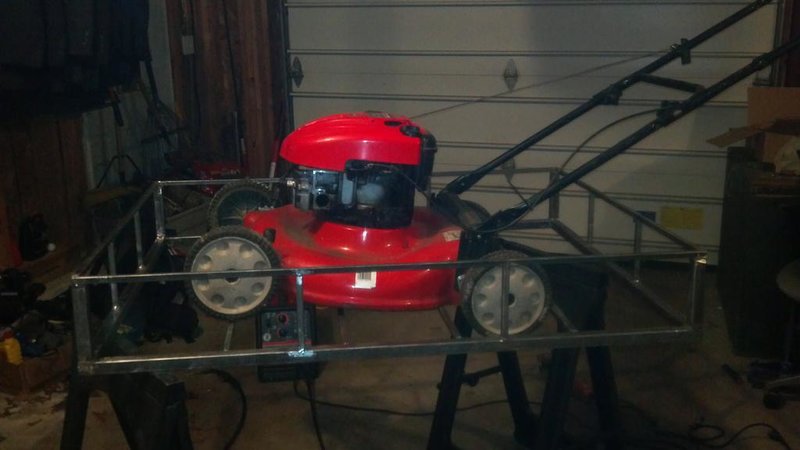

    pic#4 - strength test, leaving this 50-70? lb lawnmower in the basket overnight to make sure nothing bends cracks or fails
    LET ME KNOW YOUR THOUGHT FELLOW TACO BROS:p

    capacity-wise it is 46in wide X 36in long x 6 or 8 inches high
