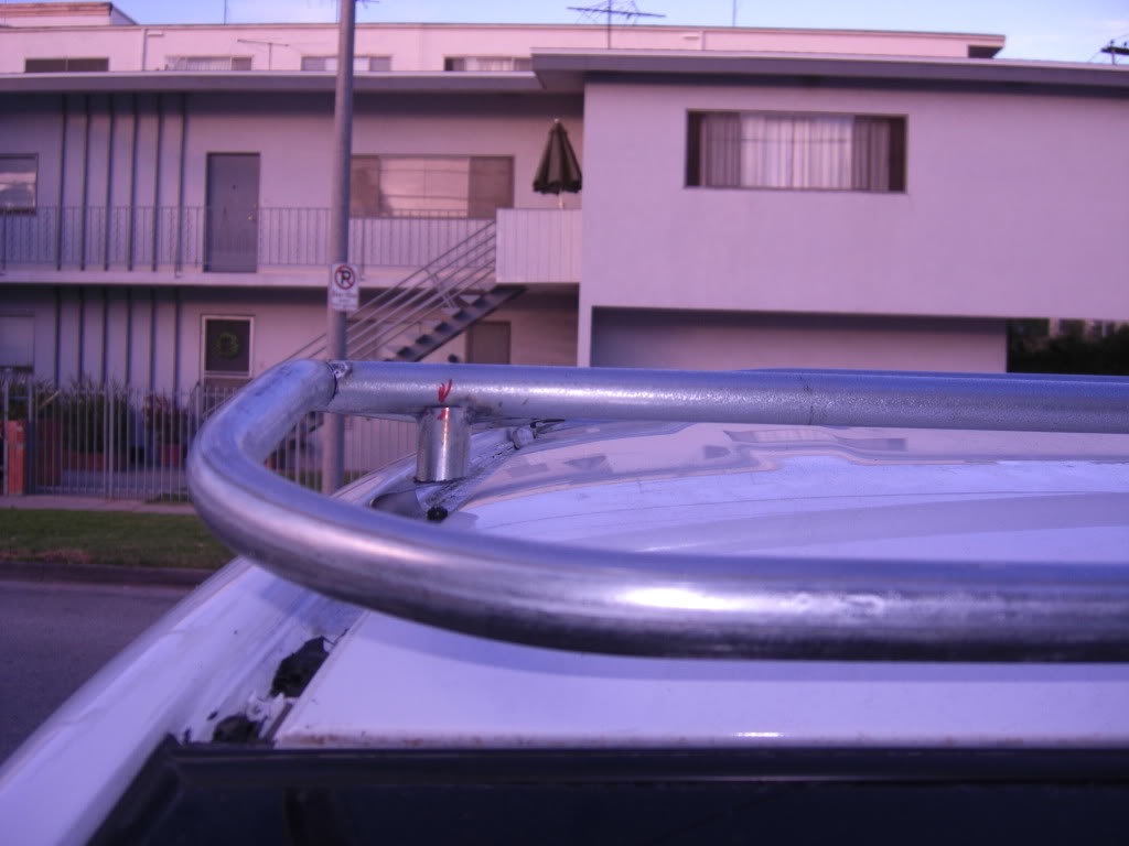

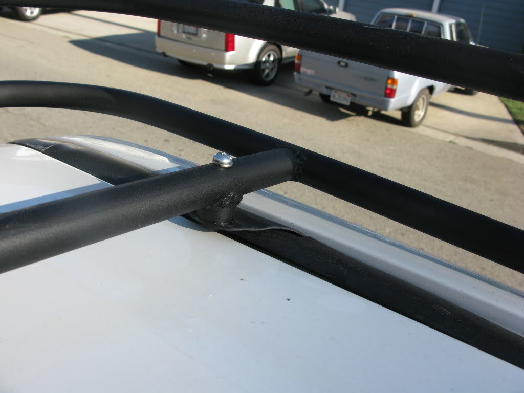

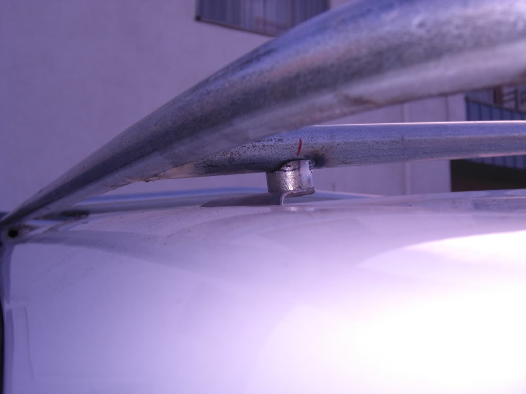

    Thanks. Here's the only pics I could find. Some are in process shots. Please excuse the crappy looking welds... that galvanized shit is tough (or maybe I just suck). I found some rubber insert/washer things at the hardware store that fit up in the tube great and stick to keep from scratching the paint off the mounts. It's pretty simplistic, but it works.
    And in case it isn't clear, there are nuts welded to the underside of the mounts so you can just drop a screw down through the rack and tighten it down. The mounts stay on the truck all the time, but they're so low profile they are virtually invisible.
