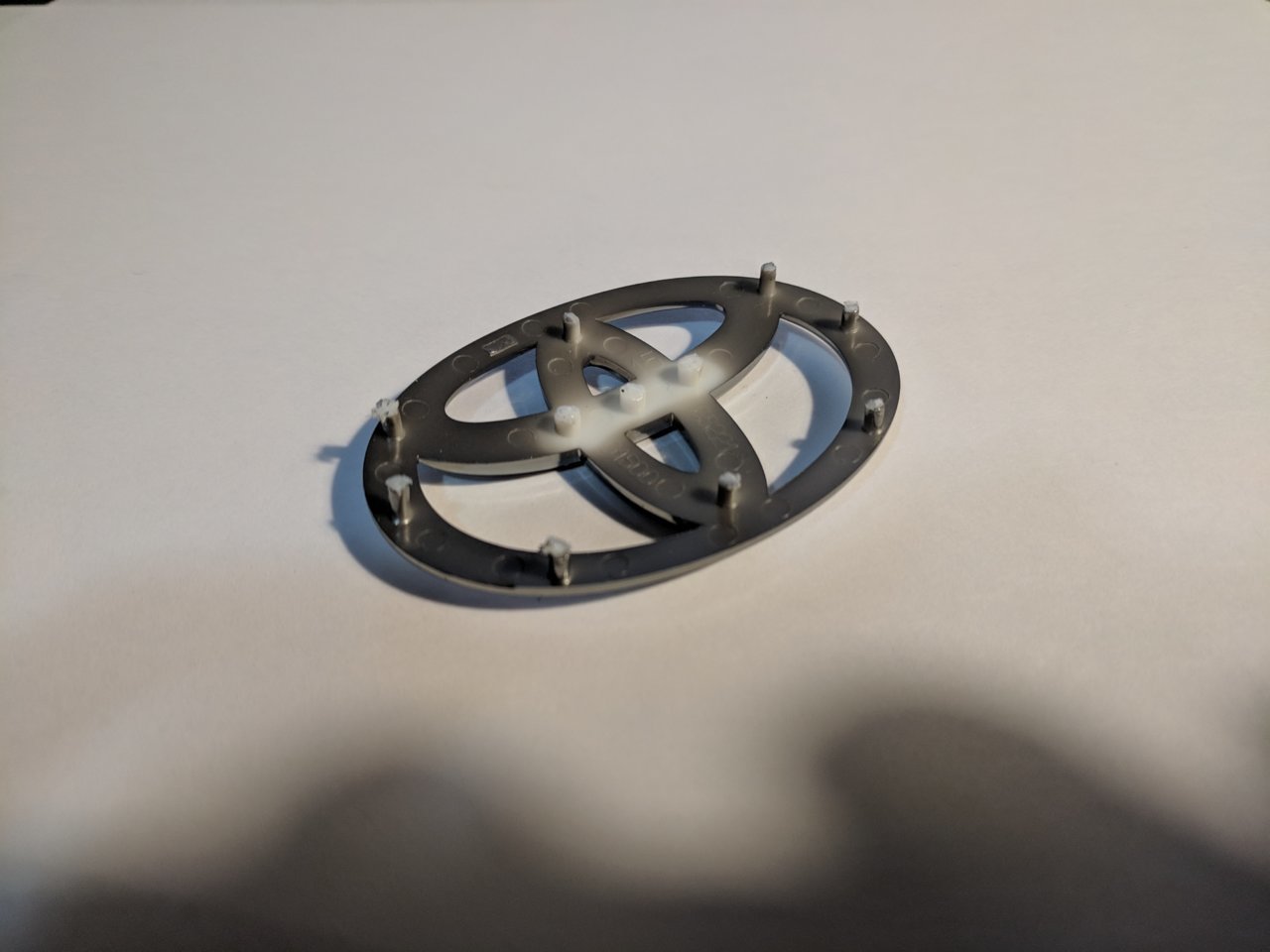

    Well it's printed, but I replaced the whole logo. It was just pegged on there so it can be put back if I ever decide I don't like the retro thing.IMG_20181130_140353.jpg

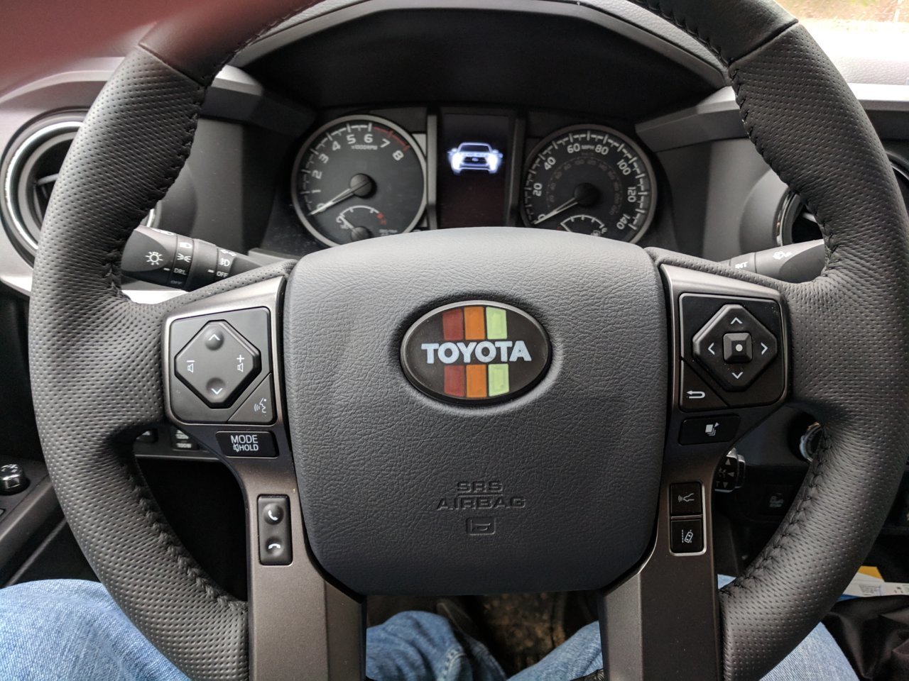

    Well, yeah I guess so :anonymous:
    I like the retro thing.

    Yeah, they are pegs, but they are melted on the back. I just took some flush cutters and snipped them until they were narrow enough to fit through. If I put it back there is still enough meat to melt it back on, but I'd probably just glue it. Pulling the air bag was no big deal, two t30 screws gets the whole front of the wheel off. then 4 8mm bolts removes the airbag. It stays in a nice little package and goes right back in when done. If you didn't want to pull the airbag, and didn't mind adhering it back on, you could get it off without pulling the airbag. the emblem is actually rubbery, so you wouldn't break it if you pulled up an edge and got behind it with some flush cutters.

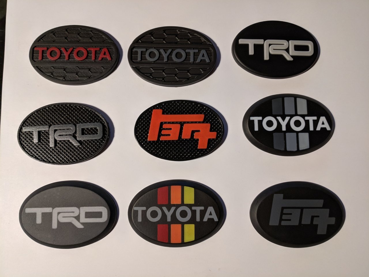

    something like this?:D give me a couple days to get some more hot car friendly filament and I'll post a couple up in the marketplace.steering logo v3 v1.jpg
