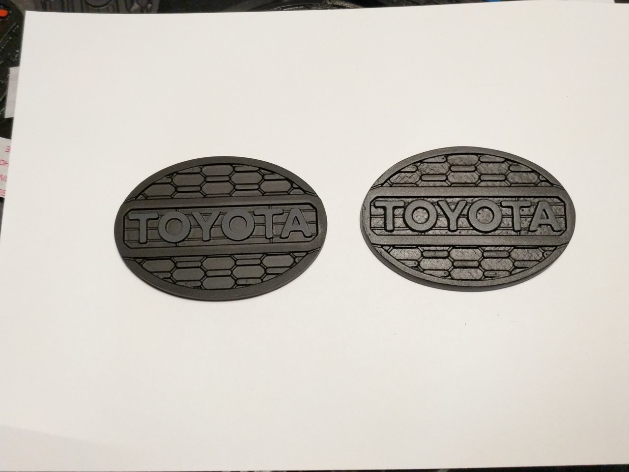

    I see, thanks! Leaning towards the smoothed one.

    I go back and forth, side by side, smoothed looks better in my opinion, but the texture actually matches really well with the interior.
    Keep in mind that textured one didn't pass my QC. it's just all I had for the photo.

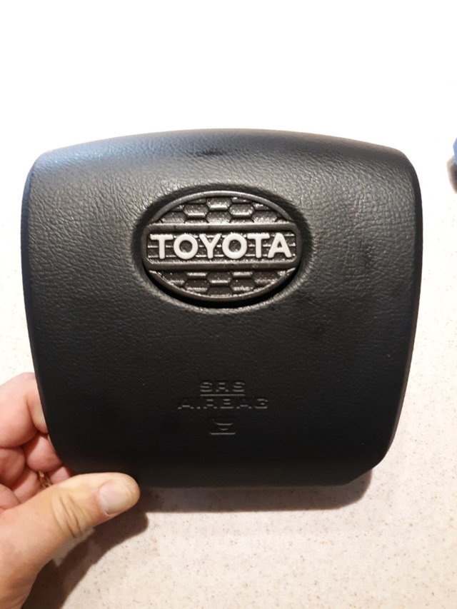

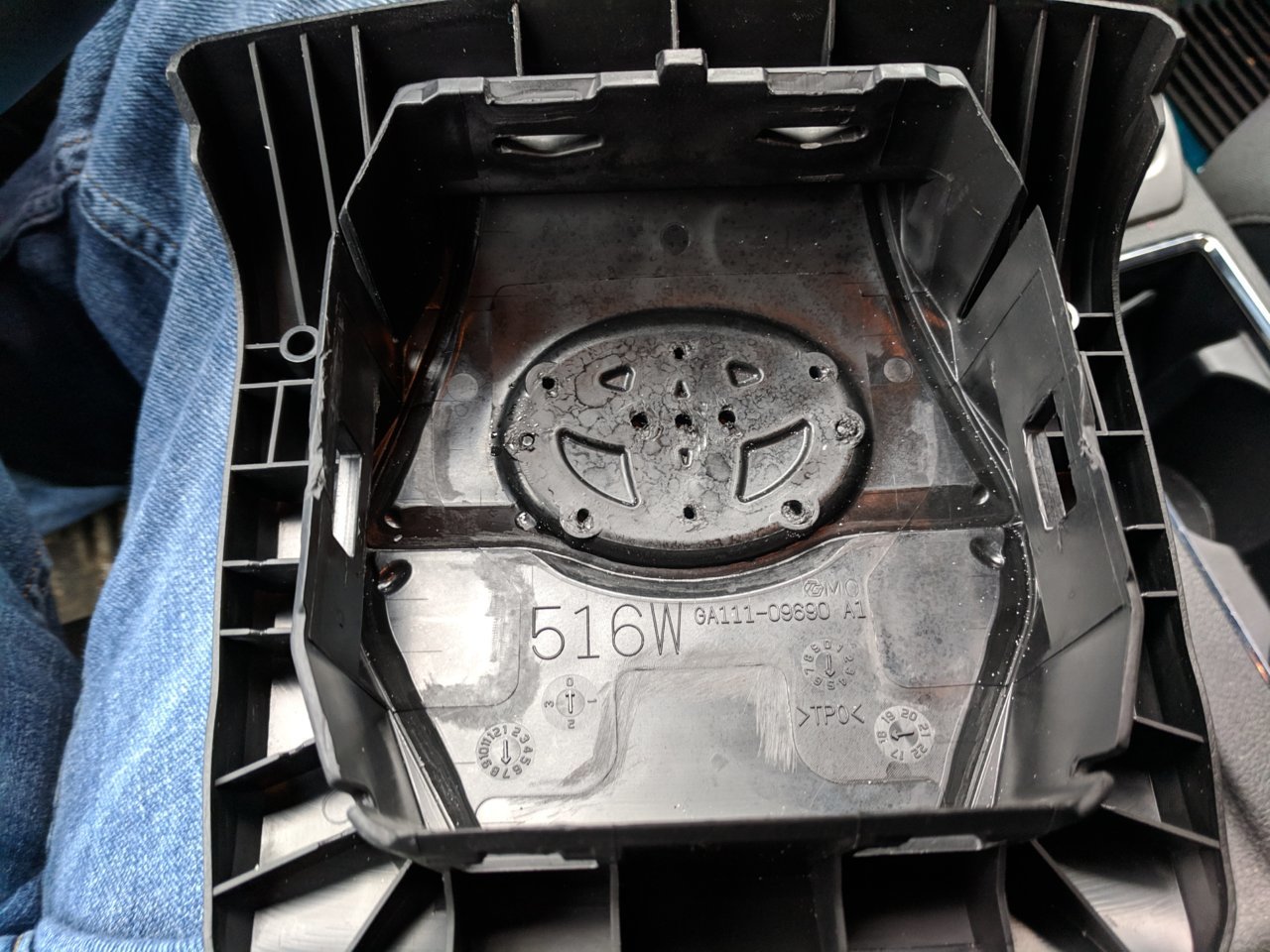

    .. so when one removes air bag and is left with steering wheel face plate and are at the last step to remove the original Toyota emblem.. what method does one use to remove emblem? Does the logo pull out cleanly leaving the 6 holes clear or does one need to drill to clean out?

    I used a small pair of diagonal wireccutters to nip the melted ends off from inside. They're surprisingly pliable to pull out and cut and the holes are clean.
    Once the emblem was removed I used a dremel to level the inside of the oval so the new badge sits flat. It doesnt sit flush but it is somewhat recessed.
    I used clear silicone adhesive to attach, let cure for an hour or two then reinstalled.
    Once fully set I cleaned up any extra glue that was visible.

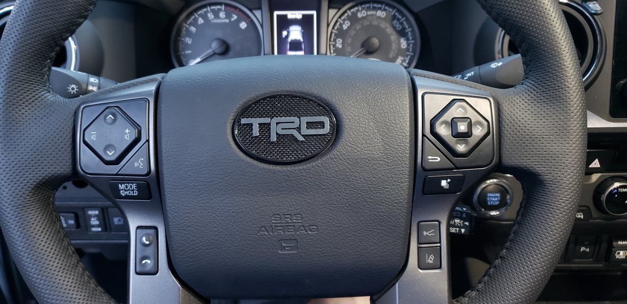

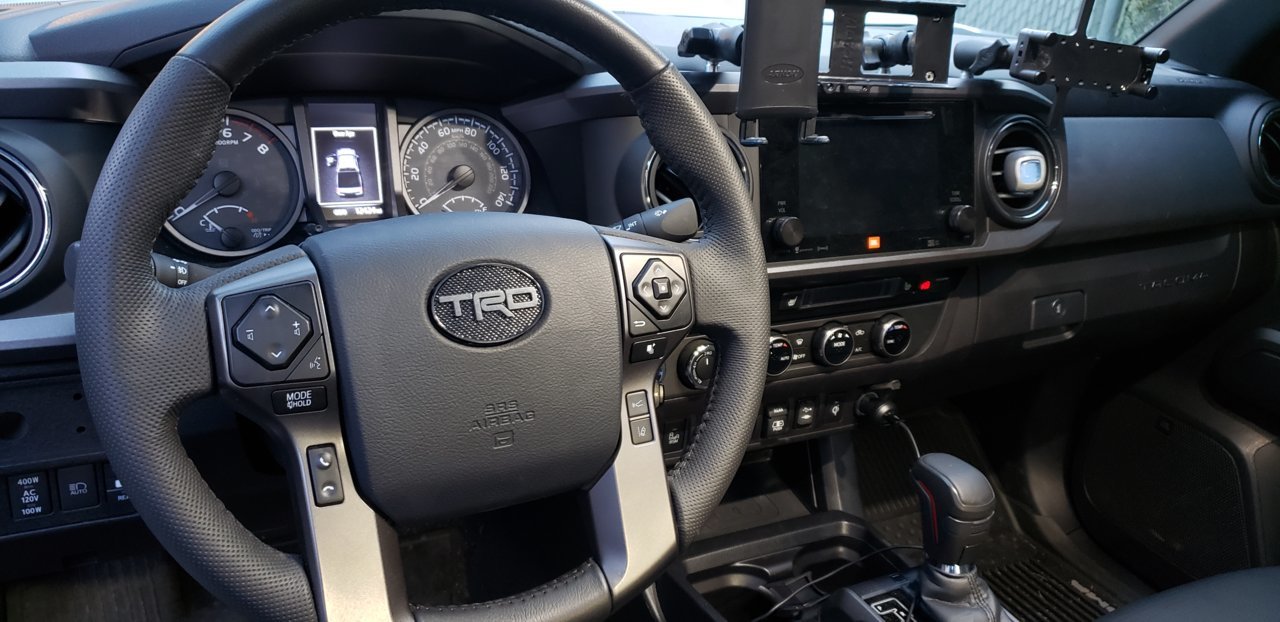

    Installed last night, really happy with it!

    - Audio: Alpine 5-Channel Amp Alpine iLX-F309 Halo 9 Stereo Unit Alpine Tytpe-R Speakrs (F/R) JL Stealthbox - Exterior: BackFlip MX4 Bed Cover Bed Extender (OEM) Bed Mat (OEM) Bed Step (OEM) Bed Lighting Kit (OEM) Emblem Blackout Overlay (OEM) Meso Gasshole Meso Ultimate Turn Signals V4 Predator Tube Steps (OEM) Redline Tacoma Hood Struts QuickLIFT PLUS Roof Rack (OEM) TRD Cold Air Intake (OEM) TRD Pro Exhaust (OEM) TRD Pro Grille (OEM) - Interior: Center Console Divider (JDMCAR) Center Console Tray (JDMCAR) Covercraft UVS100 Custom Sunscreen Glove Box Organizer (Vehicle OCD) Meso Tacoma Coin Tray Meso Ultimate Dome Light Meso Ultimate Map Lights Taco Garage DMM Mount TRD Pro Shift Knob (OEM)
    Super slick taco brochacho!
    My biggest hesitation is the lack of video/picture handling the removal of the original toyota emblem. Any feedback you can provide would be greatly appreciated! (As well as any other helpful tidbits of info)

    Looking good. Going to have to get one of my own.

    Thanks. Removing the toyo emblem was very easy. With Small Diagonal cutters you can cut off the melted ends. Then comes right off.

    Thanks for letting me know. I get to tackle this in the next couple days I appreciate the feedback.
    What type of bond solution did you use?

    I'd also love to know how you guys are holding these on? Might help me fine tune the designs.

    I ended up using gorilla crazy glue to bond the 6 pegs to the emblem then used a lighter to melt the pegs on the opposite side to the steering cover, just like oem.
