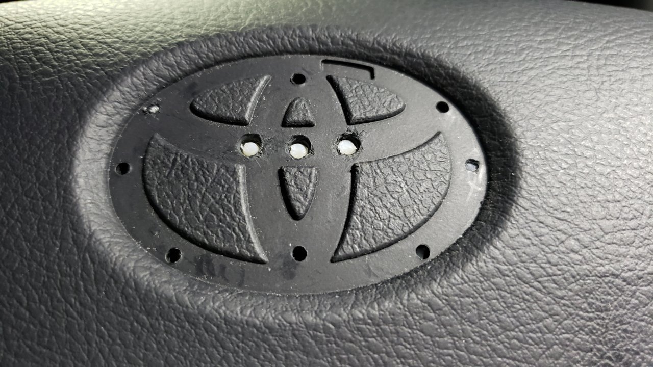

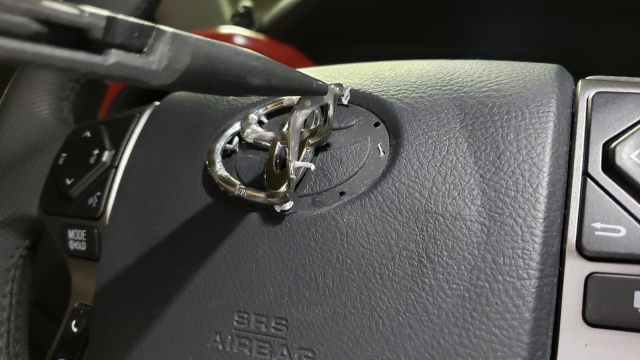

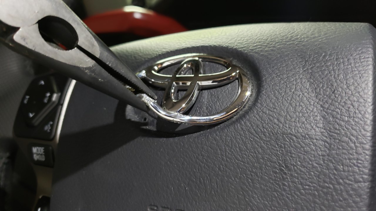

    On the 3rd gen emblem is a soft flexible plastic. I used a long nose plier and carefully pull the emblem just enough to use a nipper nail cutter, some of the outer pegs are pulled out easily but the 3 middle ones are little bit thicker..
    e6000 glue did the job.. Very solid adhesion and didn't even use the pegs for alignment and pretty center though..

    Yep...It was actually really easy. Have a small pair of wire snips and a plastic wedge to pry up.

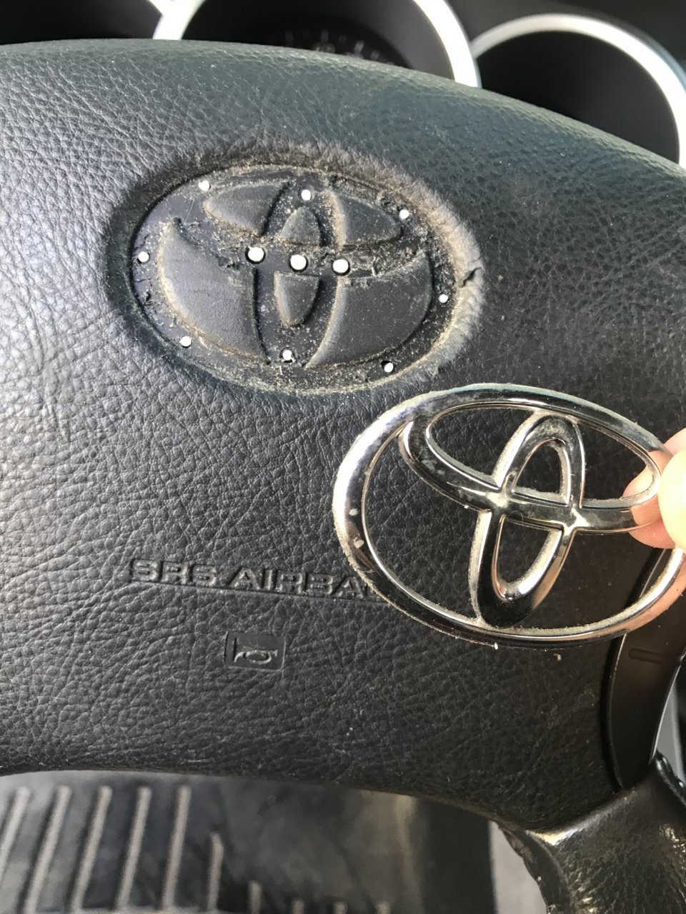

    Second gen if you want to remove it without damage you’re gonna have to drill the airbag rivets. See my post a few pages back. These emblems beat the hell out of painting the stocker.

    really? i cant pull it back and cut it like the 3rd gen?
    should i just rip it off and buy another one? there are ones on ebay but they are $25.

    got my emblem off

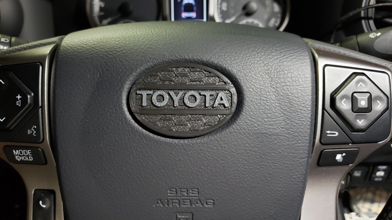

    @JimmyRigged88 The Pro Grille style one I grabbed from you awhile back I have yet to install. I was just looking at it today and noticed there are 6 holes total; 3 on left and 3 on right, but the filament you provided only fits in 2 of the 6 holes :-( Is it safe to try and drill the holes larger? Or would applying bonding to the backside outer-rim be sufficient enough?

    The pegs are not necessary, I like them because it helps hold everything nice and centered while the glue cures. And you can melt them on the backside to have a less permanent way of holding it on there. You can drill it out, just be careful not to go all the way through. Usually it's just some flashing around the hole and can be shaved off with a knife or exacto.
