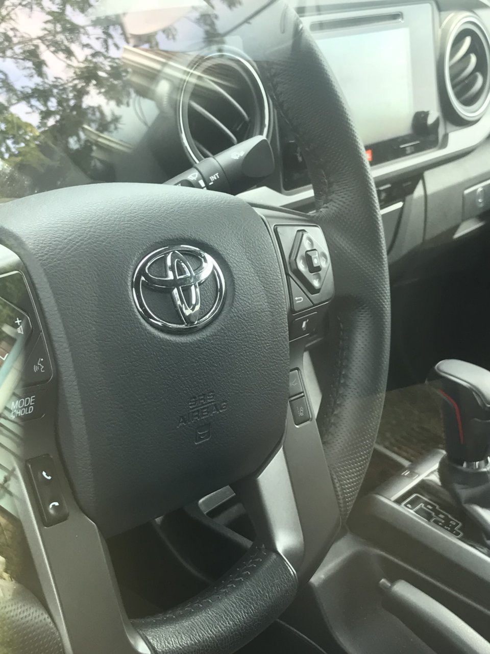

    I’m not replacing the emblem, just want to take it out; hydrodip it a diff color/pattern. And put back on as original. It just pops back in right?

    No.

    With a small dab of glue?

    The clips (that’s what I call them) are permanently attached to emblem. They have a “L” type shape to them that go through small holes in airbag cover

    Yes

    Ah so I think I get what you’re saying. If I want to remove it and be able to snap it back in, I’ll have to remove the cover. Otherwise I’ll be cutting the actual mounting/snapping clips off? Just wanting to be double sure

    I destroyed my Toyota emblem when I removed it

    The “clips” are a permanent part of the Toyota logo. I have no idea how to remove the Toyota logo without destroying it. The logo seems to be a somewhat flexible plastic.

    If you plan on removing airbag, I would disconnect negative battery terminal

    How did you do this? Did you take the airbag out and remove the emblem that way, or did you pry it up, clip the tabs, and just glue it back on?
