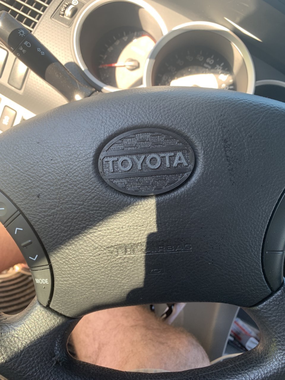

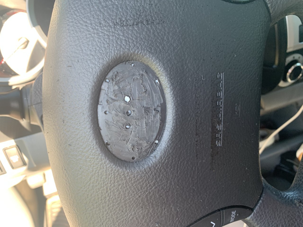

    Got mine installed today. Sanded the middle out using my dremal tool. Used two alignment pins one on each end. Used jb weld epoxy for plastic

    Looks great!

    That’s how I did it. Then cut the alignment pegs short so they sat down in the hole enough to align it

    Thanks man. Anyone on the fence about this don’t be scared. Product is top notch. Fit and finish is spot on. And I got the unfinished version. Love it

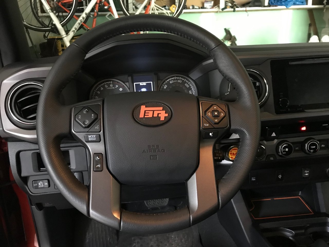

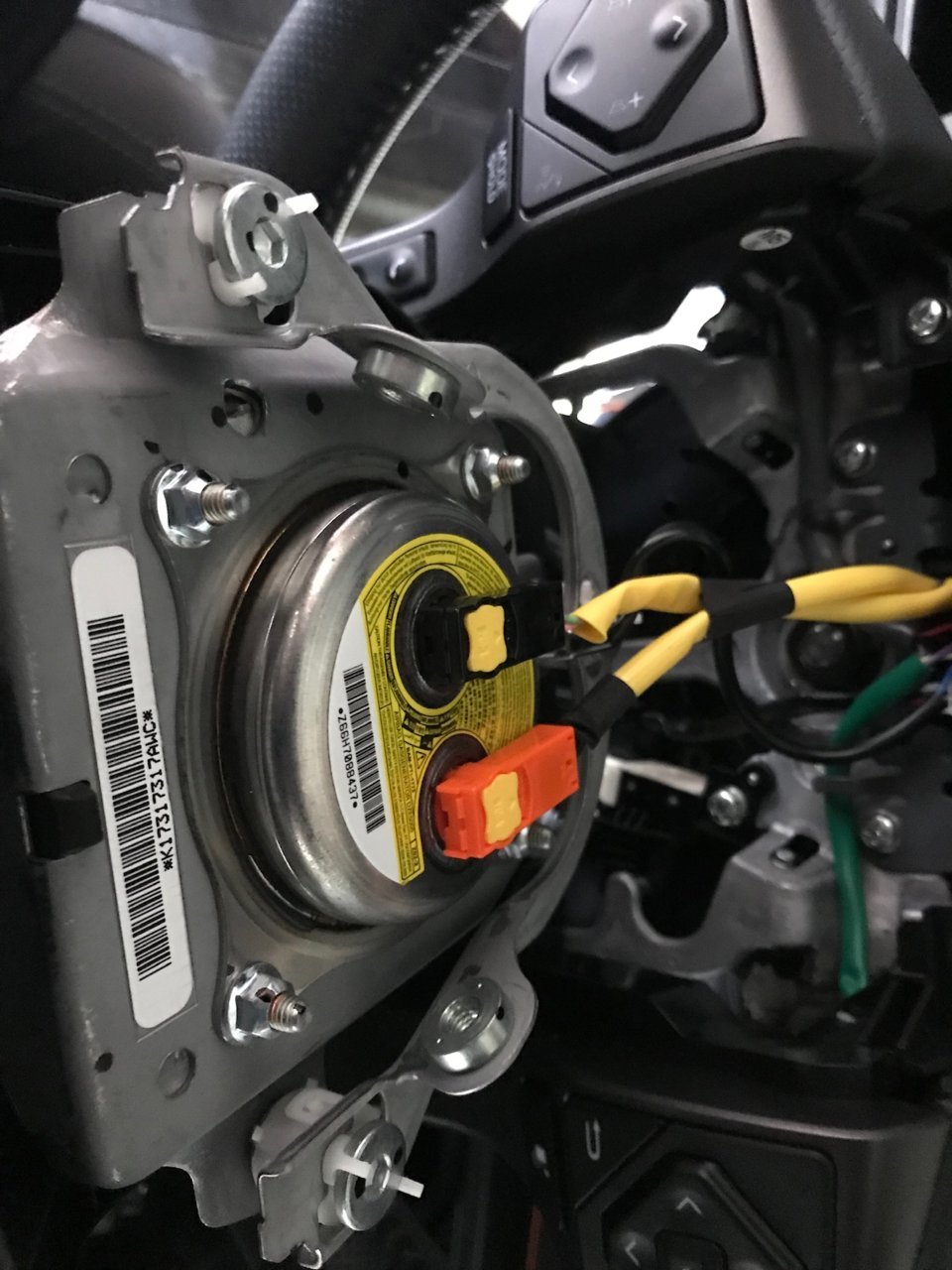

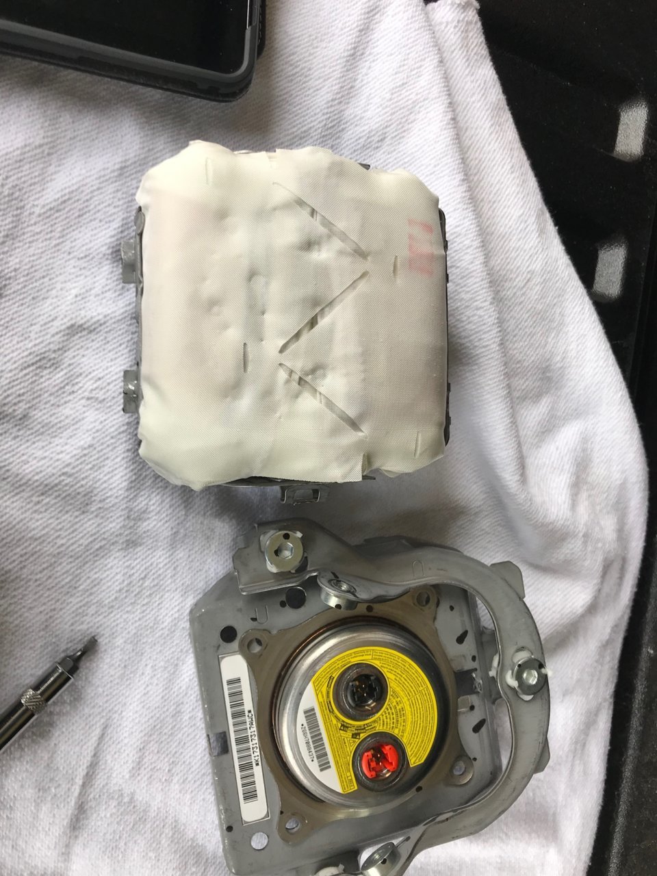

    Disassembled the steering wheel and applied the new emblem earlier this year. Once you have a game plan, it’s a piece of cake. Still, when you see that airbag, you get that “holy shit” moment.

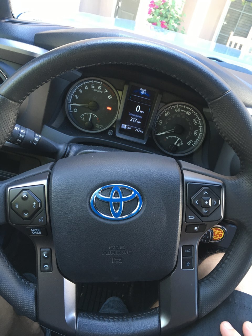

    I am looking to replace this... but at least it isn't full chrome in the interim :bananadance:

    what did you use to cut pegs?

    That is where I was. The sticker was nice, but not good enough.

    I used a razor knife
