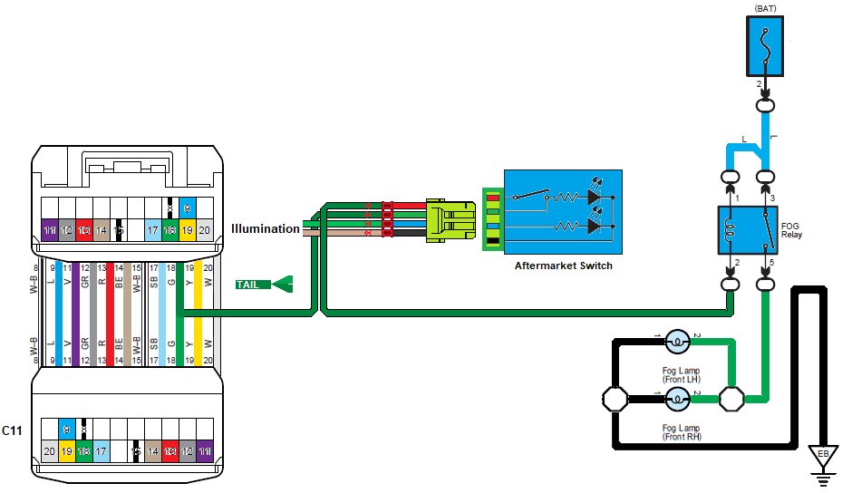

    Your truck should have the fog light wiring. All you’d need is a adapter from 9006 to the ssc2 connectors
    The wiring for the truck should be complete from the dash to the fuse box to the lights. Just needs. Relay and switch

    My truck already has fog lights, I just wanted to bypass ECU control, though maybe that happens before the stalk?
    But, yeah, I could just cut and crimp on deutsch and be done with it.
    I am planning to ditch the pushbutton switch if I can get the stalk working and use that and the blank for my seat heater switches.

    No ecu control. The fog circuit gets 12v on the high beam side of the headlight, when highs are on the fog switch has 0v which is why it turns off fogs. I put a 12v ignition power wire to my fog pin on the switch and now my fogs can be turned on whenever the key is on. Independent from the headlights

    To add the switch it’s plug and play, you just need 2 pins to make the fogs work you’ll just have to add those 2 to whatever relay you use
    corsa technic sells the pins that are needed

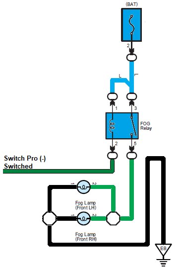

    Hope it's okay to idea dump here.
    I'm considering running a 2nd set of fogs. White and yellow.
    I'm thinking a harness off the battery with relay tapped in to the low beams for the white fogs so they are on with low and high beams.
    Yellow would be on the factory wiring, unavailable with high beams. This shouldn't be an issue since I can't imagine a situation needing high beams on in adverse weather.
    Thoughts on this setup welcome.
    EDIT: remembering I have a switch pros, I guess I can just program a switch for the whites based on the lo beam trigger wire

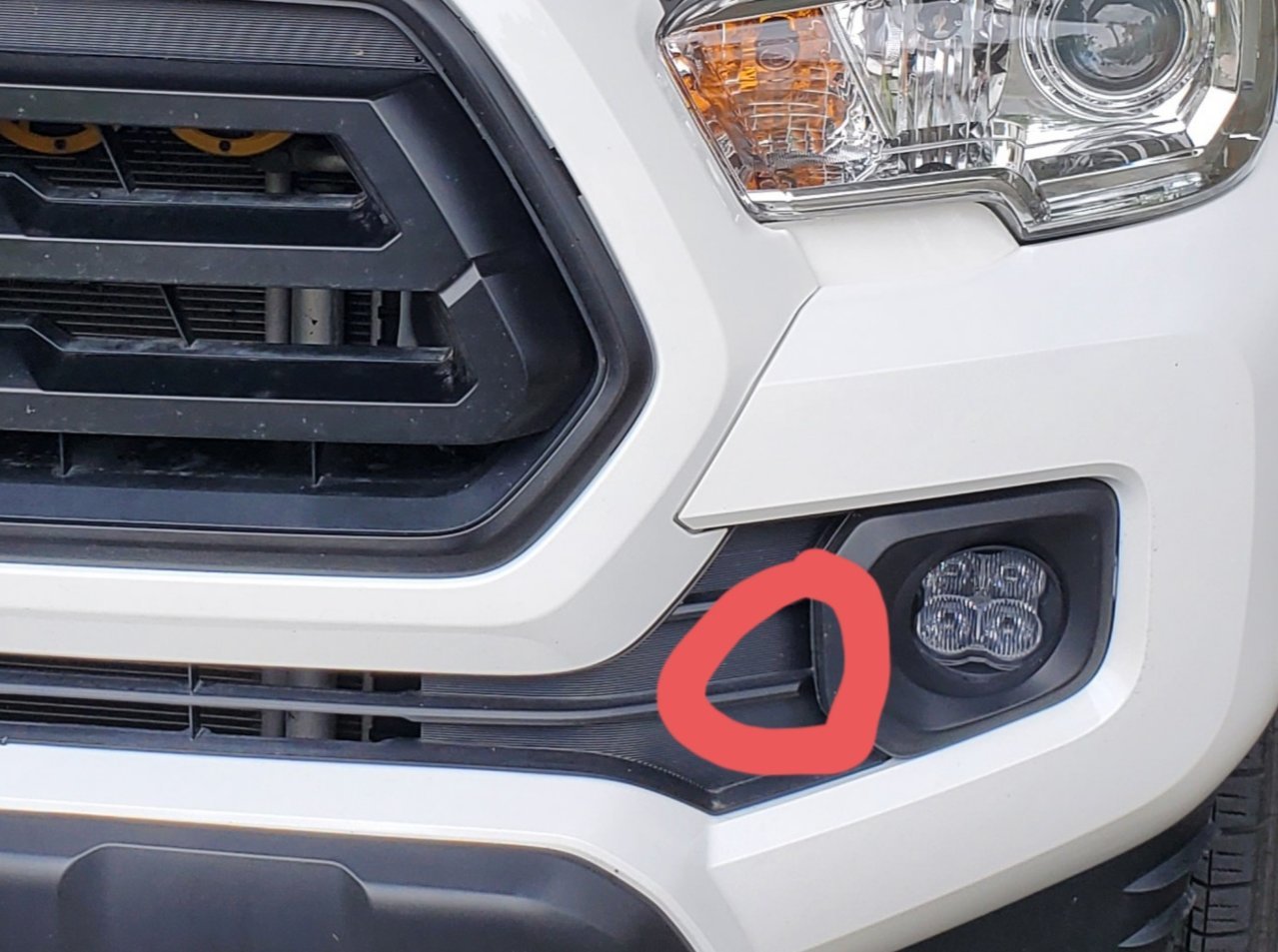

    My original thought was trying to shove two sets of SSC2s in the factory location, until I compared the output to my current white SS3 pros.
    Also consider flush mounting in the the valance cover or the chin spoiler.
    I think the best spot would be here though with some fab work involved.

    For those without SwitchPro:
    Added Fogs available after TAILS are selected with added switch for OFF. (Will stay ON if Light Stalk switch left in TAIL position and added switch ON)

    We'll see, still have not settled on location. Pretty sure I'll end up with dual fog setup though :notsure:
