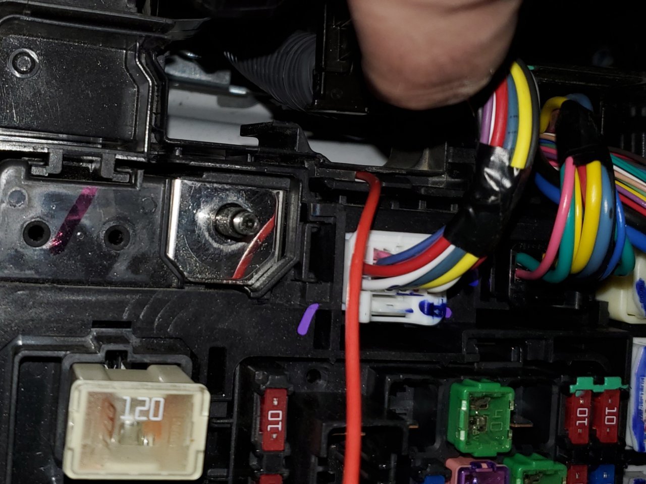

    For reference, you can get into the fuse box with drilling or cutting. If you want more details I can do that tomorrow.

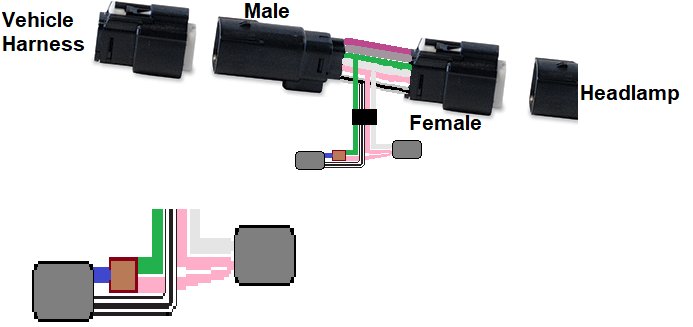

    First off, let me rewind and say how brilliant you are to be thinking about the rapture.
    ok, on to specifics. I have 14 gauge amp now. And I have 4 position amp. So I’ll do one four banger T then split to two x 2 outputs. One for Switch-Pros triggers and one for rapture lights.
    Now I just need time to get started.I’m rather behind still. I’ll put it on a piece of paper with your name on it for now.
    @caribe makaira, want to draw it up? MX-150 T to 4 position amp on white, pink, lt green and ground to two 2 position amp, one w ground + diodes on park and DRL, another with high and parking light.

    Here is what I think you want with some future proofing for the rapture should you decide to prepare.

    Yes, this is just what I was envisioning.
    You are the man!

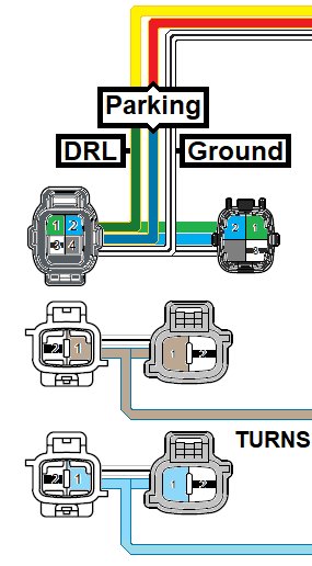

    There a 6 wires on MX150...seems you are missing some wires there.o_O:burp: Or is that the 4 wire DRL, Tail & Ground connector of the Pre-2020 Taco?

    Turn and low beam would appear to be useless for any aux use and are therefore configured as direct pass through.
    I could see two turn taps being useful for feeding flashers. However I don’t have any 5 position AMP so I had to choose. I might buy some 6 position AMP and standardize the LED T’s and pre make some. Just adds to bulk though.
    The low beam signal is particularly useless.

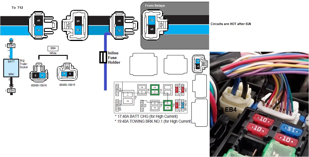

    The SwitchPro can be configured to use a negative signal which can be tap at C11 (there's a T for that)

    Definitely not my taste but yes we can tap turns and ground as well as DRL or combo DRL and parking light. Just don’t have anything for accessory other than add a fuse to the main fuse box or relay.

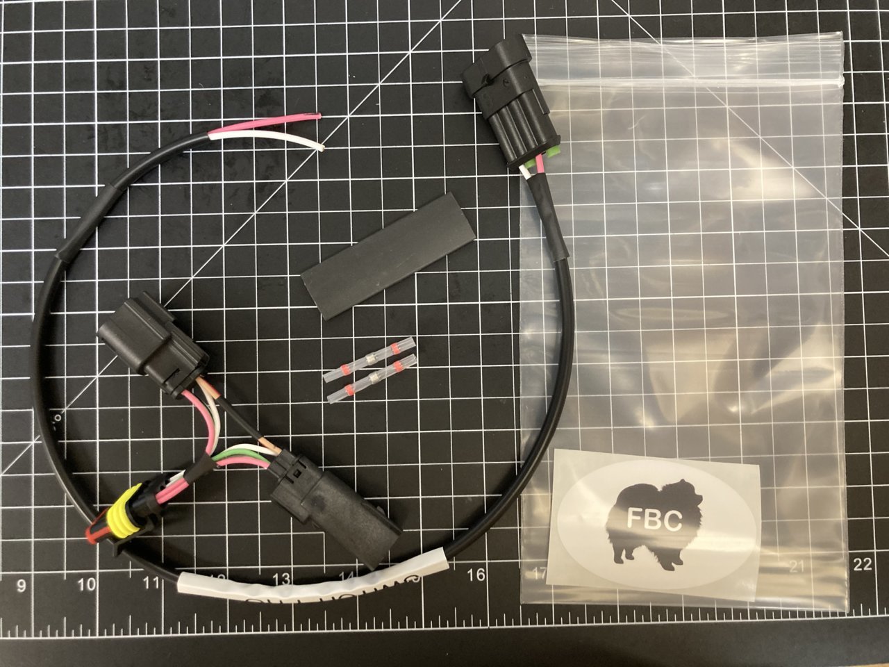

    Hit me via DM if you want this, I think I already have your address somewhere so we just gotta figure out the price tag and we're done? Assuming this is what you want for now?
    We can adjust down the line, the AMP 4 position isn't an overly expensive connector so if we have to toss or recycle that one, no big deal.
