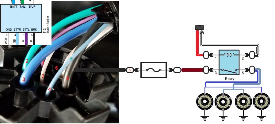

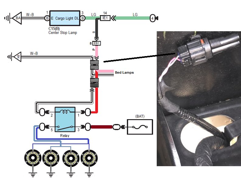

    Sent @ktbell444 's harnesses and @Dean62 's DIR, then moved @Dean62 's bed light harness to a custom harness and that should probably go to the back of the line. It'll be a bed light tap to engine bay relay to feed 10 cyclones as we want to minimize the power run but he wants to avoid going through the firewall to tap the cargo circuit.

    2020 has the bed circuit, use it as a signal.

    Yes that is the plan. Just a long 2 conductor run for relay coil signal.

    Tap the juice with fuse to Battery Charger Circuit on Tow.

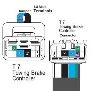

    Battery in this case just denotes always on.
    If he doesn't use an electric brake module, then the jumper connector there, so there's always juice on that circuit at the Tow connector.
    All plug & Play...except for the towing circuit tap.

    A jumper connector to T7 for HOT circuit at the Tow connector in the rear bumper.

    Disconnect T12, De-pin terminal 5, remove terminal, crimp new terminal with seal and additional wire. Re-assemble.
    https://www.bmotorsports.com/shop/product_info.php/products_id/3334
    only the terminal is required.

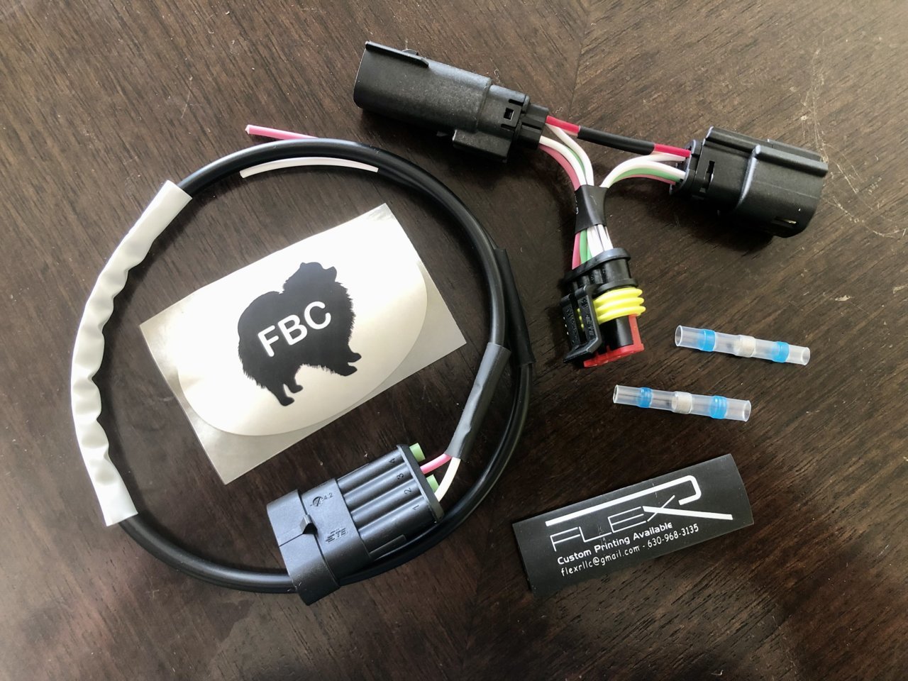

    If I made a grille light tap for you, yes. But I have to go comb through my DM’s to remember what I made for who. I really wish I had a photographic memory.
    oh, look, picture right there. Yes. Same as what I just sent @ktbell444
    Well, a smidge different. 4 position instead of 3. Same basic idea.
