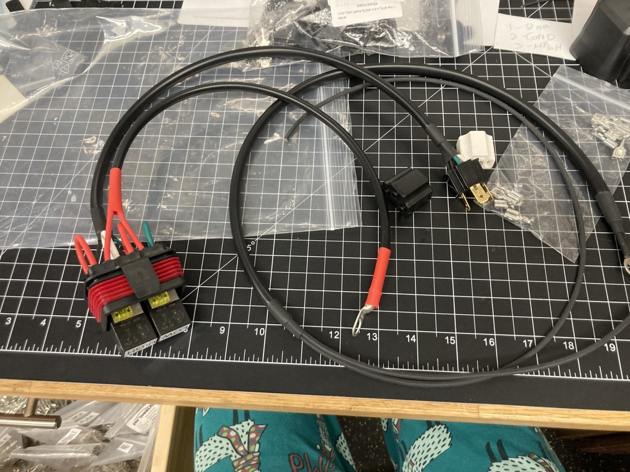

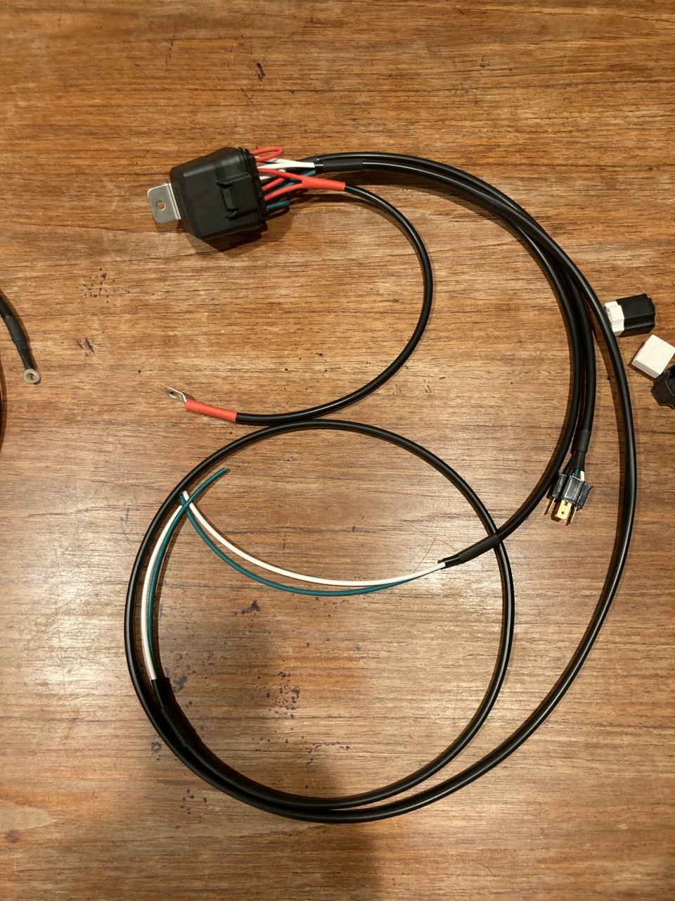

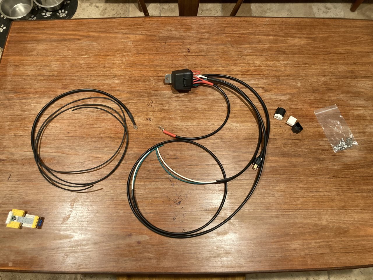

    OK, I *think* this is the last schnag b/c it's all but ready for the final H4 females and UAT. But, there is a snag. Fortunately it's only 12/9 so not quite 12/25, still time.
    I can't get 3x12 gauge into the PVC I have on hand. I can do 2 but not 3. @Puppypunter might have a magic trick for me (should I try the wire lead? Will it work? It's so very tight, I'm just not sure. Maybe I'll see.)
    I'm thinking I _might_ need to do one of these:
    1. Use loom and tape (and oh how I hate my taping job but still)
    2. Buy some bigger PVC (digi-key is fast on shipping but it is the holidays, still, decent chance this shows up in a week)
    3. Have completely independent power and ground with power supplied from the relay bank and ground supplied via one hoop to 2x12 gauge. This means independent arms for power and ground, it might look more octopus than you'd want.
    Let me grab a photo of where it sits right now.
