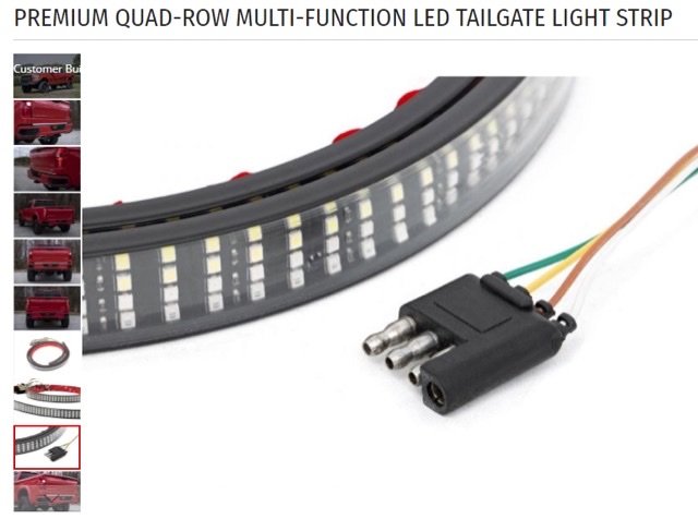

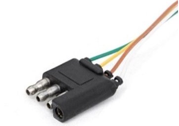

    @Jeff Dartfrog, that would require tapping the 4 pin towing connector, not the passenger side light harness only. Stop & Turn (tow), TAIL and ground.

    For the tailgate light strips, yeah, tapping at the 4 pin connector provides the combined signal of turn + brake on L and R sides. It would be swell if we could T tap at the 7 pin connector but I don't believe we have located a solution for that other than perhaps a gooseneck extension cable that you could cut up and install behind the bumper?
    Mostly it's some some time and research and experimentation which I don't have the bandwidth for given sales volume of my "on menu" products.
    And then there's also some part of me who doesn't have a ton of affection for the tailgate strip. But at the same time, I have an exposed strip on my 2002 Tundra now due to a new bumper so I am warming to the idea of putting something there which could be useful. I think I'd prefer a L and R pair though and if I got there I'd want to do it as an integrated part of my custom tow harness.
    But all of that is super back burner b/c I don't tow and I'm too busy with the stuff people have already paid for.

    I use the curt one and have it tucked up out of the way. Pretty much all of the light bars have some sort of logic to sort out turn vs brake vs hazard. Only hiccup I've noticed is on door lock/unlock when parking lights flash once the light bar thinks it is brake. Hazards flash amber as expected. I have the split putco blade.

    No, that is very incorrect.:smack:
    Tapping/using the signal from the towing circuit doesn't separate the TURN from the STOP.
    Anytime TURN/HAZARDs is selected, you get your "hiccup".:burp:

    Could you explain further? Turn and hazard always flash amber and brake is red. Or do you think the first flash is always red followed by Amber flashes?
    Edit: Just confirmed that hazard and turn are Amber on all flashes. I have to assume it's a timing thing where the the long signal from locking the door is detected as brake whereas the turn and hazard signals are detected as turn and hazard as expected.
