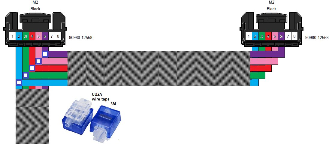

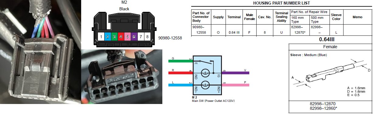

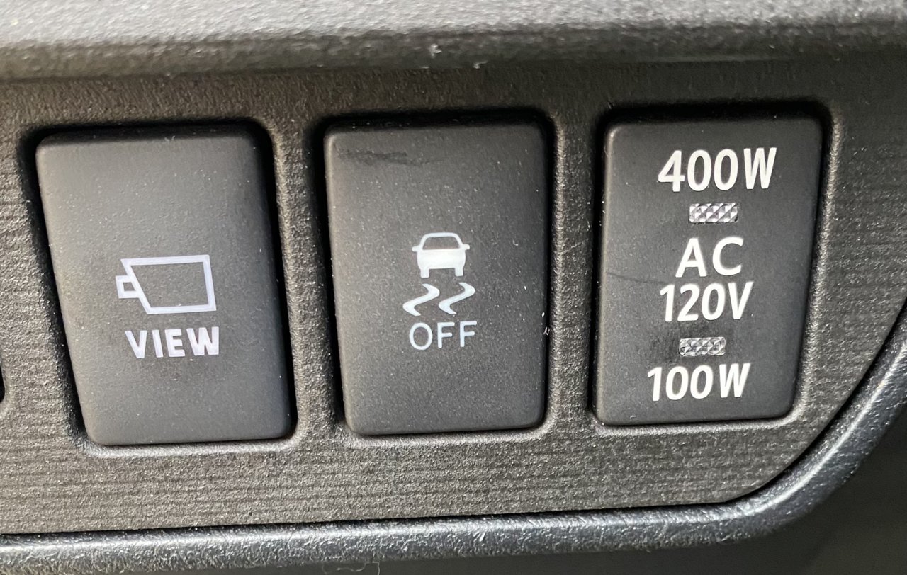

    Can you make a harness to move the traction switch or the inverter to below the stereo?
  8. Jul 12, 2021 at 9:01 AM
    #68
    daveeasa
    daveeasa [OP] FBC Harness Solutions
    May 14, 2020
    #328079
    7,446
    David
    PNW
    2016 Tacoma OR DCSB 6MT, 2005 RC 5MT PreRunner, 2002 Tundra SR5 RCLB 4x4

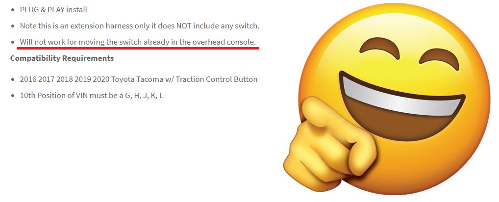

    Inverter relocation has been researched but AFAIK, there is no mating TE male connector which does wire to wire. I had thought of moving mine as well.
    Traction control I haven’t looked at specifically as mine is in the overhead.
    @Puppypunter can fact check me on this.
    My recommendation would be to either leave things as is and maximize spots in the cubby with a MESO 3D printed one or cut and extend with color matched wire and butt connectors.

    From left to under the steering wheel it’s a different connector and is indeed feasible (full plug and play). It’s the overhead VSC off that doesn’t have a mate, however @caribe makaira and I found a solution for that one using R44.
