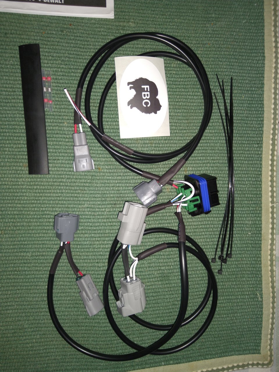

    Well, actually, @Zumozuzu7 I think I have finished most of the crimping for your harness.
    I need to source relays. And I think there is a mounting bracket for the fuses which I also need to source. Then it’s just the pigtail to your scoop light off the 3 pin weatherpack.
    @Puppypunter see anything I could do differently? I didn’t like my initial single fuse so I went with 3, a pair of 30’s for the lights and a 1 amp for relay coil power. For symmetry I fed from 3x12 gauge into a single 8 gauge ring terminal at about 14”. Had to use some of the synthetic lube I bought a ways back to get 3x12 through the PVC. I guess I could have set up for a pull vs pushing but hopefully there is adequate length in all directions.
    Any questions? I have no idea how to mount 4 relays, I’m thinking some sort of aluminum bar?
    The two circuits should be 100% symmetrical in all aspects, the only differences are in trigger wire (orange vs pink) and the output pigtails (pictured is for ditch lights with short and long feeds, not pictured is the scoop light which should just be a single. The symmetry gives some clean redundancy and allows an easy switch swap or output swap for any reason.

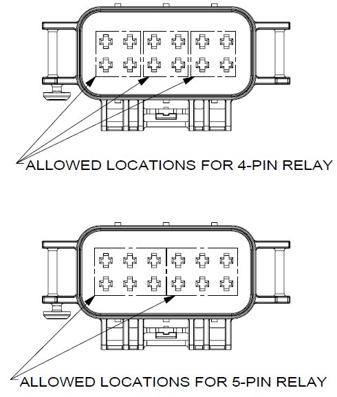

    Yeah, I really wanted to do a single 24 pin GEP. That enclosure is clean but I needed 4 relays rather than 3. It would have worked in the GEP with two SPDT and two SPST plus 2 fuses and do a tiny 22 gauge jumper off each main fuse for coil power. That was my hope and dream but the 24 pin GEP remains unobtainium.
    Form factor wise, it’s definitely less than ideal to have to mount 5 different things. I’m assuming @Zumozuzu7 is capable of dealing with that headache for plug and play wiring.

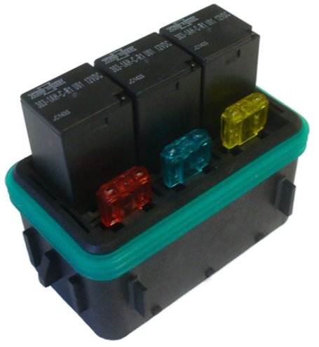

    HWB12 PDM from Littelfuse®
