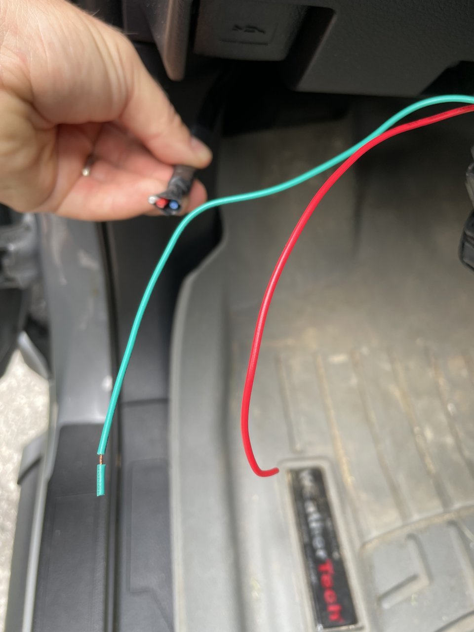

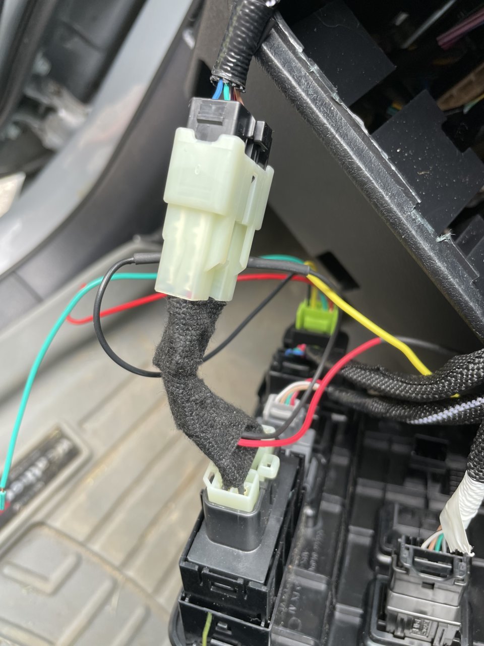

    1203A458-A9A4-4C41-A67D-0CD1531D5423.jpg C0577C09-35B1-4D4A-A261-7B1DA9FB00EE.jpg CD297552-2842-4F05-AB8C-E7478E93B9D9.jpg So I’ve been waiting for my revtek light bar for 4 months now and it’s finally being shipped. The lights are not currently installed but my switch is in place.
    here are some pictures of what I have.
    The harness wire I did clip off the hella rocker switch.

    @Puppypunter gave you bare wire? Geez Johnny :p
    here is the dual switch cargo trigger I have for @Zumozuzu7 (we do full service here in California)

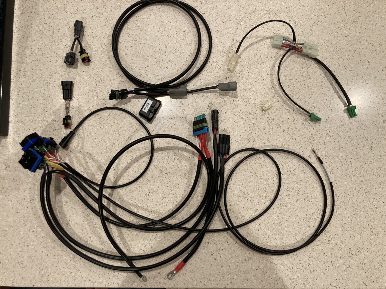

    So @Steveko , if you have a DRL light bar and DRL LED pods then your setup is an exact match with @Zumozuzu7 and I can just duplicate his pending confirmation on light bar connector. It was a bit painful to build all that stuff and it means mounting 4 full size relays.
    Scroll back a page or two for photos or I’ll take more tonight.
    Here is the latest from my phone. Waiting on relays at this point.

    Ha no bare wiring! That’s the oem style switch and the hella harness. I haven’t connected them as I haven’t installed the lights. 4 month wait for my light bar. I should clarify this is for the hella pods not an actual bar. Light mounting bar is more like it.
    the hella harness has a pair of relays on it already.

    So my stuff would be a replacement for the whole thing. Because wiring nerds look at unsealed relays and puke. It’s an uncontrollable reaction.
    If you prefer some DIY route, you can buy an r4t DRL grille light harness and pull from that output to your DRL relay coils. Or I suppose I could sell the same thing but I prefer to not build stuff which is easy to buy.

    Looks like maybe just switch illumination via cargo T? But black and red vs light green and tan doesn’t seem like the real Johnny. More like something @kmorgan3 might have had built?

    Yeah that looks like a stripped down version of my cargo light T. I’ve sold quite a few with just bare leads for people to experiment on their own.

    Kool. So, if this were me calling the shots, I’d resell that T, throw the harnesses in a drawer, and pay myself to do it all custom like I have for @Zumozuzu7 and live a happy life.
